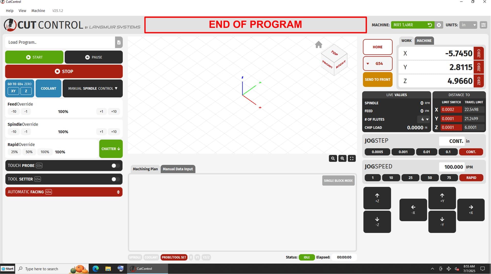

Part complete could be as simple as square that changes form program running red, yellow, or orange to program complete green. I don’t need a pop-up to tell me that the part is finished and demands my acknowledgment before I’m allowed to do anything else. To be honest this one pop-up is the thing I dislike the most about the entire machine. If we could only pick one to eliminate my vote is 100% for the part complete pop up to go away. I’m begging… lol If we need to start a fund raiser to send Zach some cash under the table for this I will contribute!
+1 for the popups. Understanding your target buyers, but there is some personal responsibility that goes with buying this machine, and nobody needs their hand held like this.
At the very least, add a “do not show again” checkbox. Nobody needs the popups forever.
I’m so glad I waited to read feedback about this release, while I’m also anticipating the bug fixes that cost me a ton of time.
There is more than enough room in the grey section toward the top of the program to place warnings (flashing or scrolling) and have them disappear on any screen touch.
I like that idea a lot. Still getting machine feedback, without needing interaction.
I totally agree it should be a program status notification and not a you must hit this button to acknowledge this pointless notification before you can do anything else on the machine.

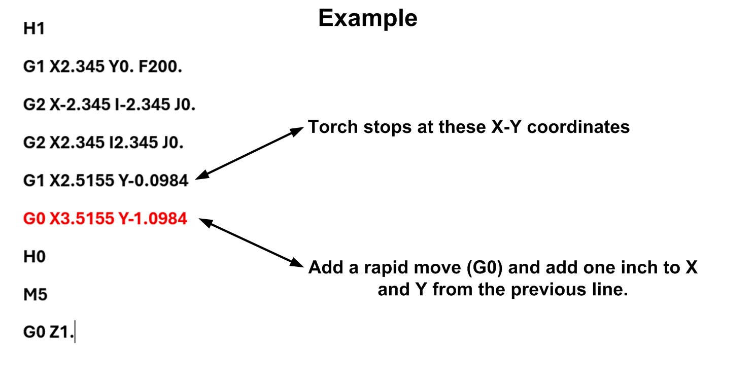

Just felt like I needed to throw in here, too, that those pop-ups are very frustrating at the end of a job.
Often times I need to go in and jog the torch away from the end cut so water doesn’t get thrown everywhere.
But, I can’t do that unless I click OK first. By then, I’ve got water all over the place.
(Yes, I will need to figure out the G-code to add at the end of the script to move the torch away, or maybe a setting in SheetCam that does that? Idk yet. Haven’t had much time to look into it.)
But, I have to agree… Too many pop-ups.

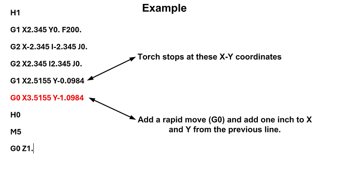

I do this…near the end of the program look for the end of the X-Y G movements, G1, G2, G3 etc. Insert a line below the last X-Y G move and add a G0 (rapid) command with one inch added to the X and Y coordinates. It will move the torch one inch in X and Y. You may have to change the + and - in X and Y, depending on where you want the torch to park, obviously not over open water.

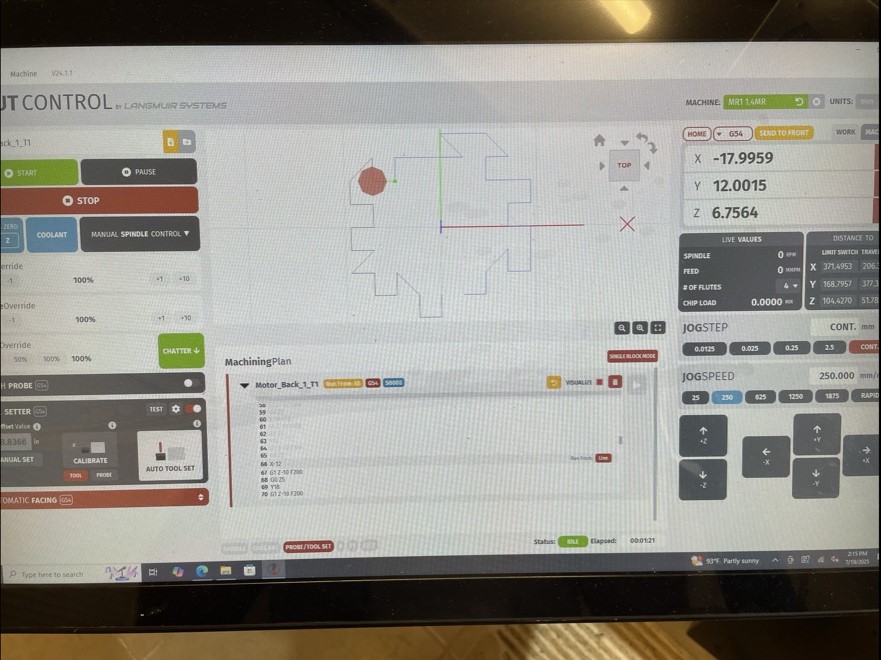

I’m still using 24.1.1 from the website and I’m not sure if this has been addressed.
I ran into an issue with the “Run from” function. I wanted to skip a hole in a drill program I had and the machine would travel to a point within a couple microns of the correct XY position but never start the program because it would say it couldn’t reach the point. In the screen shot below, it was trying to move to X-18 and Y12 but would move to X-17.9959 and Y12.0015 and then never start the truncated program. Not sure if this error is because I was working in metric or if there is some tolerance range needed to make the “Run from” functionality work better. Seems like it was over thinking the resolution on the machine position preventing it from starting.
I just ended up mainly editing the G code to skip the holes, but would have been much better to have the run from functionality in this case.
