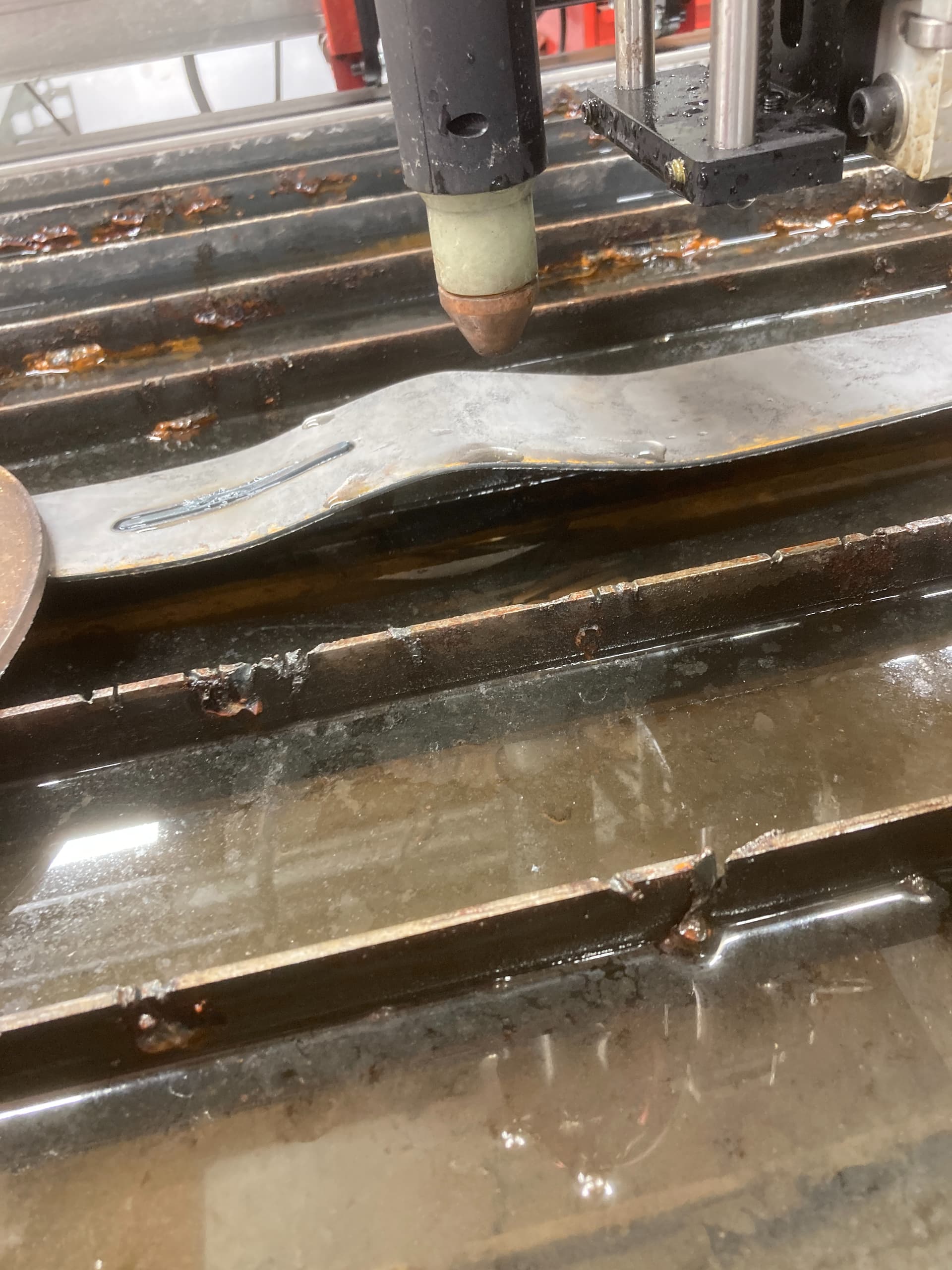

I purposely bent up a scrap piece to simulate a warped work piece, and the first result was not stellar.
Here is the before pic of the set up (with my man-made warpage)
Then my first cut…Not impressed.
Second cut was even worse.

With that much bend in material you would probably want to change the settings in the THC. Increase the speed the z axis will compensate. I did that cutting pieces out of roofing tin. I had to slow it back down later because I noticed bobbing in the corners of my mechanical parts.

Phillip, if I were actually cutting a piece that badly warped I would change some settings, but this was simply a test to see if the THC actually followed the curve.
It worked pretty good the 3rd time, so now that I see it works, I am good.

I got you I was just getting at the fact a good chance the first cut wasn’t that great the bend was to much for the z axis speed.
As Phillip said, some changes in the THC menu will help it react quicker but your extreme “warping” test is going to be a challenge.
Another setting that would increase reaction by THC is to decrease the sample size:
If you have an idea what is a good voltage for cutting that thickness of steel, since you are in the “testing mode”, enter it in the Nominal Voltage section. Decrease sample size to “10”, Increase Z speed to 25% and see if that improves.

As far as testing the height: Are you testing on a flat piece of steel or on this bent steel? It needs to be a flat piece of steel because that warped piece is introducing lots of variation of springback.
It is??? It didn’t look extreme to me. You’ll get those kinds of curves with thermal warping on skinny pieces. :thinking:
Not saying it won’t happen. Just saying that it is going to be a challenge.
