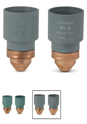

@Marino87 the 45 amp consumables on hypertherm sync are optimized for 1/8th to quarter inch material. For materials 10 gauge and less you’re going to want to use the fine cut consumables.
The 45 amp consumables will work on 14 gauge but it’s not it’s optimal cutting range.
Hypertherm cartridge: SmartSYNC/adapter 45A mechanized cutting #428925 Hypertherm cartridge: SmartSYNC/adapter 45A mechanized cutting #428925

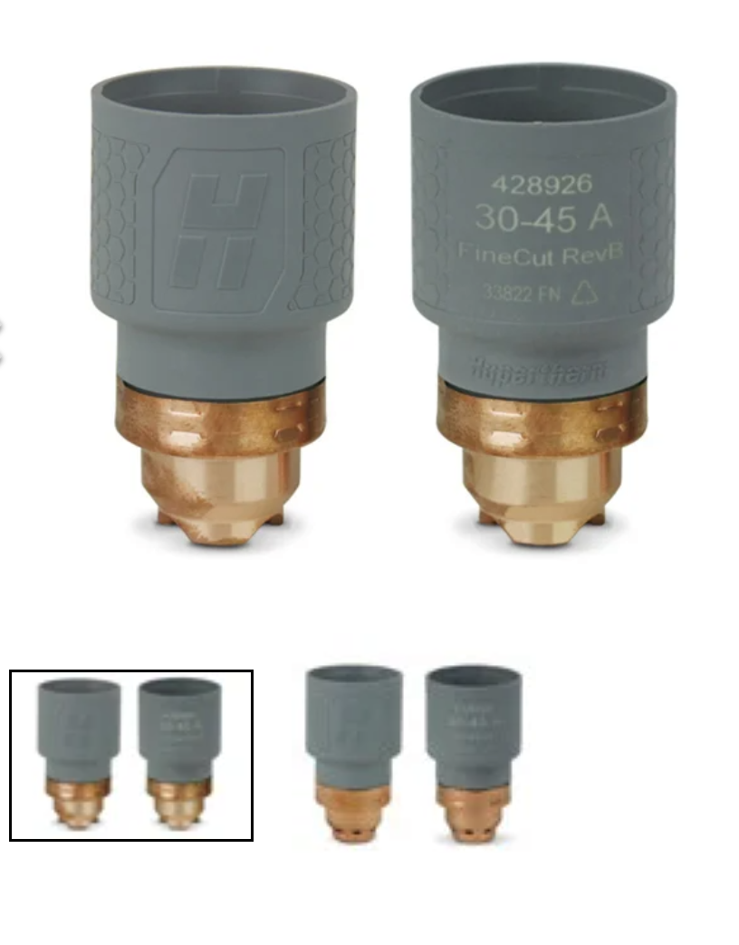

Hypertherm cartridge: SmartSYNC 30-45 A mechanized FineCut #428926 Hypertherm cartridge: SmartSYNC 30-45 A mechanized FineCut #428926
And again triple check that they are the consumables that are gray in colour.
"30-45 A mechanized FineCut
Part number: #428926
FineCut® cartridges produce a narrower kerf on thin mild steel and stainless steel up to 3 mm (10 gauge) which is ideal for fine detail cutting. To maximize cartridge life and performance it is important to select the cartridge that is optimized for the workpiece you are cutting"
