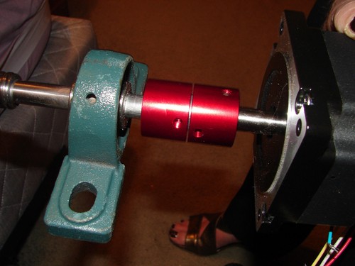

@MattD asked some questions regarding the lead screws used on my table.
The lead screws I found for my table were 1/2-10 5 start lead screws on ebay. See below. The original ones are 3/8-8 4 start I believe. In order to get the same travel distance per revolution you need to find a screw with a .5" inch per rev. To find the ipr you take the start (4) and divide by pitch (8) to give .5" ipr. Or with the bigger 1/2" lead screws 5 start/10 pitch=.5" ipr
https://www.ebay.com/itm/132450480303
You will also need these nuts. They fit the OG Crossfire with no mods to the brackets.
https://www.ebay.com/itm/142638623979
Also bought these couplers for the stepper motor to the new lead screw.
https://www.ebay.com/itm/273961856544
I ended up making my own coupler for the connection from lead screw to bearing block. Also shown in a previous post above.
If I had to do it again. I would just buy more couplers from ebay but 1/2" to 1/2" and turn down one end of a piece of 1/2" material (probably CR 1018 1/2") to just under 8 mm, .315" (the ID of the bearing), drill a hole and send in a 10-32 tap. I think that would be a lot easier then making your own couplings.
Or buy 8mm CR1018 and turn down one side to 1/4" and use the same couplings as the motor.
Or just use the original couplings and turn down the ends of the 1/2 lead screw to 3/8.
There is about 10 different ways to attach it.
@MattD you can use any lead screw or ball screw you want. You would just have to change your motor steps per settings in mach 3 to match your new setup. But a 1/2-10 5 start lead screw would be your easiest with no changes to mach 3.
