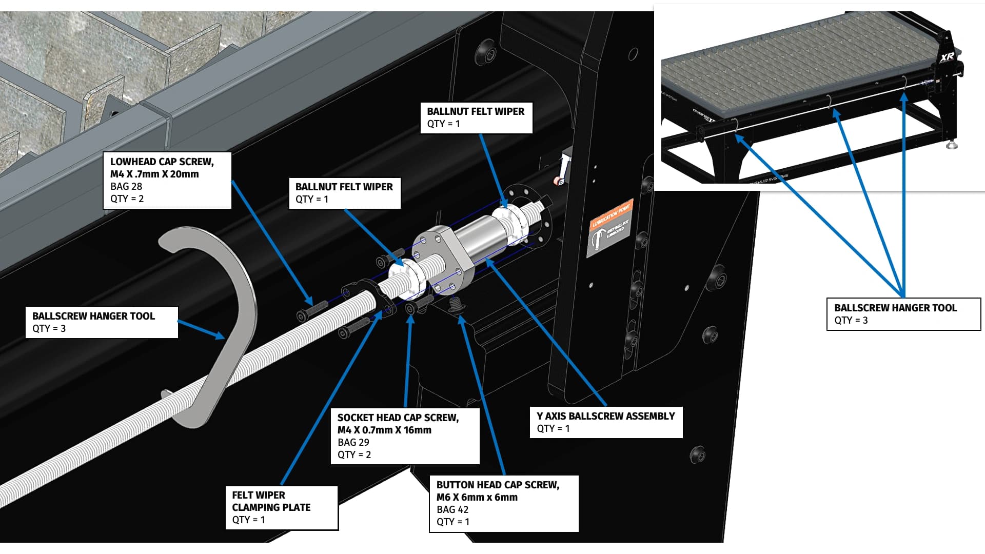

Fill ball nuts with oil,They have a removable plug to shoot oil into.
what kind of oil should I use?
I use Lukus engine treatment oil; it is thick like honey doesn’t make a mess like grease would. cut the nozzle close to end so it will fit where oil plug hole is on ball nuts and squeeze bottle until oil starts to come out around felt wiper.
I would check these components to figure out where that sound is coming from.
