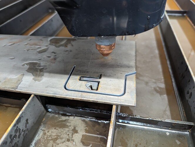

Recently completed assembly of my Crossfire XR and began attempting to test it today. Running into an error a couple inches/ seconds into each cut I attempt. The torch will go out and FireControl will throw an error saing the “Cutting Voltage Lost During Cut.” Now I have been reading through as many other posts and videos but nothing seems to be helping. I’ve preformed a full THC Control test, I can post the results, but everything is in the green. It stops in almost the same place everytime on several different cuts, both with and without THC on. Where should I look next?

Unfortunately I cannot add attachements yet being a new user on here. I could try to upload an image on the G-Code though?? In that image the head had already been moved but it initially stopped right where the cut ends. This was just a test square, and was cutting around an H letter decal, both of which failed about about the same distance. As for air, I have an IR T30 running into a 3 stage fliter/seperator/desicant dryer, and finally into the water seperator attached to the Powermax 65 SYNC.
Also the cut began on the right side and ran into the piece from the edge, not running off the piece, sorry for not clarifying.

I have done a 5" straight cut across the piece no problem. Let me try a longer cut now and see what happens. The regulator is set to 85PSI into the plasma cutter with no drops while cutting. I am fairly new to CAM/CAD but getting familiar with Fusion360. I have tried 3 different pats and all have failed roughly the same distance in which has been confusing me. This cut is just a 2" square, and everything looks right in 360.
Preforming the 10" straight cut twice, once with IHS and once without. Both started fine and cut about 6" before throwing the Voltage Lost error.

The issue persists. Checked torch height and seems consistent start to end. Changed grounding location and still no luck. It is super consistent with cut time before throwing the error. If I change cut speeds it will cut the same amount of time but a shorter distance. If I run a straight cut without IHS the program will finish without throwing the error but the cut will still end in the same spot/distance. Air supply is still consistent. THC control test is still coming back perfect. I cant understand this.

Yeah so just a rookie mistake unfortunately. The issue was regarding the air system and I mistook the cutting PSI for the neccesary PSI to the 65SYNC. I was only running about 75-80 PSI to the machine when I needed at least 90PSI for it to run properly. Once I turned the regulator up it’s been running like a charm. I appreicate all the input though. Now im just wokring on getting my parameters tuned. Thanks.
