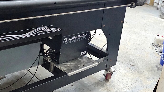

Crossfire XR update
Well finally got some time to mount plasma cutter to wall and move the XR controller to underside of table. Had to cut and splice six feet of wire on THC and torch fire cables. Moved the controller under table so it is more protected from getting hit or snagged when walking past side of the table, put a piece of rubber matt on top of controller in case water table ever sprung a leak. Cut a couple of shock tabs out of .250 steel to make sure THC cable still functions. THC works as it should, cut height at .060 still.
