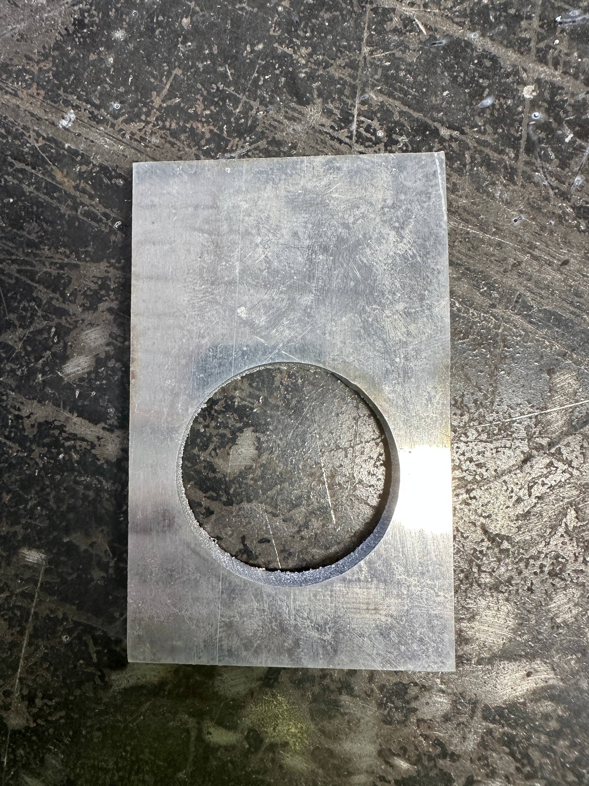

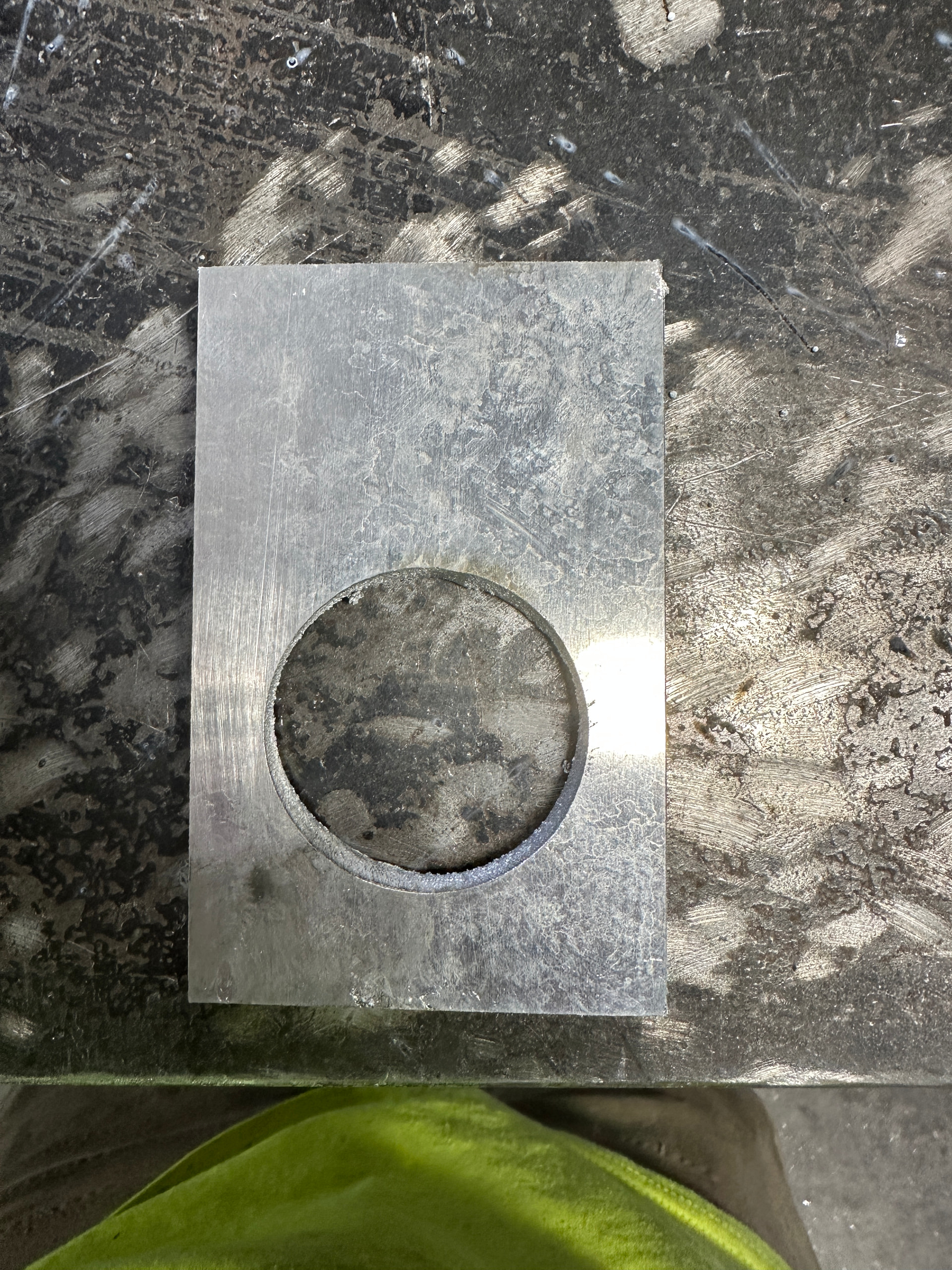

Crossfire XR not cutting straight through holes
Hey guys! I’m having a bit of trouble cutting straight holes on my Crossfire XR.
The material I’m running is 1/4” aluminum with some 2” holes.
I’m using the Hypertherm 65 SYNC at the recommended settings for the “best cut” according to the chart. I’m not quite sure why it’s cutting like that. I’ve made sure the torch is square to the work in every direction known to man.
I’m really lost on what to do now and would appreciate any help. Thanks

Is your bevel uniform all the way around a square when you cut a square out?

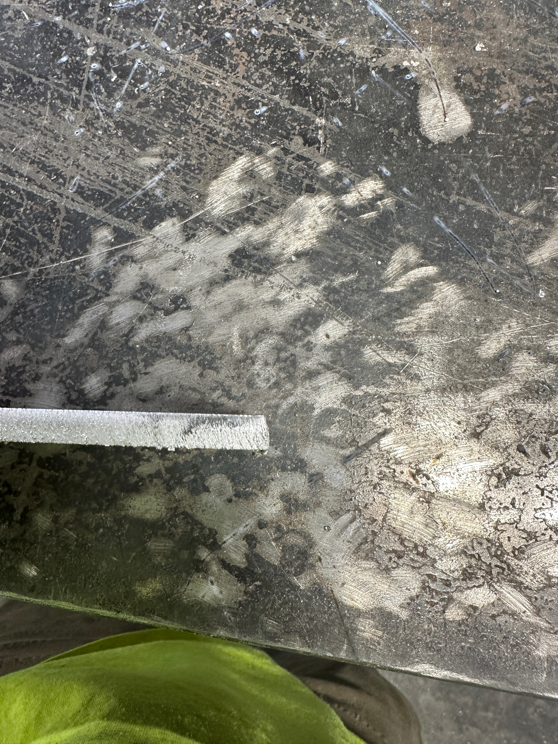

Yeah, it’s always beveled out toward the edge on the top and bottom but on the sides it’s straight.
So three out of four sides are good? I would rotate your torch 90° in the holder , try cutting a square again and see if the bevel follows it Feels like we’re getting into alignment territory

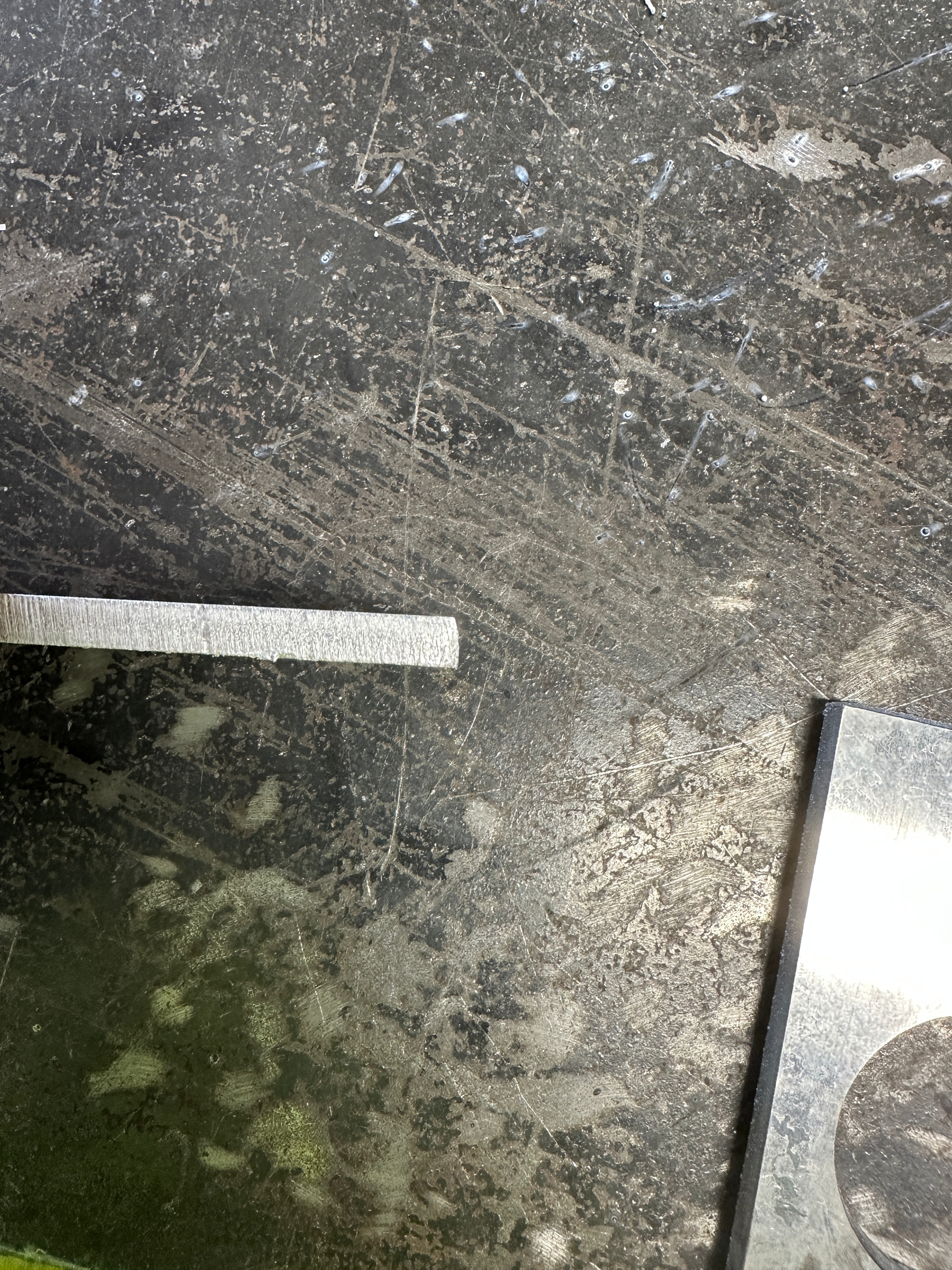

2/4 sides are straight. The picture of the edge is how 2/4 edges are.
I would rotate the torch and try again this feels like a torch alignment issue
