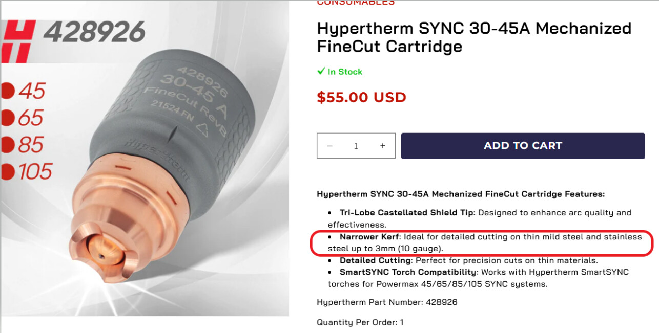

Is your machine a SYNC machine? Because you are way off with your cut height as well. It is way too high if you don’t have a SYNC machine.
These two numbers are creating a cut height of 0.165 inches!!!
You should be closer to 0.06 inches.
And if you are using the Hypertherm 85 SYNC machine with Fine-cut, it is only recommended up to 10 gauge. The fine-cut on the Hypertherm Non-SYNC using non-sync fine-cut consumables have been known to do okay with up to 3/16" metal.
Sync cut height is IIRC .12"
I know. He is using the sync cut chart but did not say it was a sync machine. The SYNC fine-cut specifically says that it is ideal for thin metal. I suspect he has a SYNC machine.
It is a powermax85 SYNC machine. The cut height is set the height in the chart that came with the machine. I can adjust the springback and backlash if needed.
