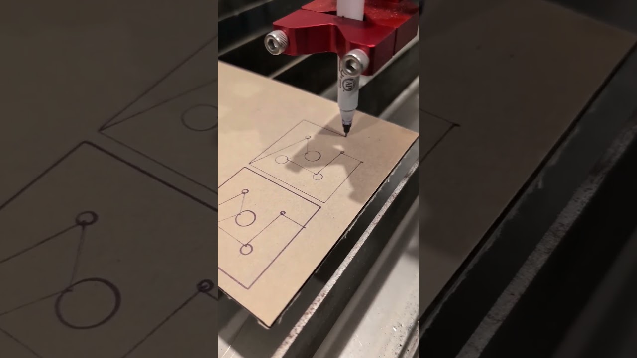

Just wanted to show this off…you can swap the torch with a sharpie without having to mod or change anything. You just need to flip the torch clamp around!
This was quite helpful for me while I was troubleshooting hole/cut quality. Doing this was a useful way to double check that all the leadscrew nuts and couplers were working as intended and the gantry was moving properly.
Hope this helps someone else!
nice motion check.
