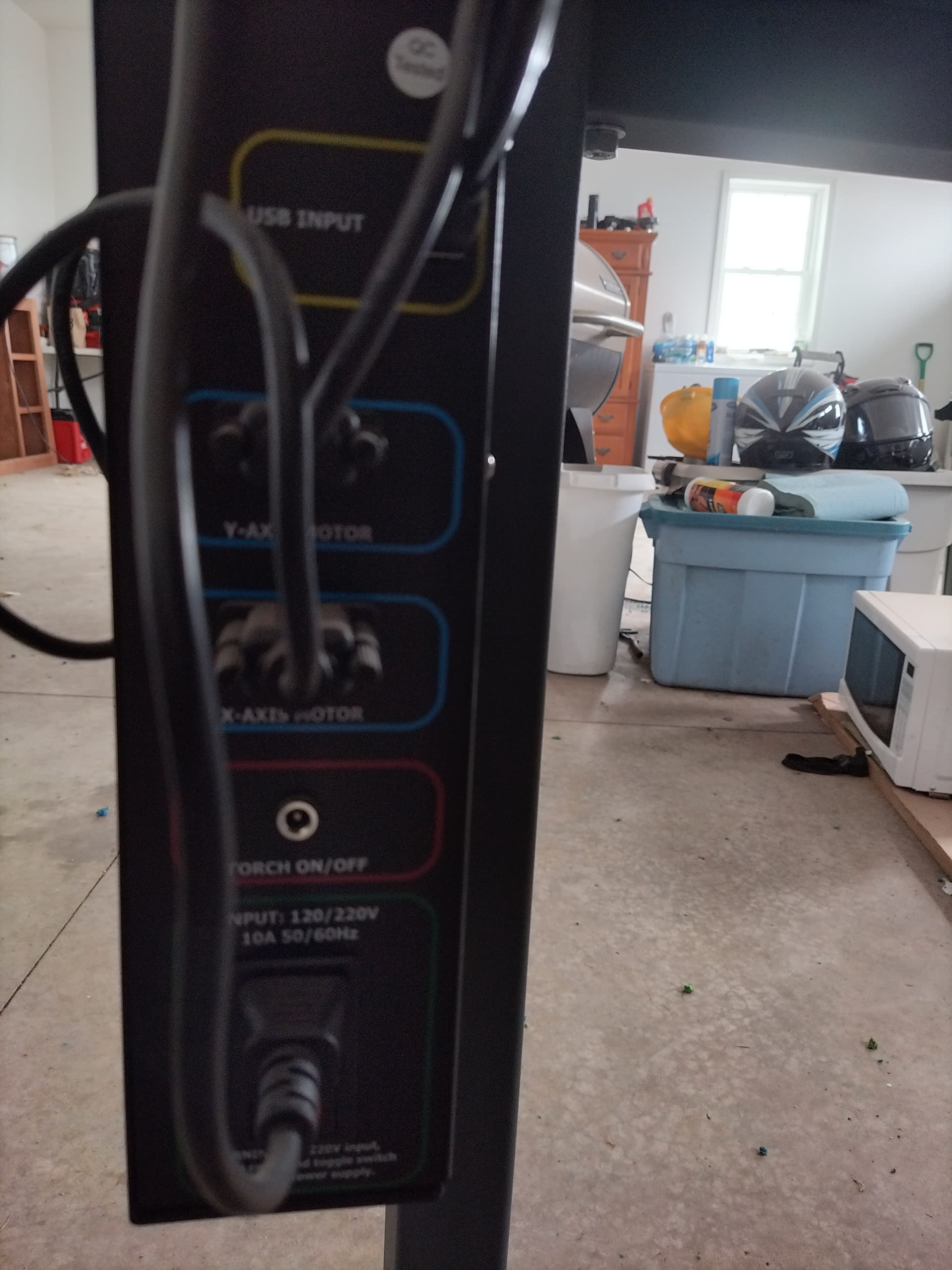

Ok long story short I purchased the cross fire a couple years ago and due to work I didn’t have time to get to it. I also put the XL kit on it. So now I’m looking for information on computer requirements and then the suggested software . Thanks Cory

so most likely you are still going to use MACH3…can you post a picture of the back of the electronics closure please…where everything plugs in…it will confirm which software to use…

yes…that is the OG machine…it runs on MACH3
so just about any computer will run MACH3…but you will need to purchase the program.
