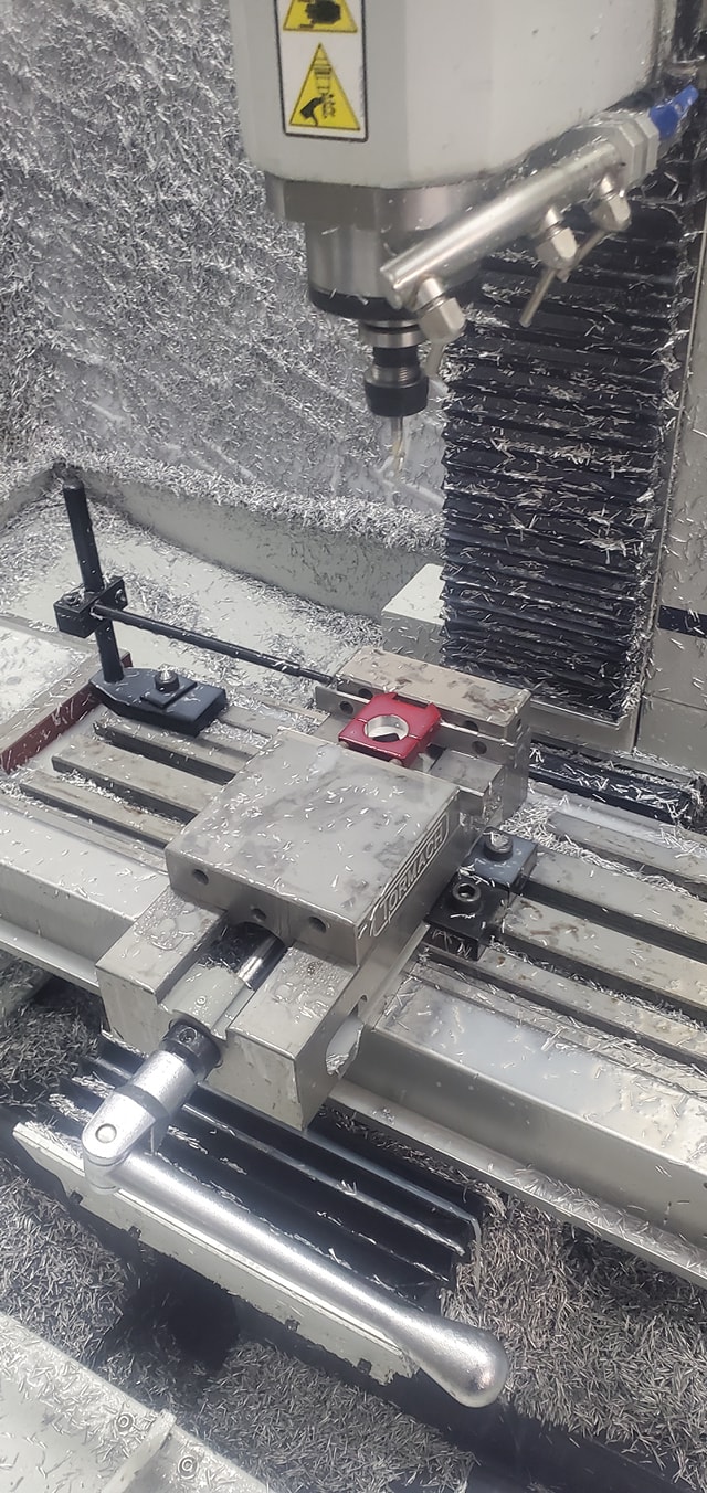

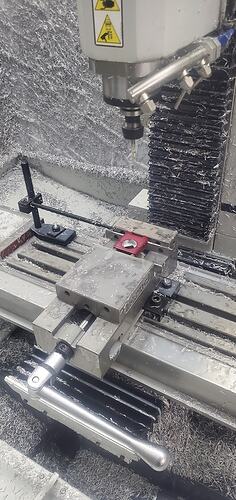

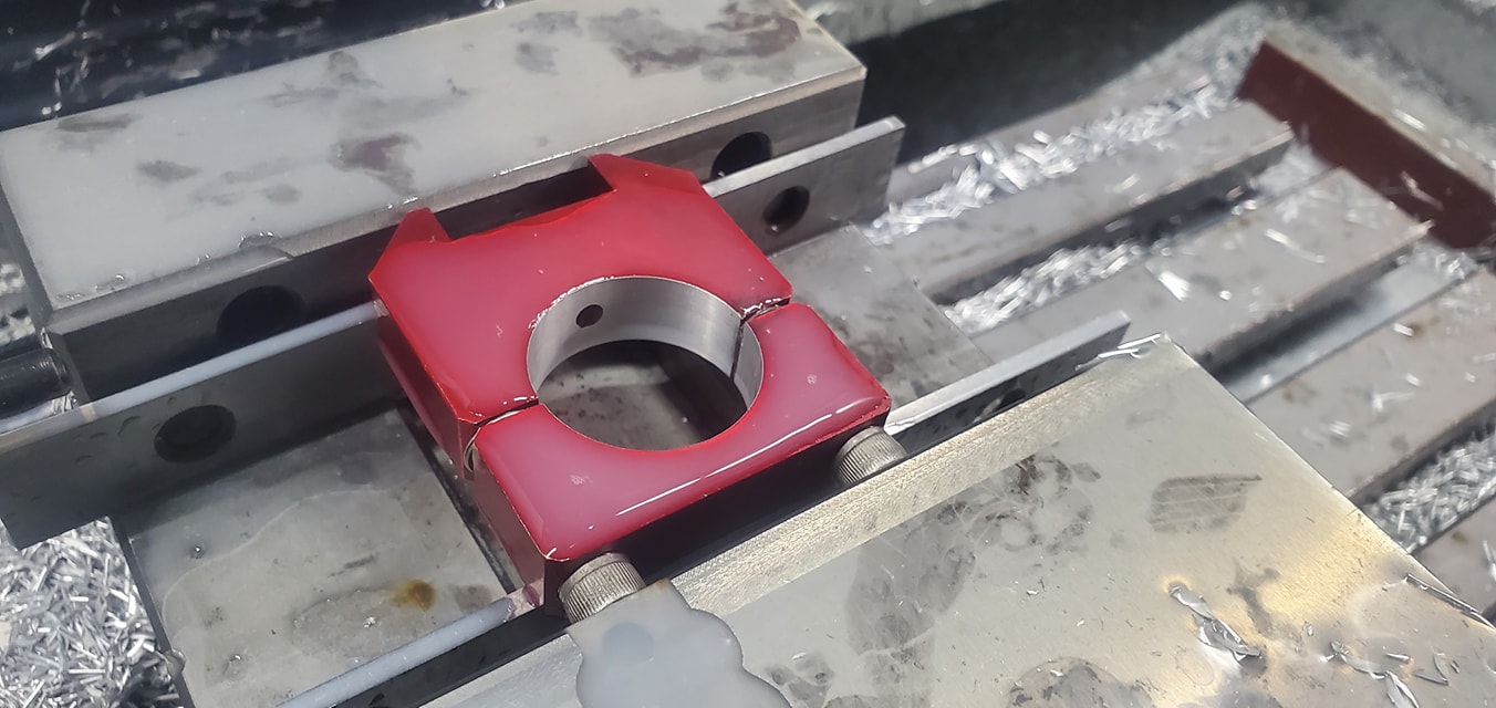

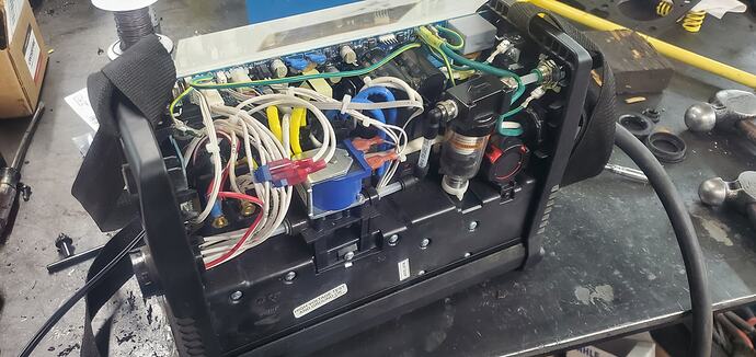

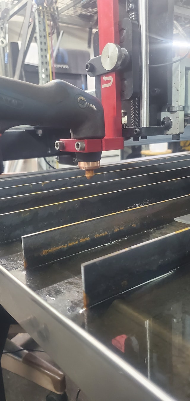

Thanks to most of this forum, I followed various posts on how to make this setup work. I have a CNC mill here in my shop and modified the original holder to better clamp. If anyone needs a holder made, let me know. I can make you one if needed.

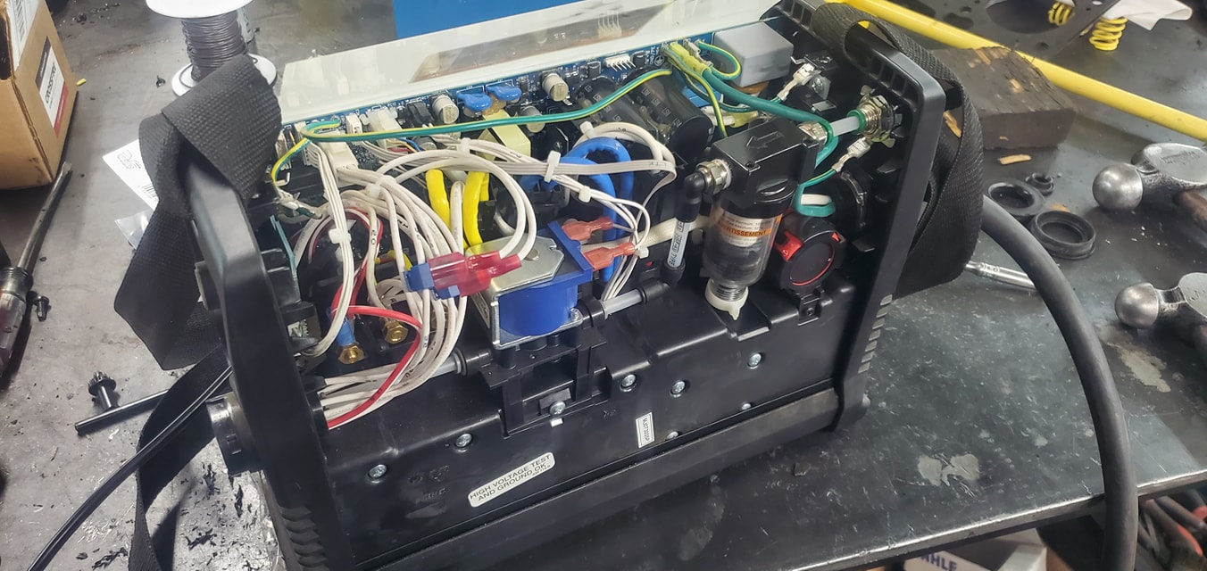

For anyone interested, I did the THC. The black wire went to the red Torch lead main hub and the red went to the white wire main hub that goes to the clamp lead.
Forum wont let me post multiple photos in one post so please forgive multiple replies
I used 2 thin washers on each bolt to leave room for clamping

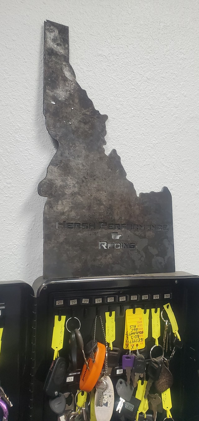

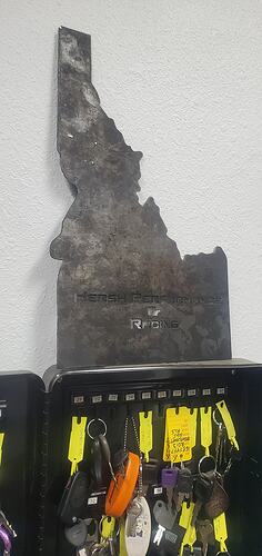

Final result
Ignore the chop in upper left. I forgot to select option to keep corners sharp

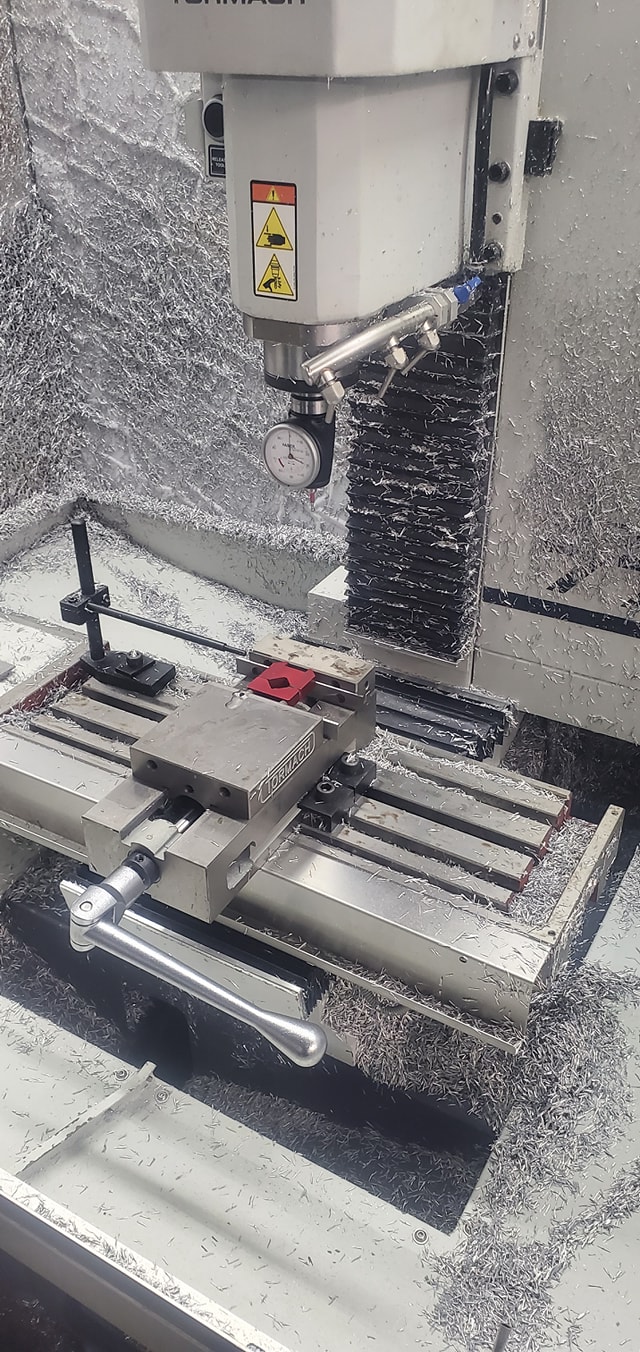

what kind of mill do you have?
I tried but said I was too new to post multiple medias in same post right now.
I have a Tormach 770m. I’m very happy with it so far
Hey Hersh. I am in the process of getting my table set up with my miller 625. I was disappointed at the least to find that the torch holder does not work will with the xt40. I am interested in your modified one. Can I send you mine to get modified? Thanks, Ryan
Yes, you can. Ill send you a PM and we can hash out the details there
