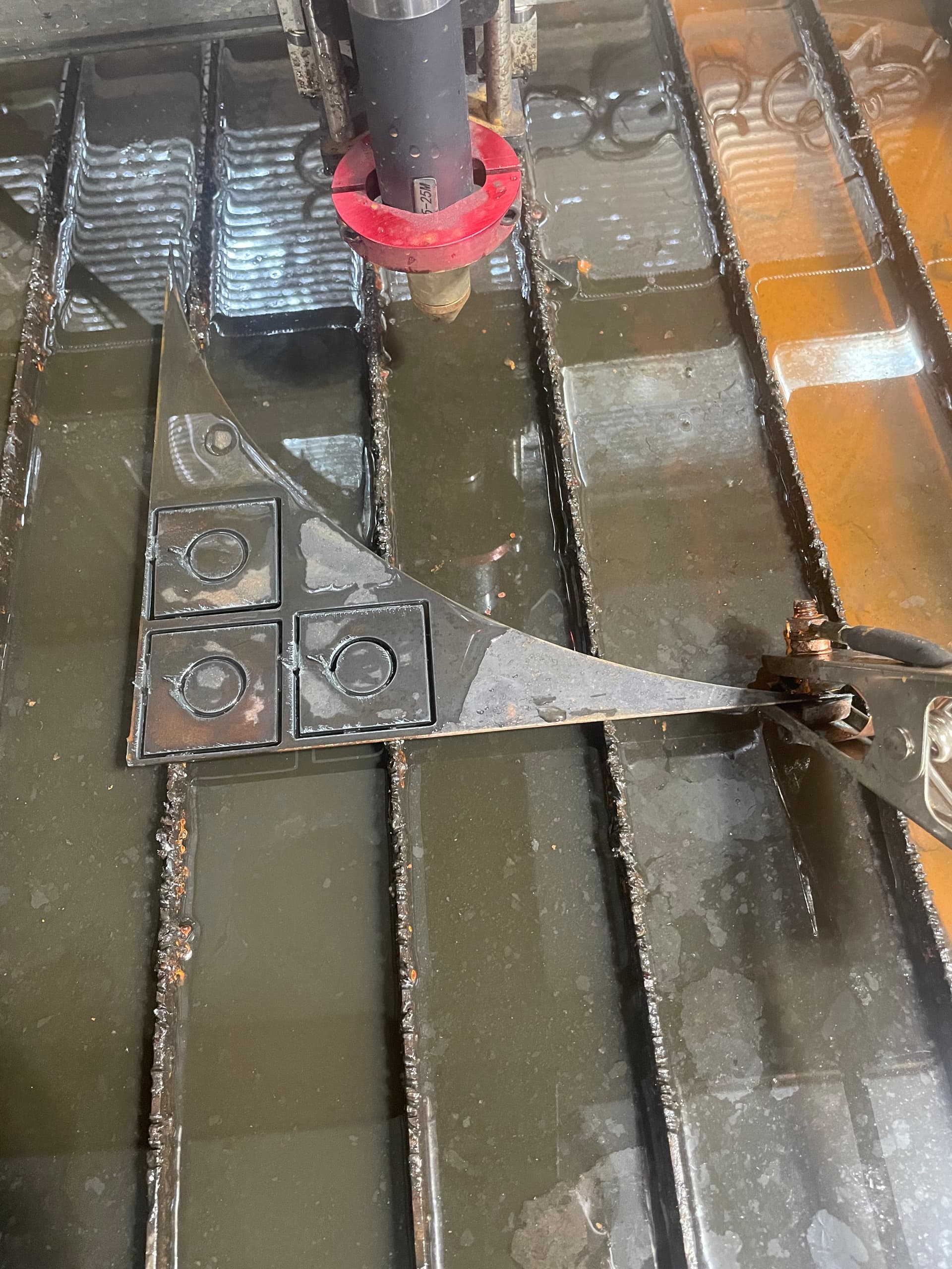

Hello, I am decently new to CNC plasma cutting and I have ran into an issue that does not happen all the time but has shown up in the majority of pieces I have cut. I have attached some photos of the incomplete cuts that are happening and I have tried my best to find solutions.
Here are the settings and possible solutions I have tried already (all measurements are in inches):
I have a razerweld cut 45 plugged into 220v and set at ~38amps and 90ipm for 16ga mild steel and new consumables (this seems to have the cleanest cuts for me) with 80psi of dry air going in and the readout on the plasma cutter saying 75 without cutting and dipping around 62psi when actually cutting (60 gallon air compressor too)
Using fusion 360 my cut height is 0.063, pierce height is 0.15 & pierce delay is 1.2sec
I run into no errors when generating the Gcode and the only part that does not fully cut is the first 0.5" of my cut path
I have made sure that my THC voltage is properly set at 112v nominal and that is .063" measured with calipers as it was cutting (I have also turned off THC all together and there is no noticeable difference)
My ground clamp is properly attached to the work piece
I have tried all the solutions I can think of and still I cannot find a solution. The only possible solution I can think of would be to set the finishing overlap to 0.5" in order to have it finish the cut but that sometimes leads to errors when generating the Gcode and I would like to avoid needing to do that if possible. Is it common to have a finishing overlap like this?
The ideal solution seems to me would be a setting that slowly increases the feed rate in the beginning in order to give the machine time to fully cut the first .5" but I have yet to find that setting.
Any input would be great and highly apricated, thank you for reading.
Post the cut file you are using. The delay that you posted is excessively long and should easily pierce the metal before moving.
There may be something that stands out in the code.
You need 70 PSI while cutting

I have a RW45 and always leave it at 45 and adjust IPM accordingly . 90IPM seems pretty slow for 16 ga even at 38 amps. I cut 14ga at 110IPM @45 amps
this should be .5-.6 for 16 gage

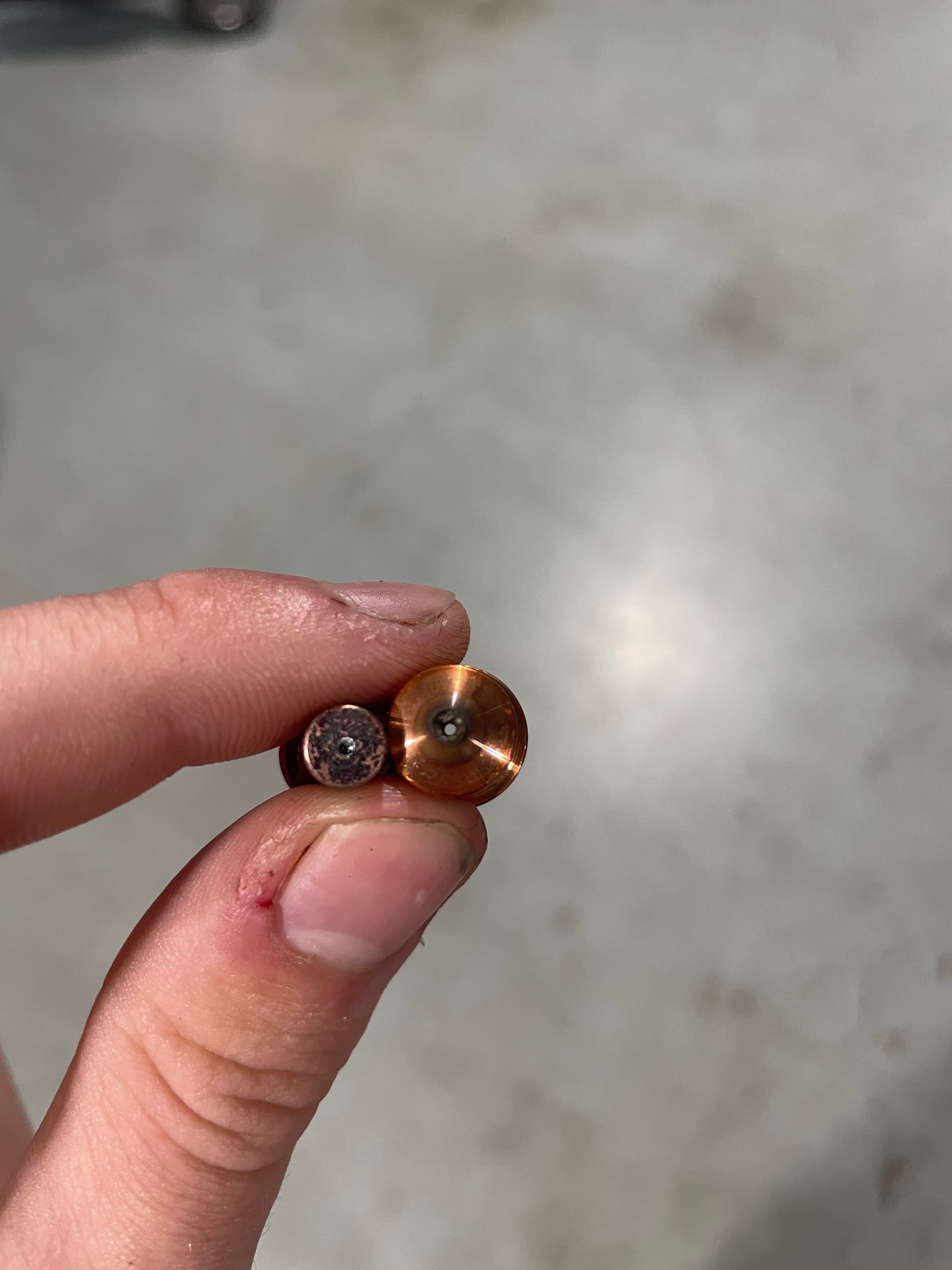

Not saying you don’t have dry air… What is your means of removing moisture? How much cutting is on these consumables? Can you post a picture of your nozzle and electrode? Where are you buying your consumables?
When I started before and good air dryer and using cheap consumables. I was making cut look just like those.

Here are the consumables I purchased and a photo of the ones currently inside the machine
(5Pcs 220669 Electrode & 5Pcs 220671 Nozzle)
https://www.amazon.com/gp/product/B08LQS9KQ9/ref=ppx_yo_dt_b_search_asin_title?ie=UTF8&th=1
Those are shot … I hate to say it​:grimacing::grimacing:. No offense look around there is several threads on air dryers. You need at least a bead cell dyer.

Yea with less than 20 minutes of cut time, and 200 pierces is that what they should look like?

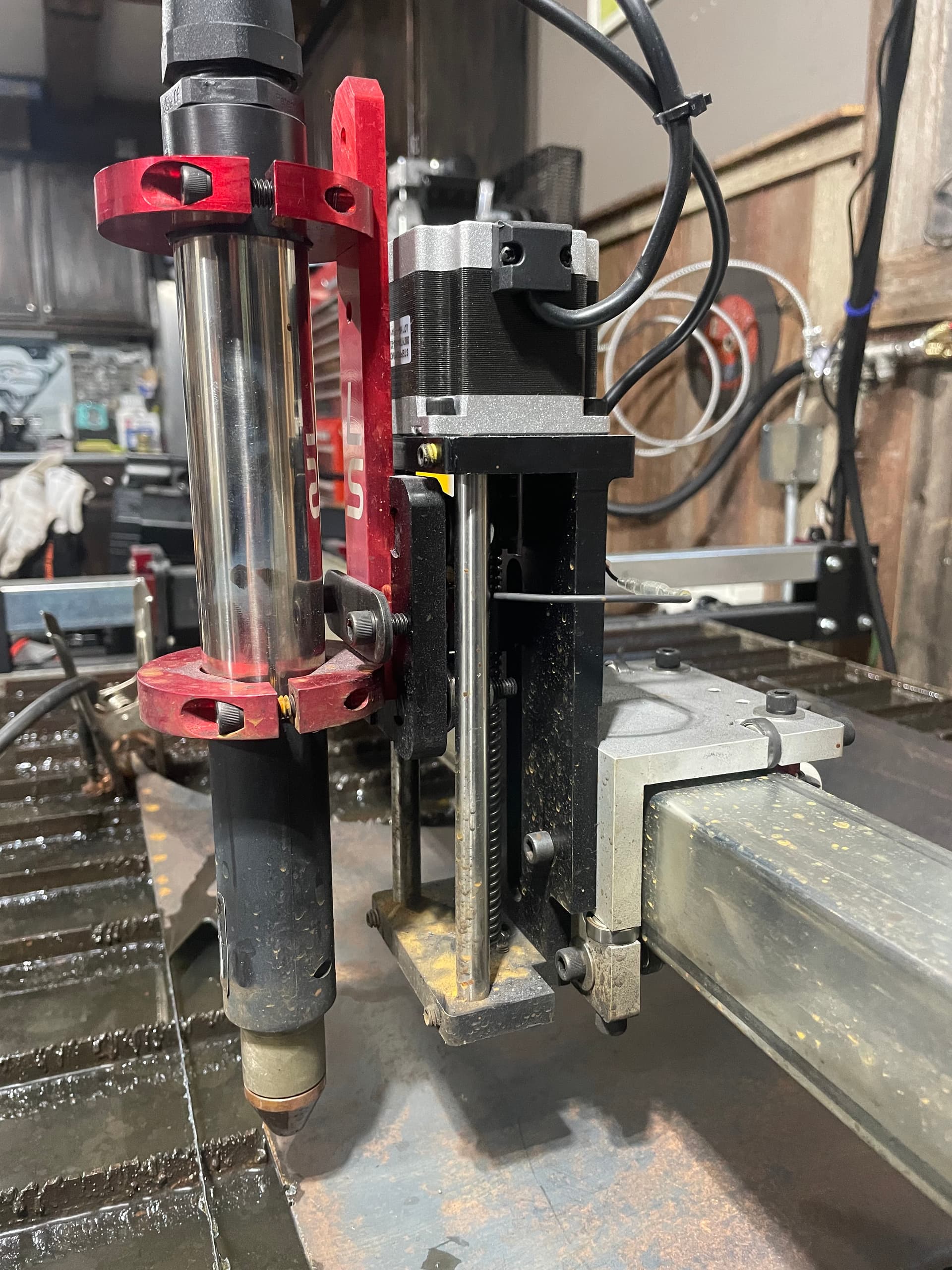

#1 You have your torch mounted incorrectly.

Looking at the picture, seems the problem is at the beginning of each cut, right? Also, the problem is almost identical on each piece so not intermittent. In addition to repositioning the torch in the clamp as suggested above, you may need to revisit your settings in CAM and see if there is a cause there.

For sure the torch needs moved. My opinion based on my experience is. The consumables are trash I seen the same cuts with mine.
So I got my table early in the year it cut fine as soon as it warmed up. Yup this is what I had. I could turn the amps up a little and it would help. It will pierce the metal because of the long delay then the consumables can’t cut through. Then the material heats up enough that it finally makes it through it… Just my two cents . He actually doesn’t have much at all to remove moisture.

when I said your consumables are trash. I meant that they was used beyond worth. I try my best not to knock on what people can afford but I do advocate some things are worth their money. It doesn’t matter what quality you buy excessive moisture will trash them fast.
