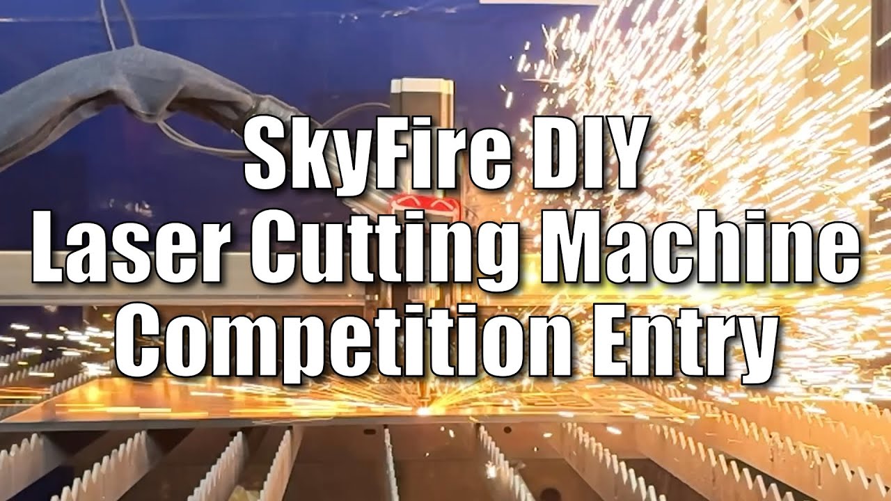

Crossfire Pro Laser Swap
All the swap details! Wish us luck in the SkyFire competition.

Is there somewhere that all the video entry’s reside?
I really never accounted for the differences in time and movement of machine.
I mean…
  • I understand about less part movement while cutting
  • I also get that the weight of the machine needs to be situated and high enough to not move itself
  • With all those factors, keeping cost down like with Langmuir Systems Crossfire is a trade off
It is really a nice build for cost versus weight. I did not know what exactly transpired during the cutting of the metals that would create the excess metal on the backside of the cuts.
Now, I know! It is almost like a reattachment of metal from lack of pressure pushing it away while heated.
