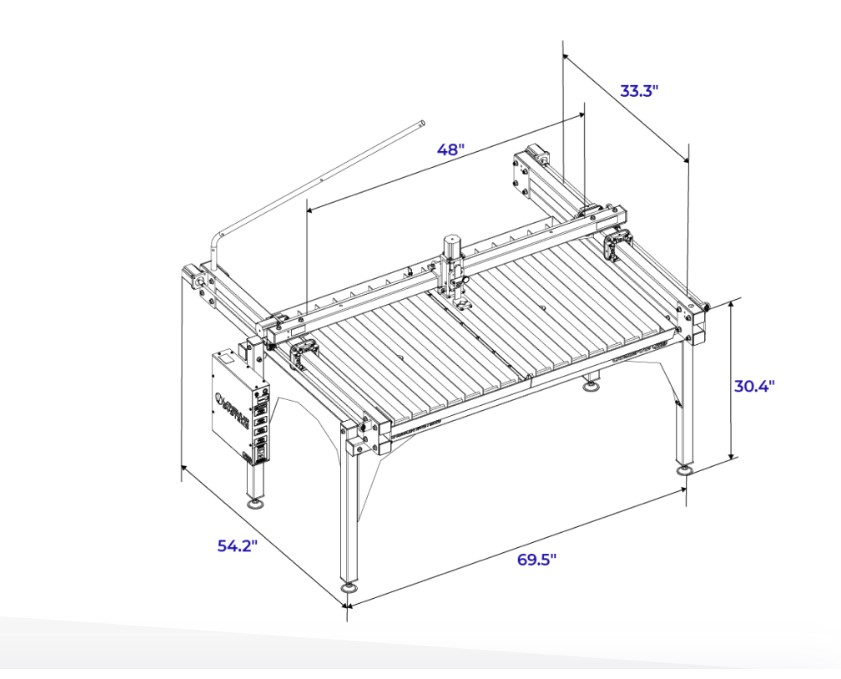

Im thinking about ordering a crossfire pro and was wondering what the height from the floor to the top of the riser that hangs the torch cable is i have a low ceing in my garage. Thanks in advance.

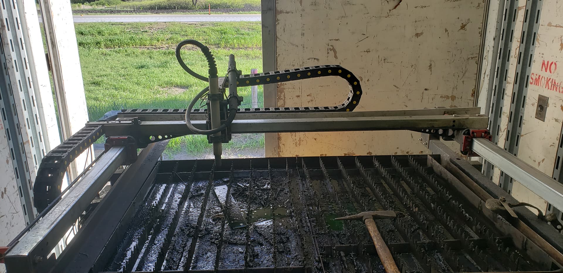

Others use drag chains. Definitely options available, don’t let the height restriction stop you!
Going off this graphic from the product page, I’d say 63.7" but I’ll see if I can’t get you an actual measurement at some point today.

From floor to the top of the tube hanging over the table it is 77.25" on my Pro.
The cable chain is a must in my opinion

From the floor to the top of the torch cable wand that comes with the table is about 81 inches. I say ā€˜about’ 81 inches because I have these on the bottom of the legs on my Pro table.
So Nelson is pretty close with original equipment.
Yes i guess that would be to the top of the pole. I appreciate the input. Thanks

Drag chains aren’t an option available from Langmuir but allot of guys add them. The pole works great for me.
I added cable chain (called a Drag Chain) to my 2x2, but for low voltage signals only. I use the pole to keep the Plasma cable away from the low voltage signals and it doesn’t flex the Plasma cable as much.
