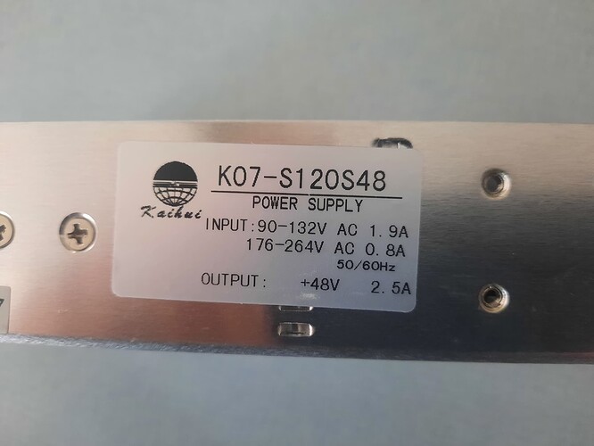

I have the small crossfire . I also have110 and 220 voltage available in garage. I am going to use the razorweld 45 plasma cutter that will use 220, the cnc table using 110. My question is the 110/220 switch in electronics box. It defaults to 110 but the instructions mention switching it if 220 is available in your area. What to I set it to.

Need to check the controller’s power supply rating label.
Most of these closed-frame power supplies will run from ~90 to ~260VAC. Here’s an example from my power supply box.
The 220 switch is for countries where the mains voltage is 220 for all outlets. In the US you should run it on whatever voltage you have available, which is usually 110v. As long as the switch position matches the voltage you are supplying, it doesn’t matter which you use.
The power to the plasma cutter is not related in any way to the voltage switch on the electronics enclosure.
