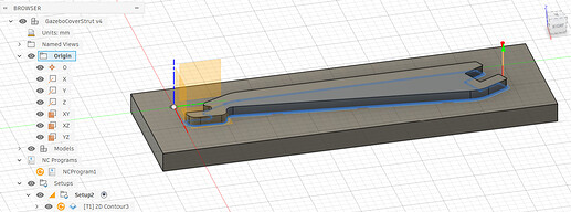

Question 1: I’m not certain how to determine where to place the xyz origin of a part in F360 or how much it really matters. It’s not clear what is the relation between the xyz coordinates of F360 and the xyz coordinates of the MR-1. Isn’t the F360 origin just relative to the CAD drawing and the MR-1 origin is the one that matters for the cut?

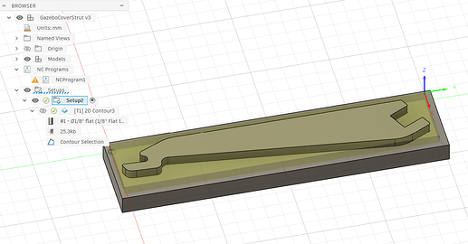

Question 2: I drew the spoil board as sitting below the x/y plane, i.e., at a negative z position. Again, I’m confused relative to the relationship between F360 and the MR-1. Here is a pic of the arrangement of the stock and spoil board.
Question 3: Since I’m using a spoil board, does it make sense to select it as a fixture in the CAM setup? I don’t need the MR-1 to avoid it. In fact, I expect the tool to cut into it slightly. How do I tell F360 this? Should I select it as the fixture but set the radial and axial clearances to zero?

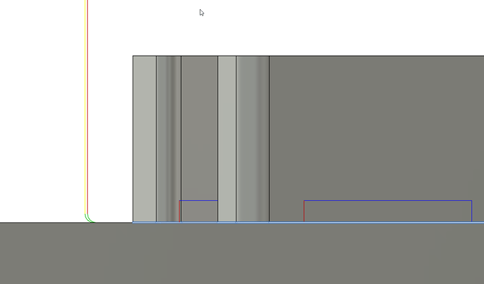

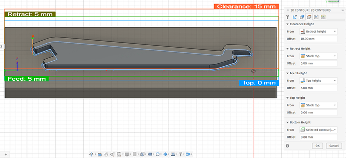

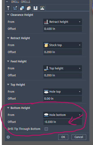

Question 4: How do I make sure that the tool cuts all the way through the part? I think I want the tool to cut about 1mm into the spoil board to account for any variance in the thickness of the stock and the spoil board. Here is the animation as well as pics of the heights and a close up of the start and end of the tool path… which seems not to cut below the bottom of the stock.

There are two origins that matter one in the CAD and one for the CAM the latter matters for your MR-1…The one is the part origin which is what you have pictured. It matters only for CAD work.
The CAM zero is set while creating your “setup” ← you create a setup that your tool paths will be referenced to. It takes care of the zero, your stock size, and brings your part into the picture (mostly important for 3d tool paths).
So this is the zero that you defined in your setup and all tool paths within that setup will reference that zero. When you are at you MR-1 you need to set you g54 zeros to that location on you stock that is pictured (or at least that what it looks like in the pic). That is how the mr-1 knows where your tool paths are.
No it does need to be defined and in fact you don’t want it defined because your cad similation will show collisions (it still will collide btw as it only flags a fixture as a potential problem - it will not avoid it.).
Two trhings, since the stock has some Z varience, I would set my z zero to the spoiler board (you will need to do that in your setup also by selecting the bottom corner of the stock versus the top). That way you are cut to the exact depth you desire vs. taking a guess on the variance in the top. Next to make you cut all the way through, you will go to the heights tab and on the bottom height set the bottom height similar to this
In the above example I DIDN’T want the bit to come out the bottom of the part and added a positive offset tot he bottom height and the similation shows it perfectly.

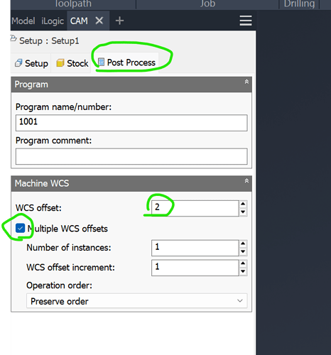

For sure. I’m running dual offsets on a program right now. I have two parts in a 6” vise. Since two parts fit but they can not both use the same stop (zero) I simply use G54 and G55. This way each offset is independently adjustable.

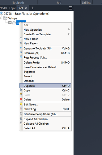

How to generate the program… So this might be more complex than I can explain with text but I’ll try. Right click on your “setup” and hit duplicate.
Then edit your new duplicated setup. If your first origin was back, top, left on your G54 setup make sure you change the origin point to top, back, right comer of the stock on the duplicated setup. Than set the WCS offset to 1 and 2 in the post process tab. check the box that says Multiple WCS offsets.
