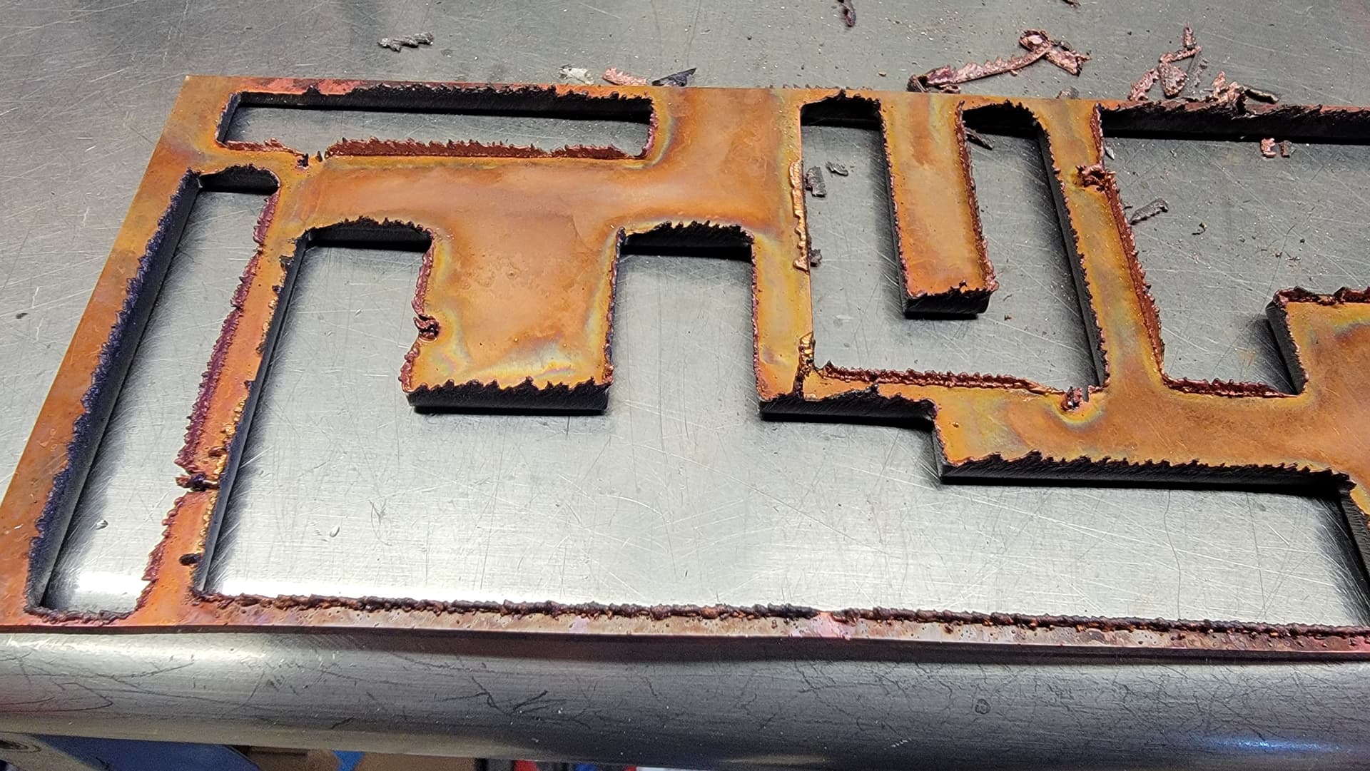

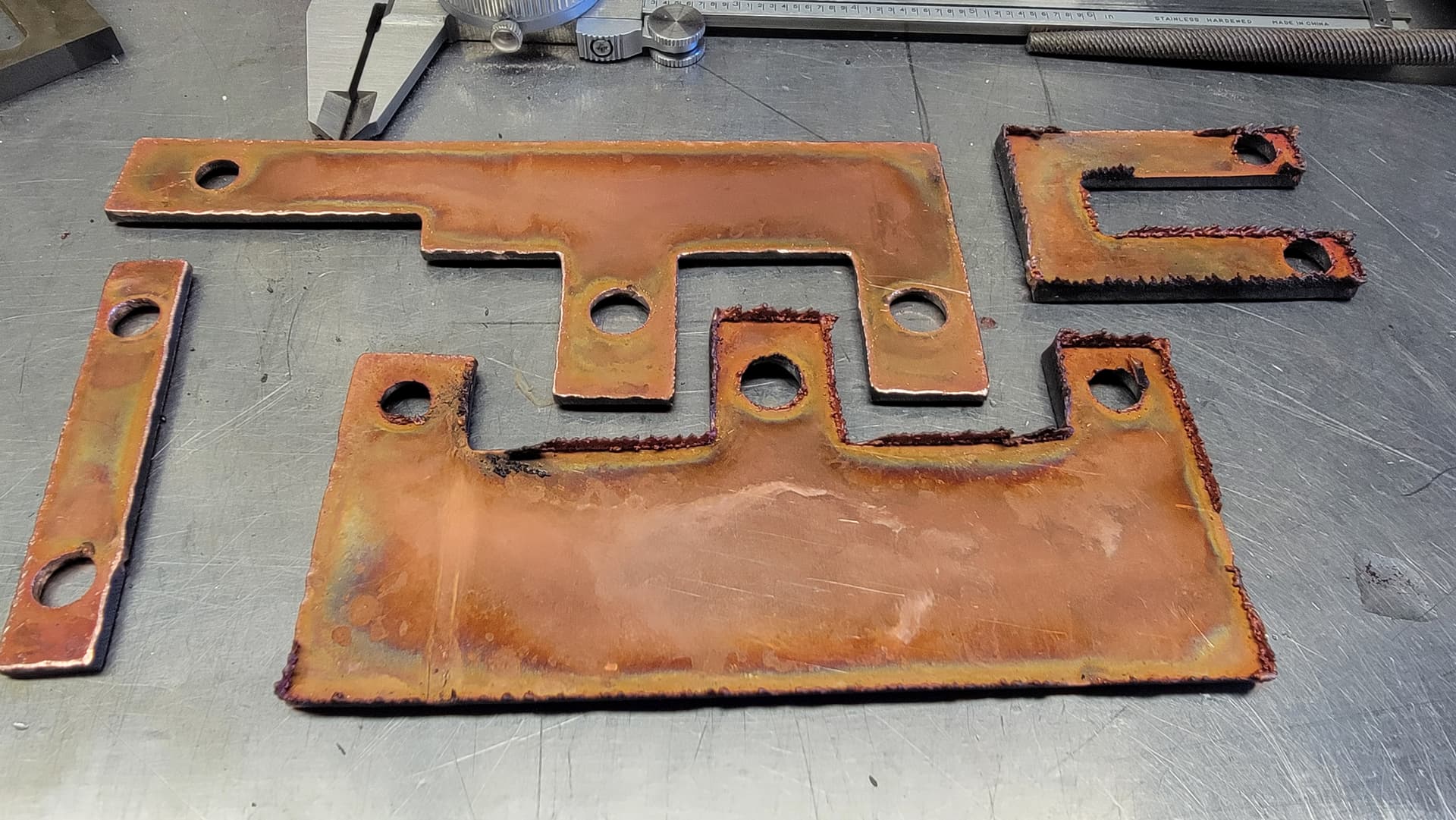

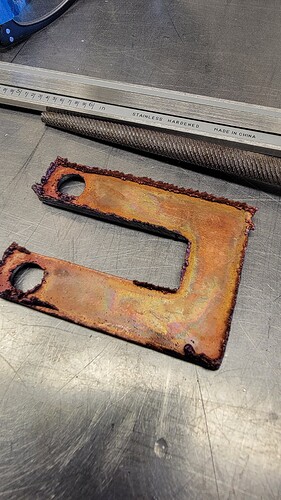

I didn’t have a lot of material to do much dialing in.
Hypertherm powermax 45xp at 45 amps, 90 psi.
.125 thk Cu, .150 Pierce @ .75 sec, .060 cut @ 50 IPM, Std Tip.
Adjusted to
.125 thk Cu, .150 Pierce @ .6 sec, .060 cut @ 60 IPM, Std Tip.

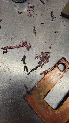

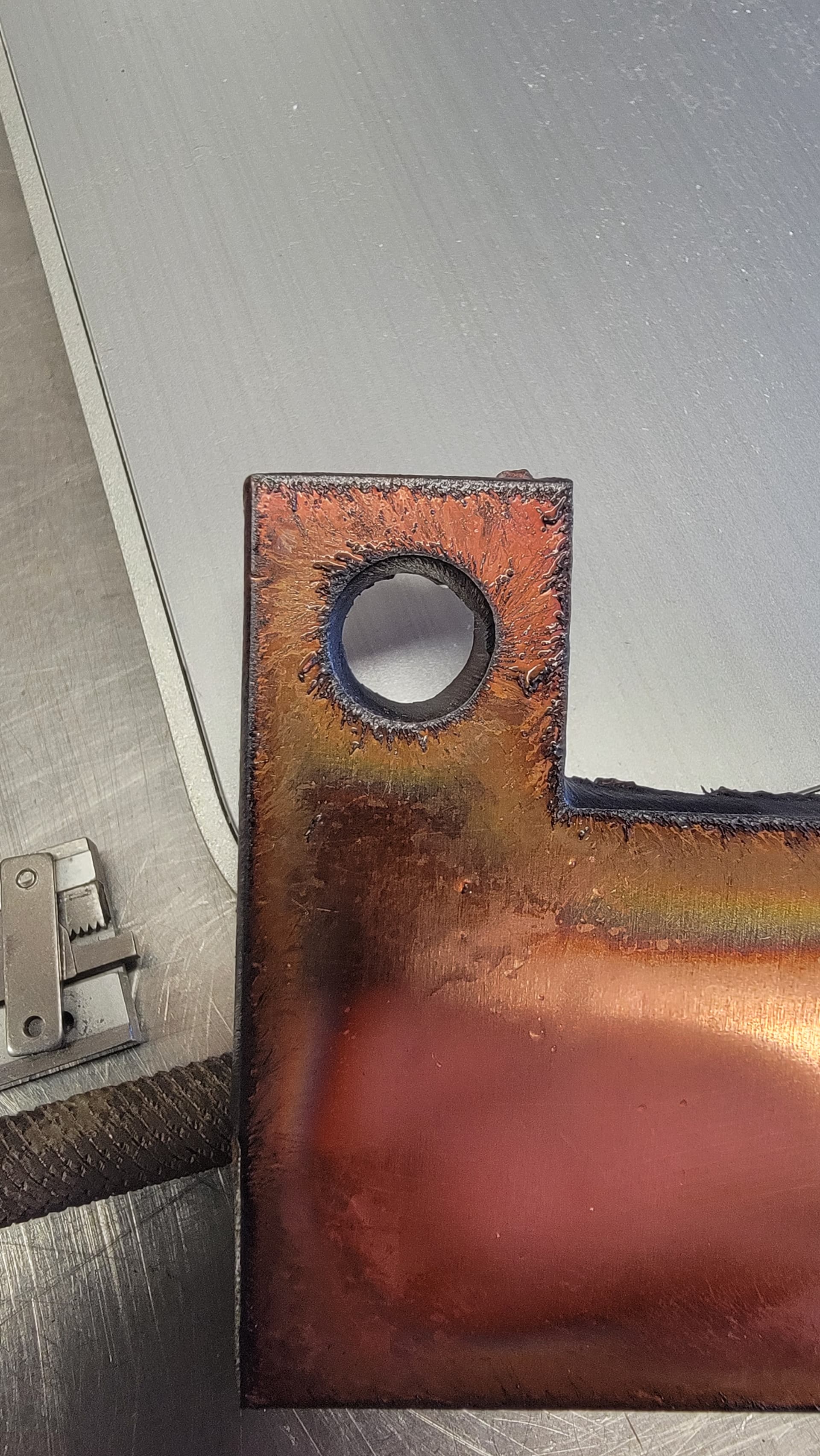

The holes were better at 50 Ipm. They cut undersized with a lot of taper either way. The perimiter cut oversized with expected bevel.
The dross came off very easily.
