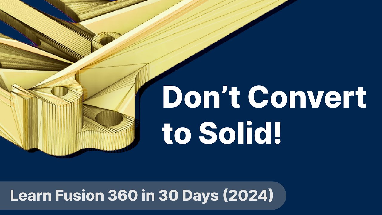

Well conveniently enough the master of fusion YouTube videos just yesterday posted a video on the subject.
There’s not much I can add to this.
Well, that was short and sweet with a lot of useful tips! Thanks for posting!
As always with Kevin’s videos, I’ll have to watch several times, pausing throughout, and doing it along with him. So much info in a short amount of time :flushed: :rofl:

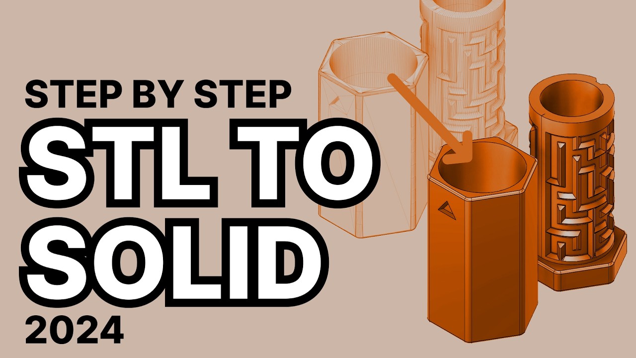

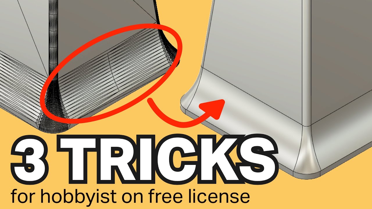

Agreed. In the description of the video, he also references two other helpful videos for those of us without the “prismatic” option to work with mesh bodies:
