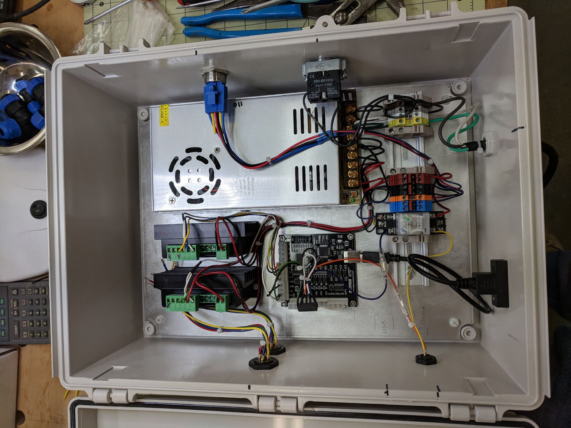

I transferred my electronics to a splashproof enclosure right after setting up my system. It was quite clear the existing enclosure was inadequate.
Here is the inside:
