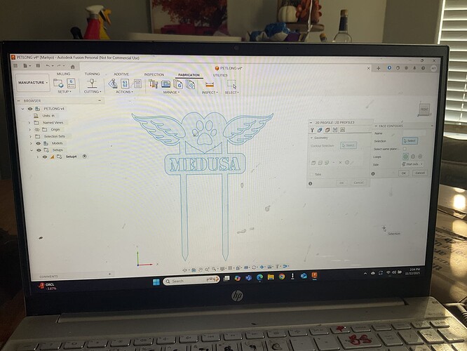

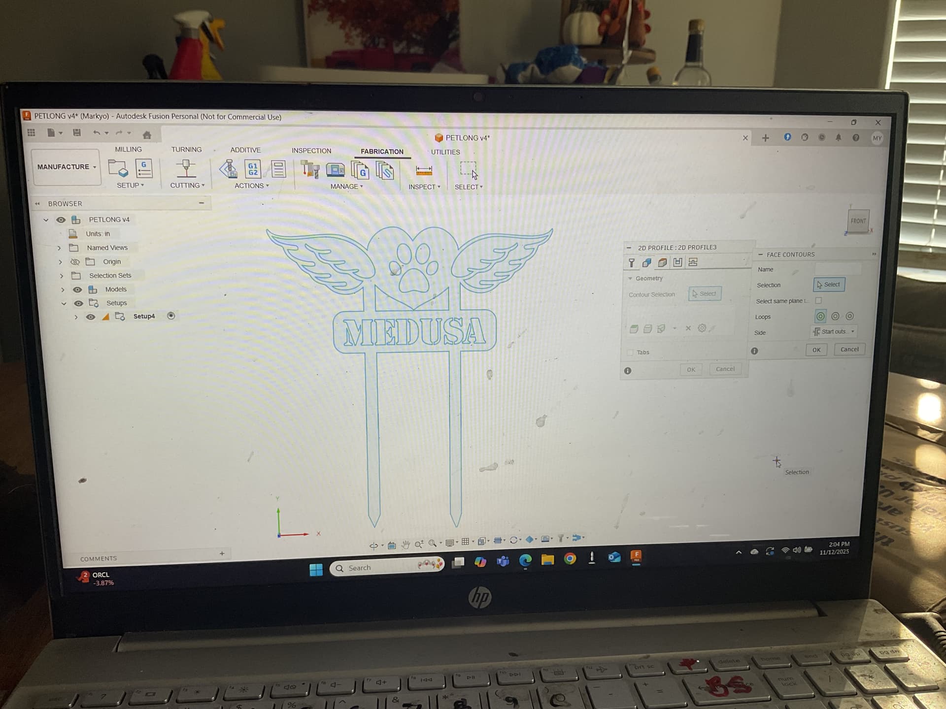

I haven’t used my machine in 8 months ( summer in fresno too hot in garage ) I’ve done 100s of projects but my most recent project I can setup but It won’t let me do the contours to save and cut project. I see they’ve updated fusion so I’m sure it’s simple I just can’t figure it out. It’s a project I’ve cut 20 times I just had to change a name in project now I can’t define contours. Any help?

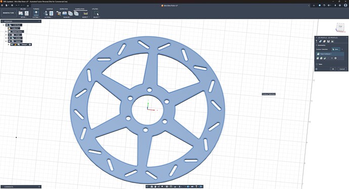

Can you share a screenshot of what you’re battling with exactly?

I’ll create a new drawing and see if I get whatever issue you’re running into, or you can just share the F3D or DXF file here for anyone of us to open it.
I never use face contours, nor do I ever suggest anyone else do it either but that’s just me.
Follow-up, there’s a box that pops up asking for a name, select, and other options such as inside, outside, etc.
It just seems there’s a lot of input required from the user end, so sorry I can’t help like I thought I could. I thought you could just click the area of a closed loop (profile) in a sketch and it would select a face automatically.
It does however, allow an easy choosing of a face contour on an extruded item though.
Maybe someone else can chime in as I never select face contours.

Considering you do not have a face to make a face contour off of it makes sense that you can’t do it.
The only thing I see is a sketch with a sketch profile from your picture.
You need to extrude a body to have a face.

i think you’re on to something took 8 months off forgot about extruding i’m sure that’s it . i’ll try when i get by computer and let you know. sry if i wasted your time but both of you have been super helpful in the past and for that im grateful :grinning_face_with_smiling_eyes:
Please don’t be sorry, it’s not a waste of time. The information helped you and the information may help someone else in the future who stumbles across this topic.
You were right I failed to extrude it worked perfect Tks to both of you :grinning_face:
