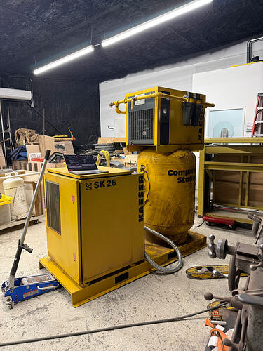

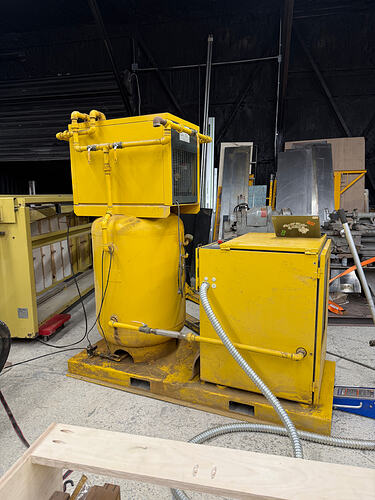

Long story short I moved my shop and no longer have 3 phase power. My compressor, 3 phase Keaser SK26 with an integrated KRD100 dryer, is not usable and I’m in a pickle. It’s a beast and if I did a phase converter it looks like it would end up pulling 120amps roughly. Not an option.
So. Do I get another compressor (single phase) for roughly $1200 and just run the air from that compressor into the Kaeser tank and through the air dryer or sell the Kaeser (3-4k) and buy a compressor with an air dryer roughly 5-8k as far as I can tell. 5k seems hard to find. It seems pretty simple to run air into the Kaeser tank but is there anything I’m overlooking?

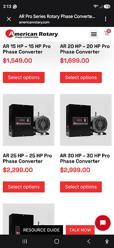

How many amps does it pull? American Rotary has idler motor types that can handle that compressor. I have one in my shop that handles up to 10 hp. They make them for up to 100 hp. That is a fantastic air compressor. 3k and you will be up and running. The Idler-type phase converter is noisy, but it’s sure not as noisy as the compressor.

Interesting. I’ll look into it. I believe it pulls 60amps but that’s from memory with a 20HP motor. I’ve only got 125amps on this breaker panel to play with.
A 20 hp 3-phase motor at 3600 should be around 54 amps. That is a full load. The small service panel is an issue. Run the compressor and almost nothing else. Screw compressor will run with less load than a reciprocating compressor. Plus, screws produce less heat to hold moisture. Much easier for a refrigerated dryer unit to eliminate the moisture.

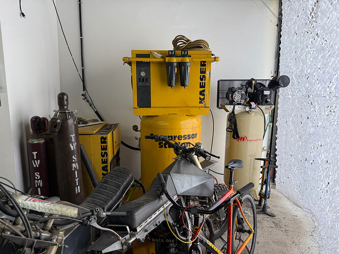

I wound up getting a 60 gallon 2 stage Ingersoll Rand and just running the air into the 100 gal Kaeser tank, which is integrated into the Dryer/Fridge and out from there. Works fine, just noisy and damn, the initial shutoff isn’t until 175psi so that motor is running for a while before it finally kicks off and both tanks are full.
I’ll probably put a regulator on set to 130psi right after the IR tank just so that motor will shut off sooner. 130psi is when the systems kicks back on too.
I wanted to adjust the pressure on/off but the Tech said IR hasn’t used adjustable shut off since 2009. I really like the Kaeser or maybe I should say I really don’t like these types of compressors with this motorcycle engine on it, just a racket. Not sure what I’ll do in the long run, but it’s a whole lot of compressor in here now.
