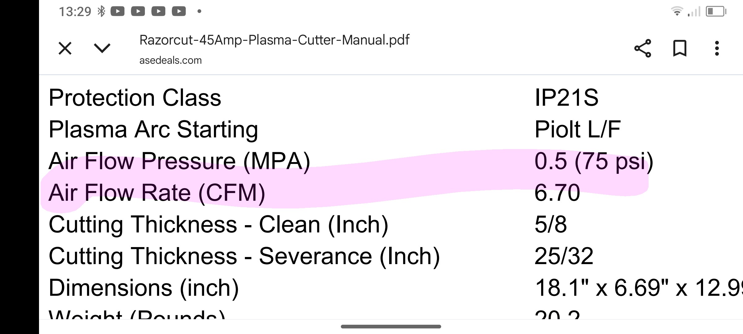

I have been through a lot of posts with different answers but I am trying to figure out what Air compressor to buy. I am looking at a 60gal Dewalt 3.7hp 90psi
I understand this compressor will work but do I need a huge compressor or can it be smaller? If so what are the factors or reasons for a large one?
How many CFM @what psi does it put out? this is what matters!
Post the model number of the unit.
In the literature for your plasma cutter it will show a CFM@X psi required to operate that machine. Some manuals will even show how many CFM is required for mechanized cutting. If it doesn’t it’s usually 1.5 times the posted CFM requirement for hand cutting. And if it doesn’t define it assume that it’s hand cutting.
So you’re probably looking at about 9 CFM at 90 PSI. You could get away with a smaller one but that’s going to run it very hard and hot which will bring the consequences of low life and the ability for the hotter air to hold on to to more moisture and put more load onto all of your moisture removal equipment.
It depends what you’re doing if you’re just a hobbyist cutting a couple art pieces or a few brackets at a time… yeah you could probably just run the bag off of a small compressor.
If you’re serious get a real compressor.
13.4 CFM at 40 psi and 11.5 CFM at 90 psi with 1.9 RHP
You’re more than fine.

No way of knowing of what you already are looking at is it cheap compressor to start with? What’s the model number? But yes you could go a smaller compressor it sounds like that one exceeds the specs needed. Going with cheaper stuff has the inherent issues with cheaper stuff.

Generally speaking, a 220V air compressor will suffice because I don’t think anything a big box store offers will provide less than 9-10cfm
It’s only when you tread into 110V territory that you’ll be warned about potential issues and possibly no cutting at all; fortunately it seems like 110v air compressors aren’t in the talks

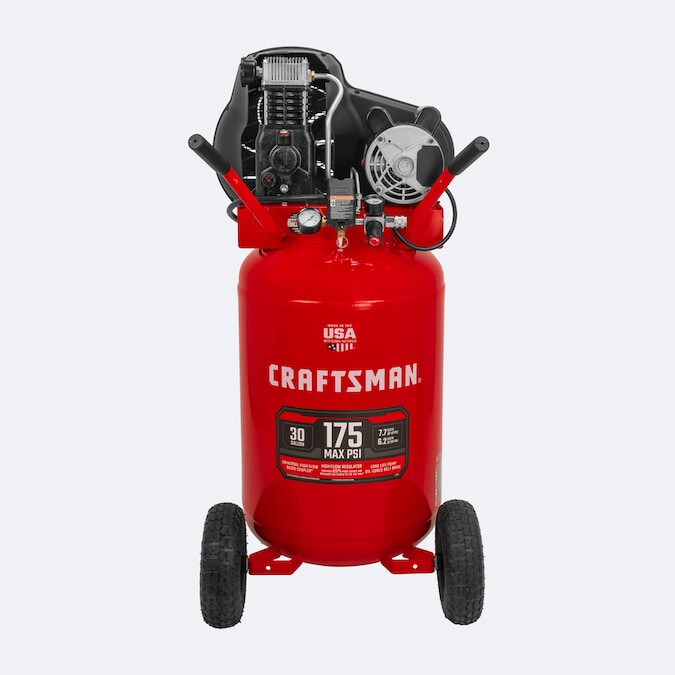

I didn’t have another 220v outlet to dedicate to my small garage shop (I already had to run a 30a 220v for the plasma) so I went with the most powerful 110v I could find, the Craftsman 30gal 150psi. Been a great little unit so far, even through my intercooler modifications (and back to OEM config after getting the refrig air dryer). I picked it up on sale at lowes on a black friday deal for like $400 or something.

That’s pretty much the max you’ll find available for 110v since you’ll only get so much “hp” through a 110v circuit.
Those tanks and motors are used interchangeably with different labels such as Kobalt, Craftsman, DeWalt, and several more.
