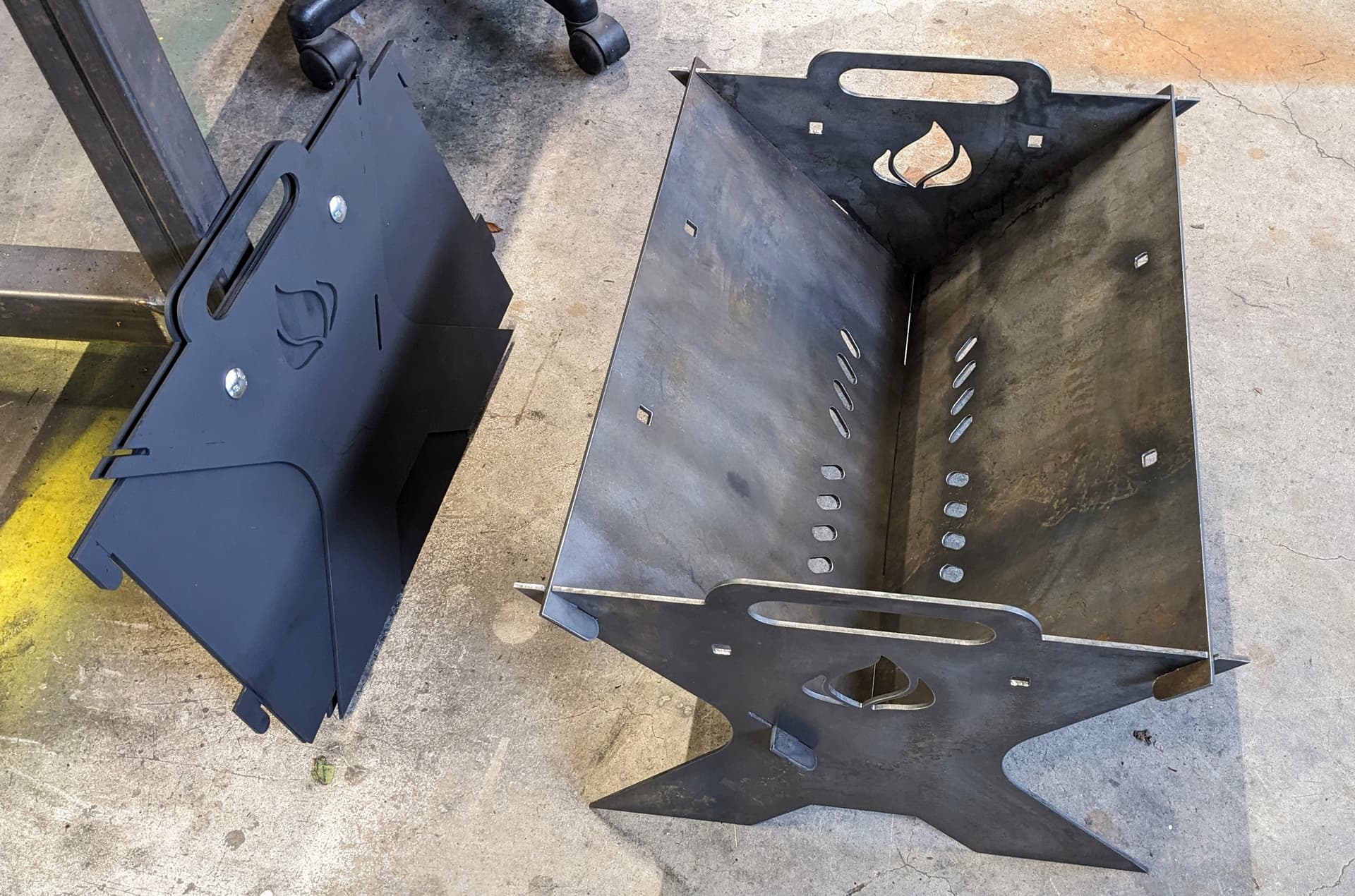

good moring everyone, have any of you guys cut or are cutting collapsible bbq grills on the PRO? I was told that the plasma cutter would warp the metal even on 1/8 PO.
if any of you guys are cutting some can you let me know if its possible.
thanks

I cut 1/8 (10ga) all the time. Keep your water table full / lapping at the part to cool it quickly after the cut and you should see minimal warpage, unless you’re cutting through cold rolled (because internal stress relief).
yea thats what i thought. have you cut collapsible grills before?
Could you elaborate on what those are? Maybe with an image of the CAD?
We had a fireplace “contest’“ on here before.
Had a few different examples.
I guess they’re not really grills per se but they’re in that ballpark.
This is cut from 10ga steel. Assembled to the right and a flat one on the left. They didn’t warp from cutting. They might warp from burning a fire in them.
I agree you would be more likely to have them warp from the fire then from cutting. Most of what I have cut is 1/8 inch and I haven’t ever had a problem with warping. I designed one similar to what @ds690 posted for the contest @TinWhisperer sponsored. I haven’t cut it out yet, I was planning to use 1/8 inch. From what I have seen it is probably the as thin as you would want to go but I have zero firsthand knowledge about it.
