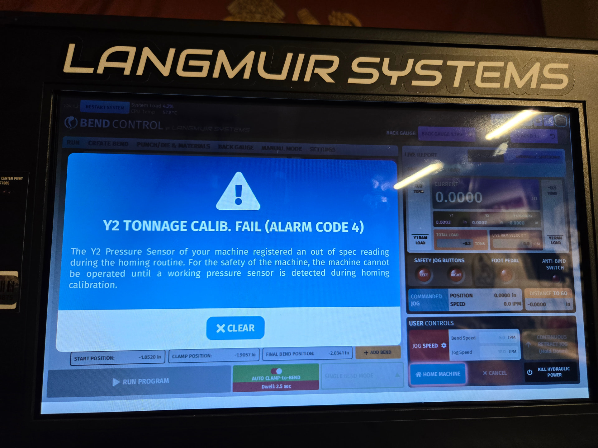

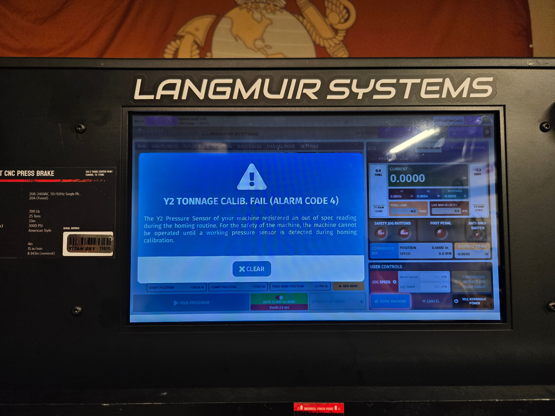

Code 4 Homing issue
Homed my machine and received this code for the first time ever.
Cleared it, and it homed the second time.
Bent some parts, precisely might I add.
Decided to home it again just for the heck of it before the next bend and got the same warning.
Cleared it and it homed the second time.
Am I seeing a failing item here?
The -0.3T looks like of like a -0.4T reading, so I am thinking this is a faulty motion control board.

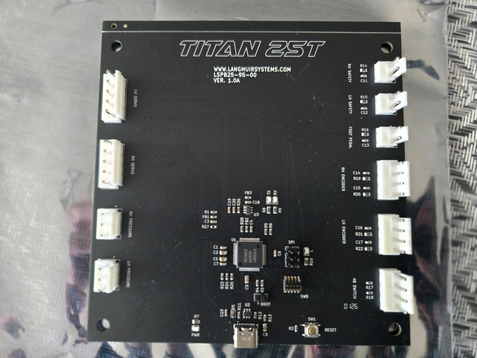

To install it, I recommend:
  1. Remove the bolts on the underside of the enclosure that hold the electronics assembly in place
  2. Remove the Backgauge Electronics Assembly. Remove the bolts that hold it to the enclosure, and unplug it from the USB.
  3. Test the new base machine control board by swapping out the cables on the old control board and plugging them into the new control board, and running the machine.
  4. For the full replacement: remove the touchscreen so you can work on the machine through the front window.
You will want to save your ram-to-table opening distance before swapping out the control board.

I had this warning screen several times. I had inadvertently changed the RAM-to-table setting. When the ram came down to hold the metal, it would start to bend it a little due to the setting, and the alarm would pop up. Sam walked me through it and has never done it again.

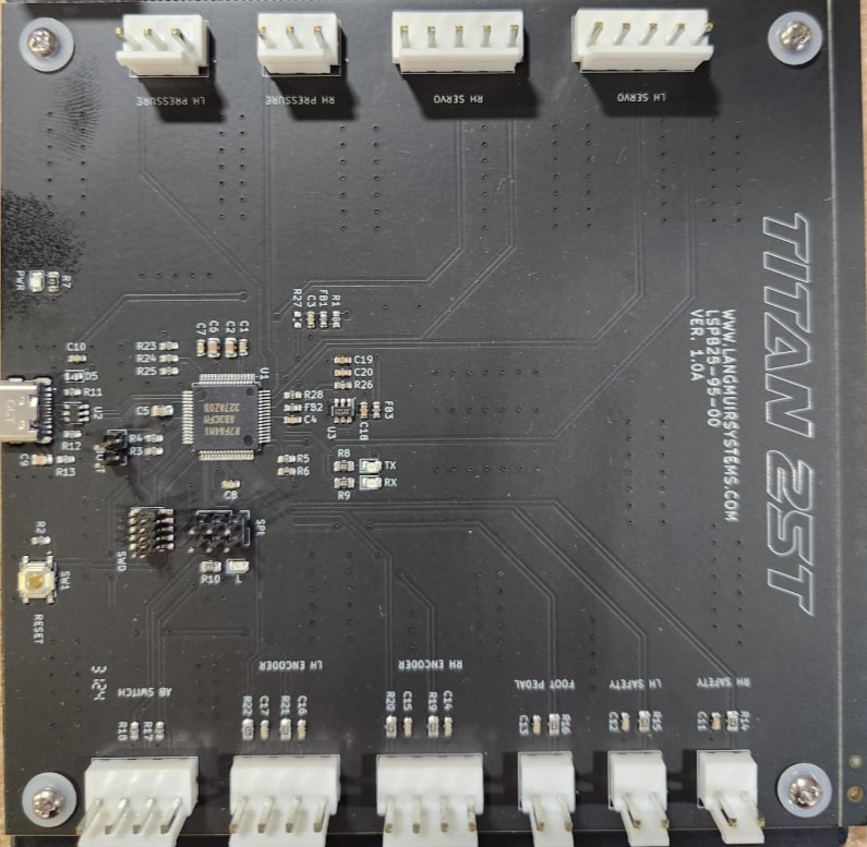

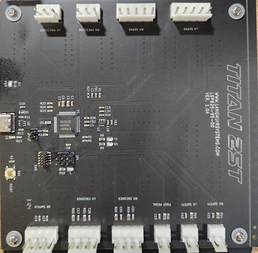

I should update the thread to add that I unexpectedly received the new board yesterday from FedEx.
Like Sam mentioned, it was a simple oversight and that I was indeed covered.
Wasn’t joking when I said I was in no rush as I really didn’t a replacement sent right away - was more of a “am I covered or not” thing. Anyway, the board is here and I’ll look into replacing the current one once we’re back from being out of town.
I’m still curious as to how it would fail although I’m sure everyone is that’s had this happen (including Langmuir).
Have fun installing it. A documentary of it would be great. There is a whole lot of stuff in that box.
