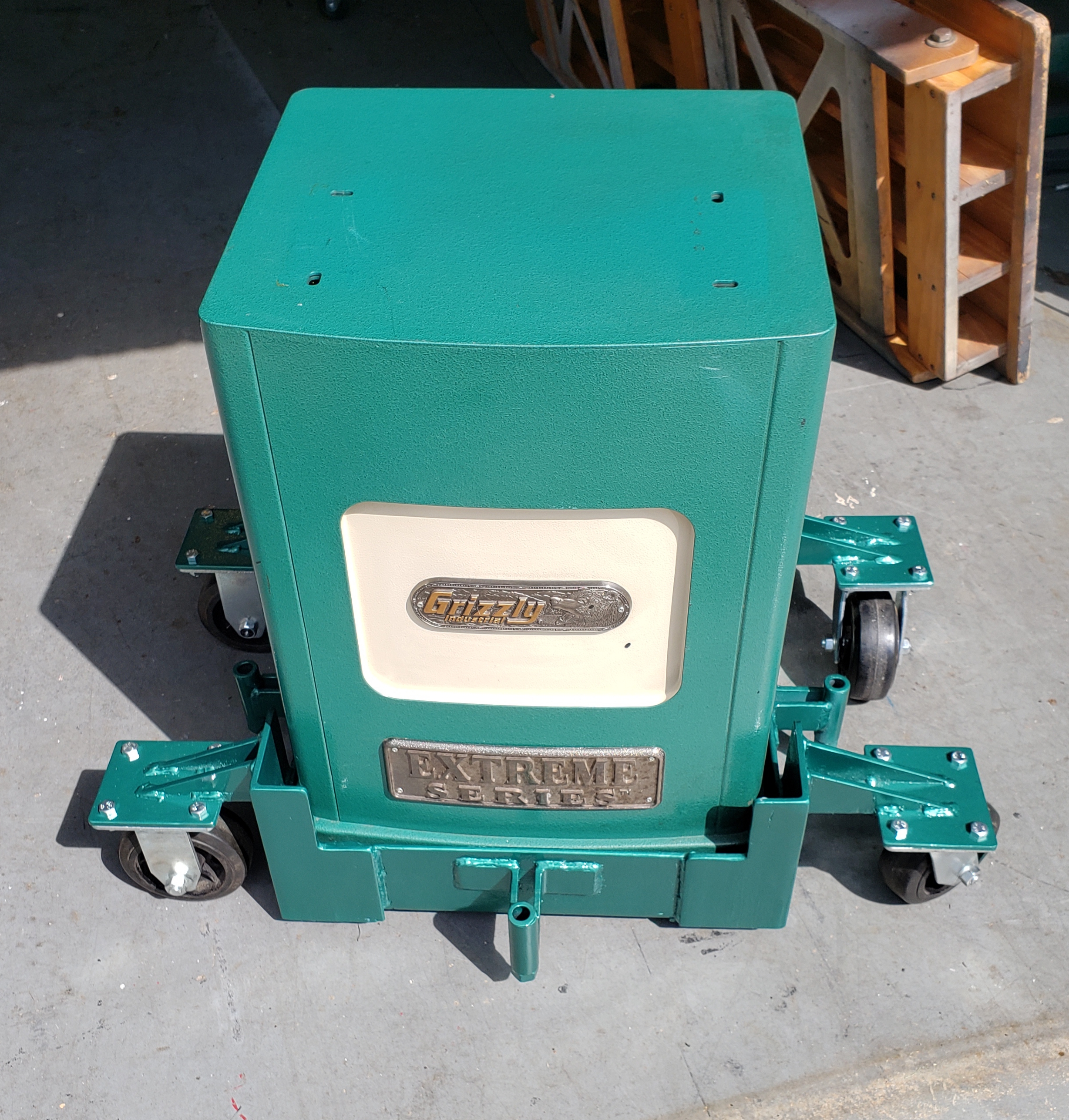

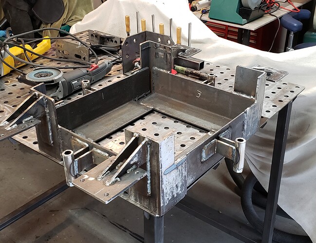

I use mine for all sorts of stuff. Its tall… and at first I thought I was gonna hate it… but it’s the perfect height. I do a lot of small engine repair. (Mostly 2-stroke stuff. ) and it’s nice to have a metal table that’s tall to bring stuff up to you. And I don’t have to worry about fuel and grease on it. Oh… and it makes a great welding table too. Lol. Have fixtured up all sorts of things nice and square… like this mobile base for my grizzly bandsaw
here’s a shot of it done… minus the leveling feet. I did this pre-Crossfire…I am contemplating a do-over. Lol
