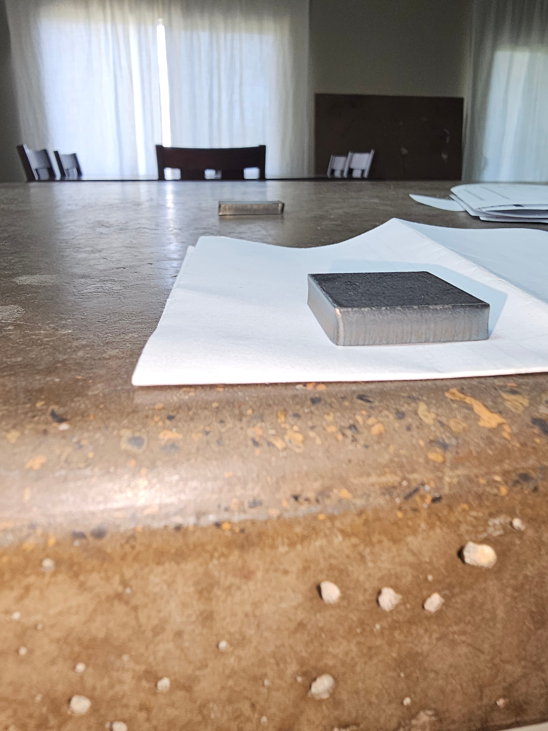

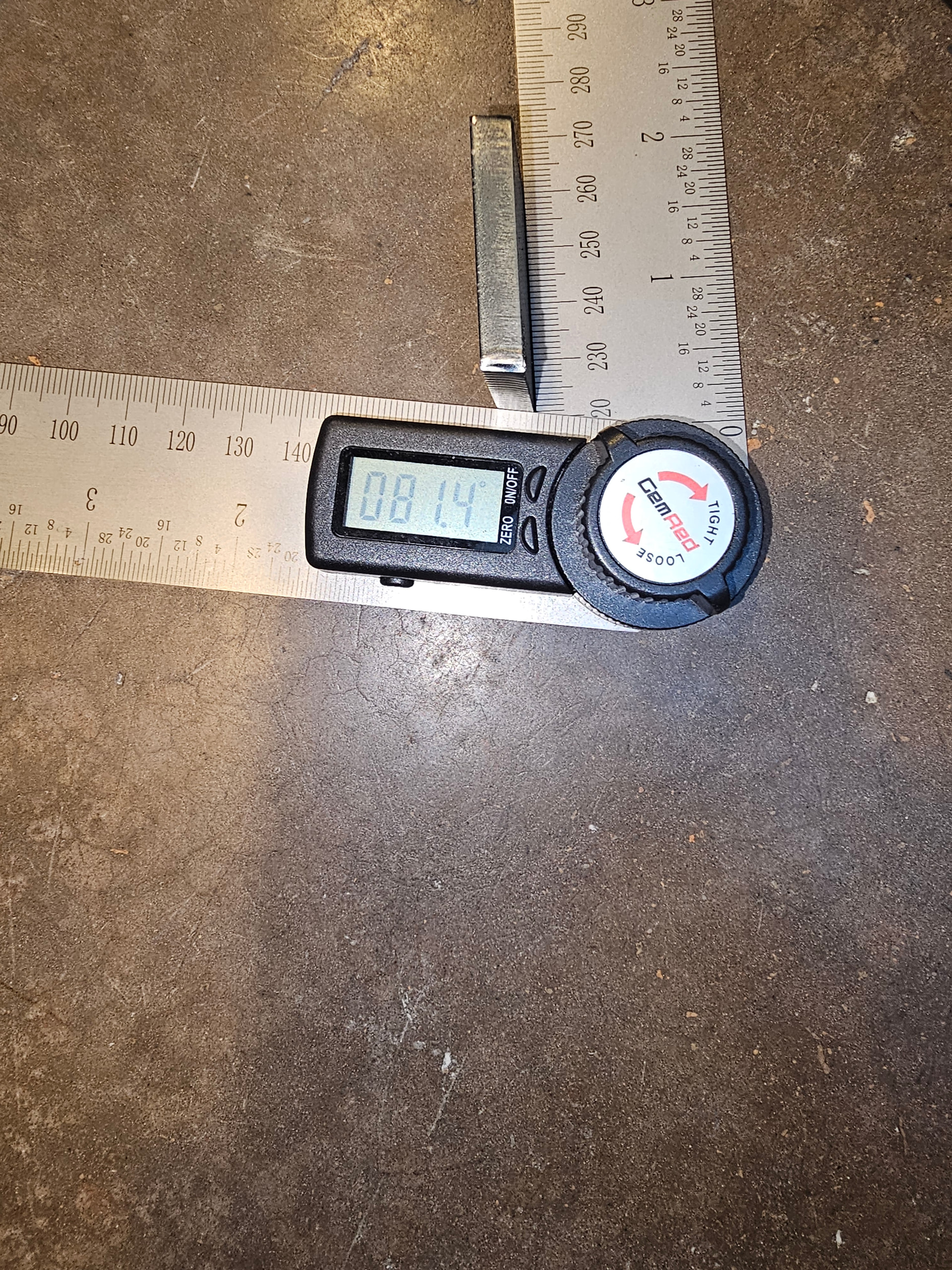

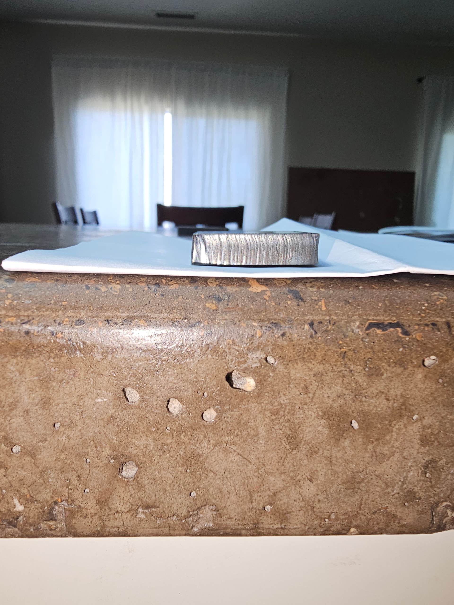

This is a CrossFire Pro. The cuts in the x- and x+ directions are square to the table it is in the y-and y+ directions that are off and that is the direction that I don’t see any adjustment for. My current approach it going to be to recheck the consumables and if they’re good I’m going to 3d print a sleeve to offset the torch at an angle to see if that will fix the problem. The picture shows how much the cut is off from 90 degrees. The angle measures 8.6 degrees. The direction of cut is along the Y axis.
I checked the consumables and they are good. I measured the angle of the cuts along the Y axis and they are off perpendicular by 8.6 degrees.

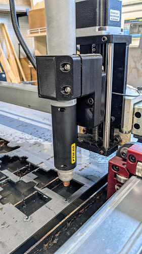

I use a 3d printed machine torch mount that I designed. I posted the files on thingiverse. There is a small amount of play in the mounting holes for squaring the torch to the table surface.

Thanks, I’ll try rotating the torch. If that doesn’t tell me anything I look at your torch mount on thingaverse.
Thanks for providing that file.
I found it on a Google search and printed one out of ABS for a local that needed help with his table. Up to him to figure out the hardware to use :rofl:
Yeah, it went through a few iterations with the hardware. I use metric fasteners, because I build bicycles and that’s what I have on hand.

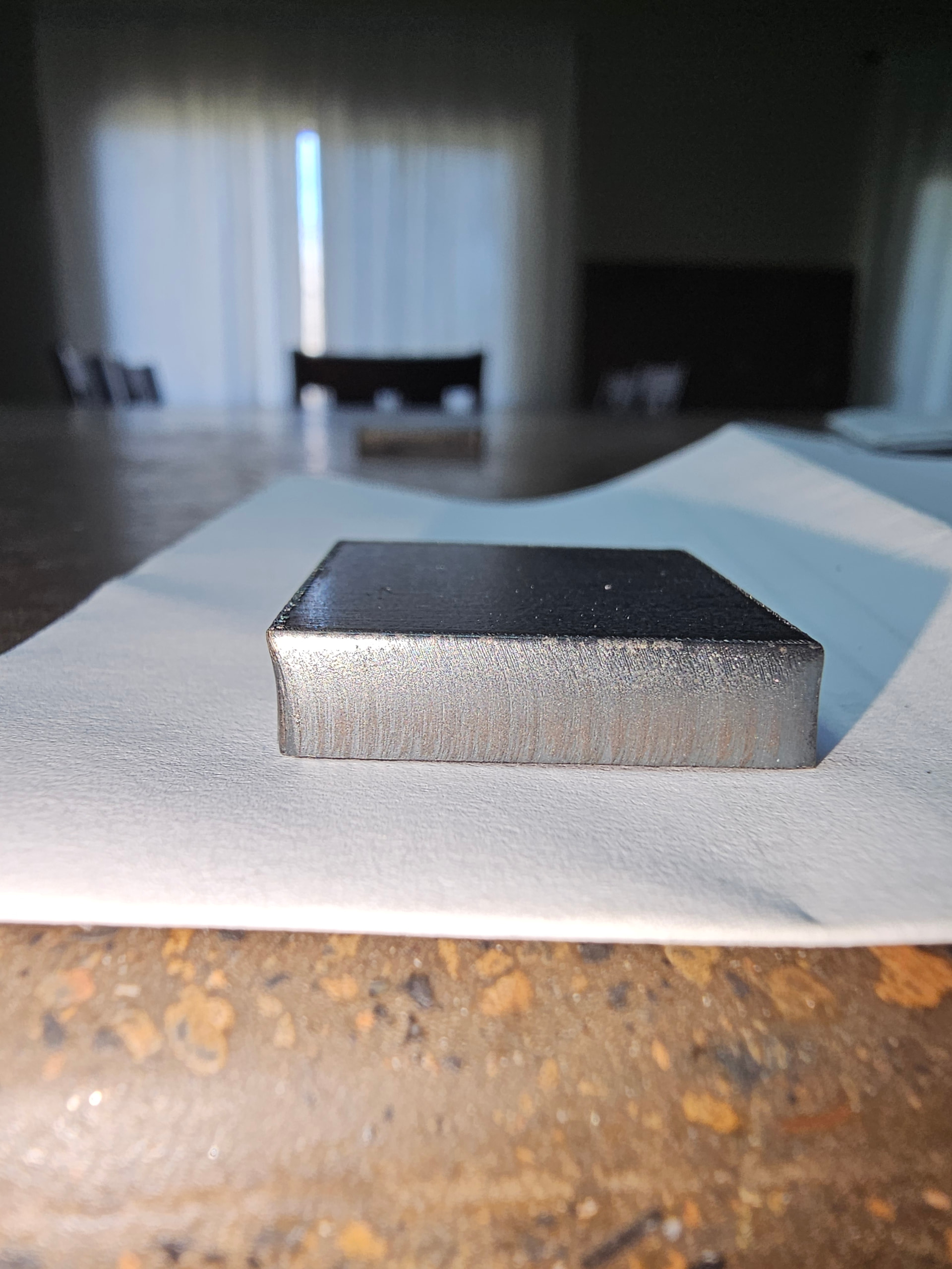

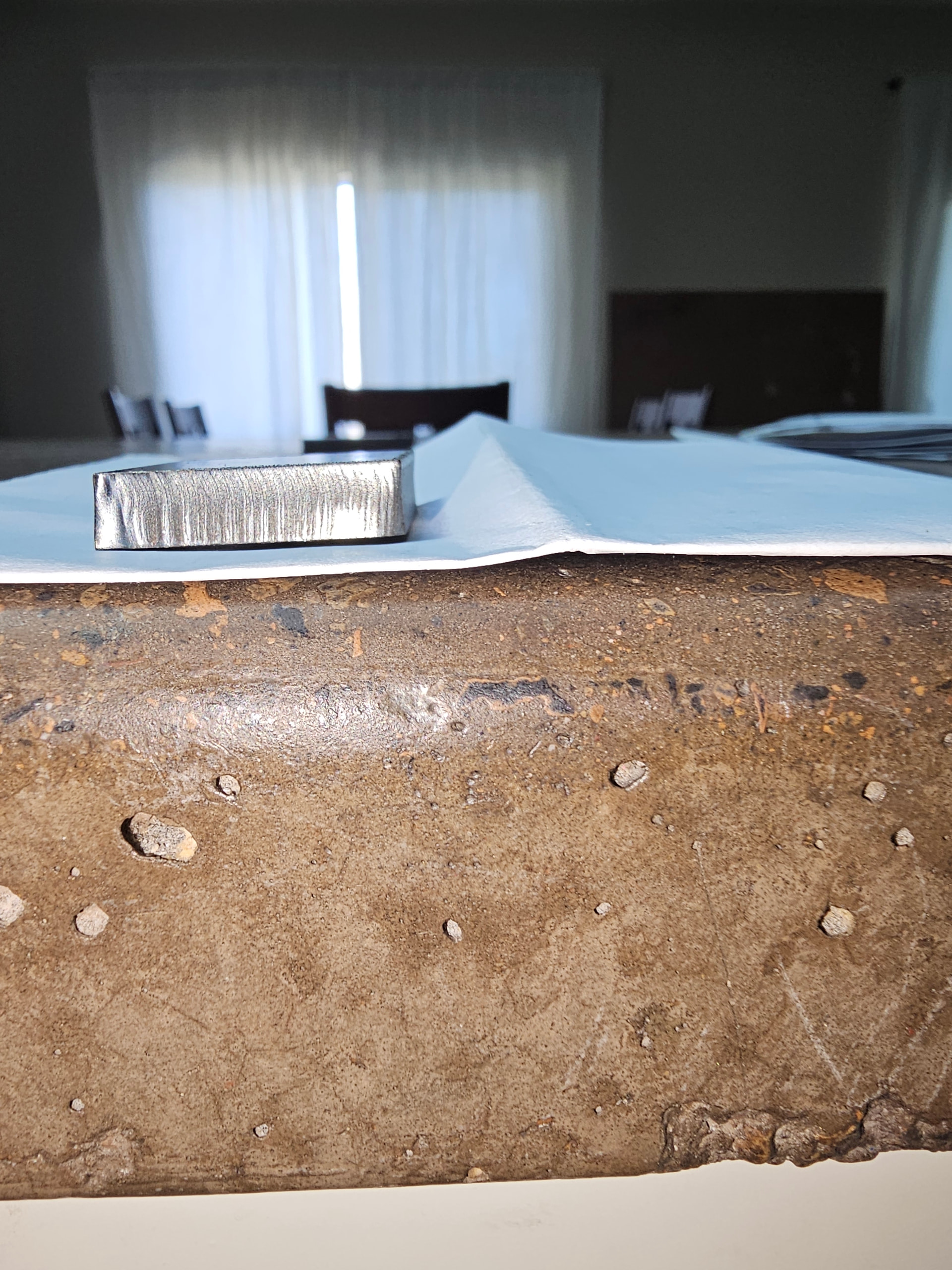

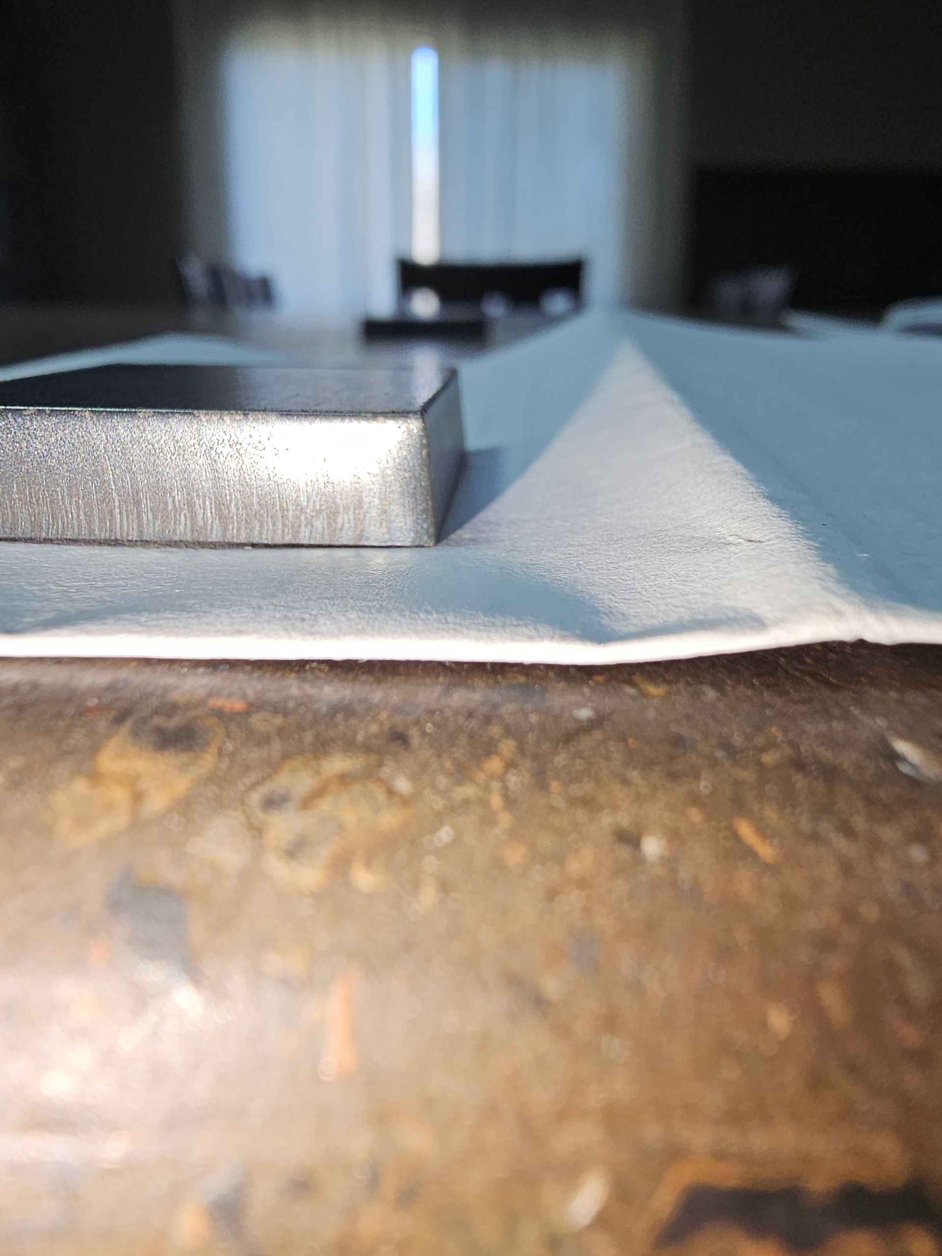

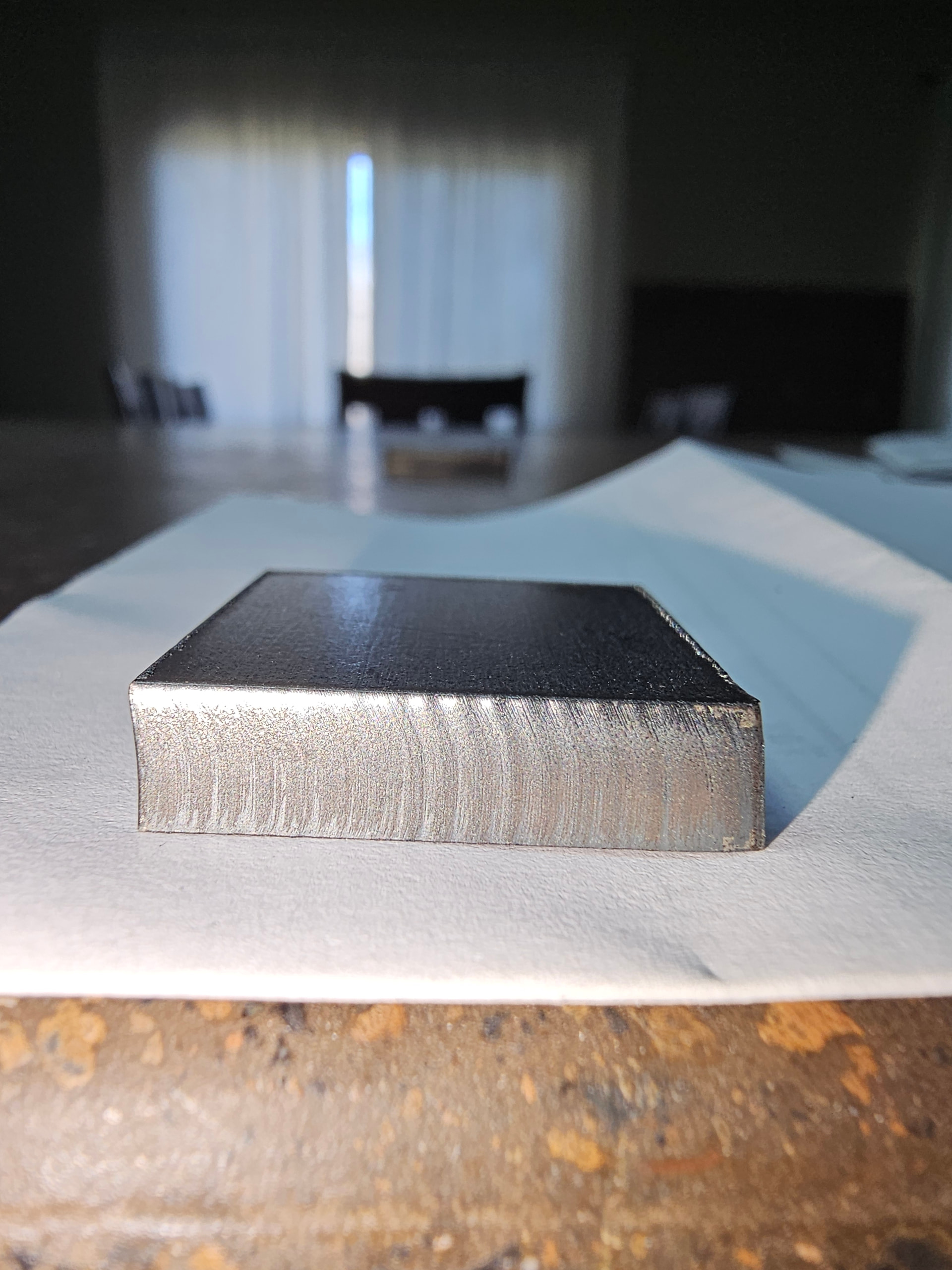

I rotated the torch with little effect. I did increase the air pressure to 75psi and I fiddled with the pierce height, cutting height and pierce delay. Here are the results I got. The first 4 pics are of the squareness of the cuts. The last 2 pics are showing the difference of the surface(finish) of 2 different sides. Would you consider these acceptable cuts? I do cnc machining and 3D printing. This is my first cnc plasma table, I was expecting better results. Maybe I have unrealistic expectations.
Not you. I was responding to a post that is now deleted.
Have you tried slowing your cut speed?
Not yet but that’s next on the list.
Try at least a 20 percent reduction. I had a similar issue cutting 1/2 material. I had settings dialed in pretty good then I made some setup changes. Slowing down really helped.
