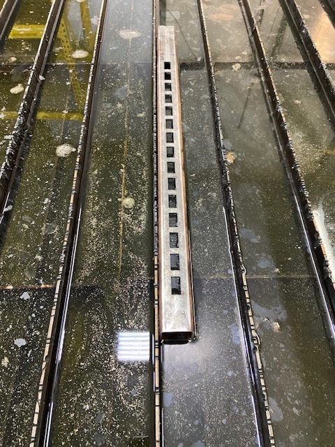

Can you cut holes on one face of 1-1/4" sq tube? (Yes you can, quite well infact)
Can you cut holes on one face of 1-1/4 tube and not burn through the other side?
Several ways:
If you can submerse part of it in water, you would be fine.
Or put a piece of sacrificial metal strip inside.
I will see if I can make that work, Thanks
The lower the amps the better chance you will have.
I have been cutting 14 ga sheet at 30 A I will take some scrap tube and see how it works.
Also like to get advice from you guys first!
Thanks George

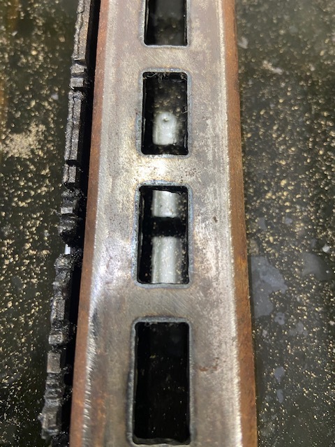

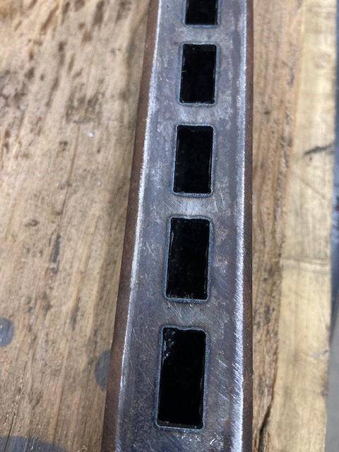

Tried it on scrap and it went better than planed.
Not bad for the ole RW45 w/Hypertherm torch. :grinning:
1.25 x 14ga sq tube 30 amps 120ipm
I think you may have just solved my extra Cross Beam with no upright problem on some metal shelves.
Now I just have to learn to index accurately
