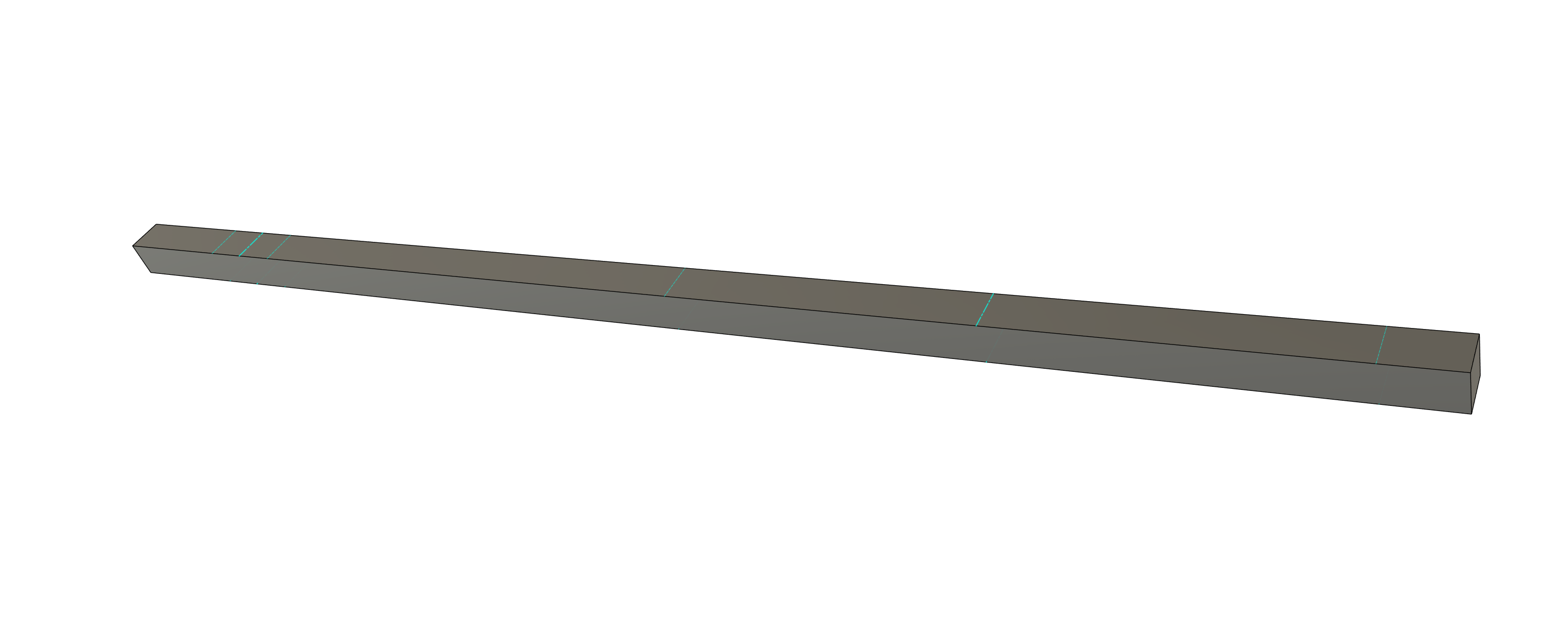

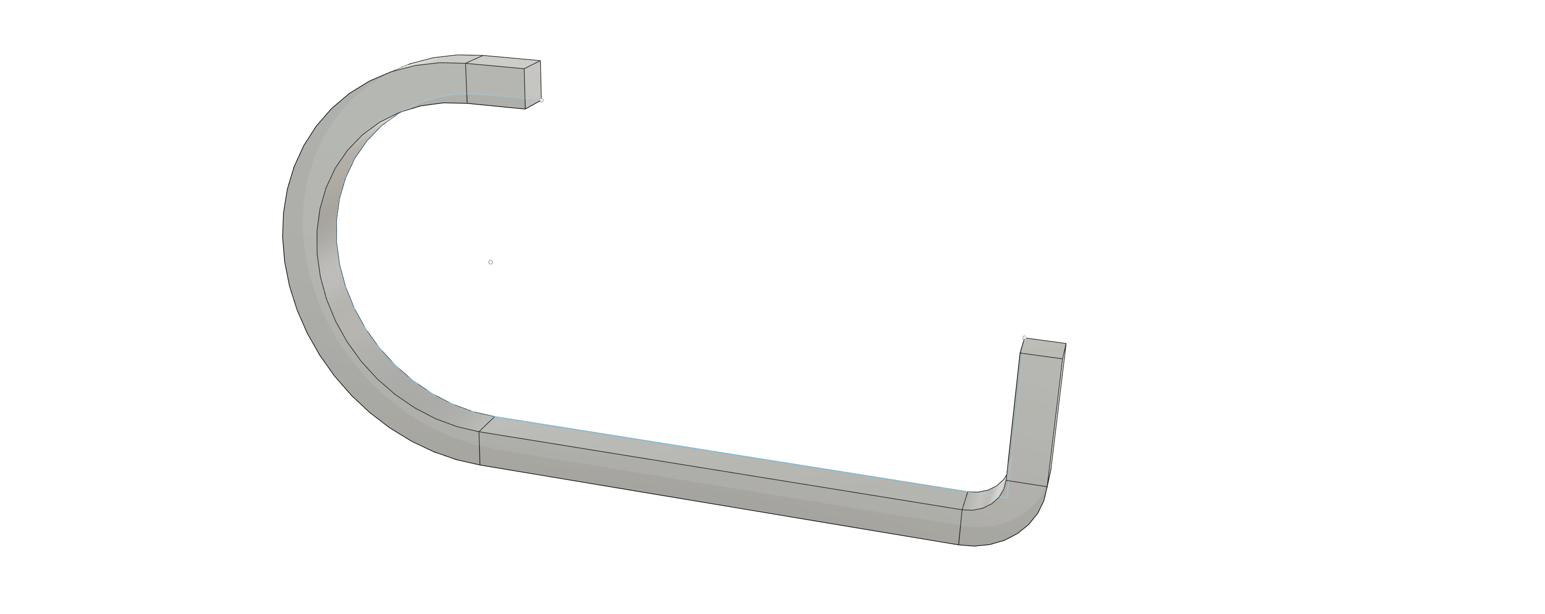

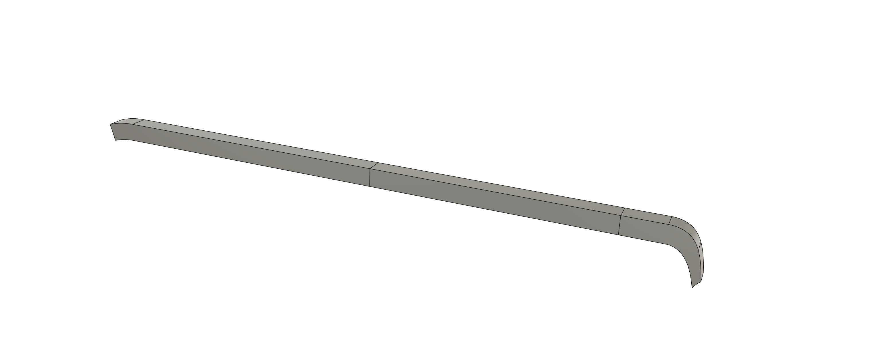

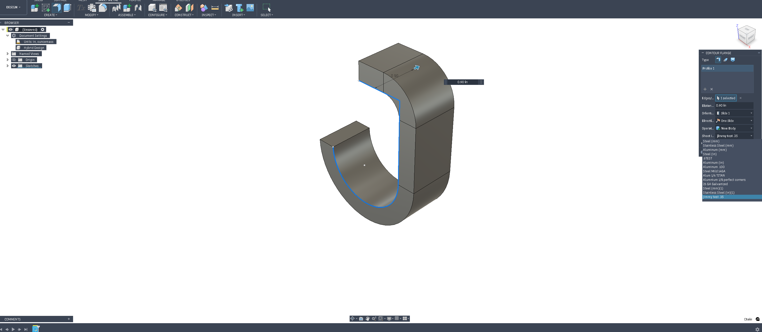

Can this be converted to a flat pattern?
So I can create a flat pattern but its not completely flat. What am I doing wrong?
CMS banana tree tower hook.f3d (64.1 KB)

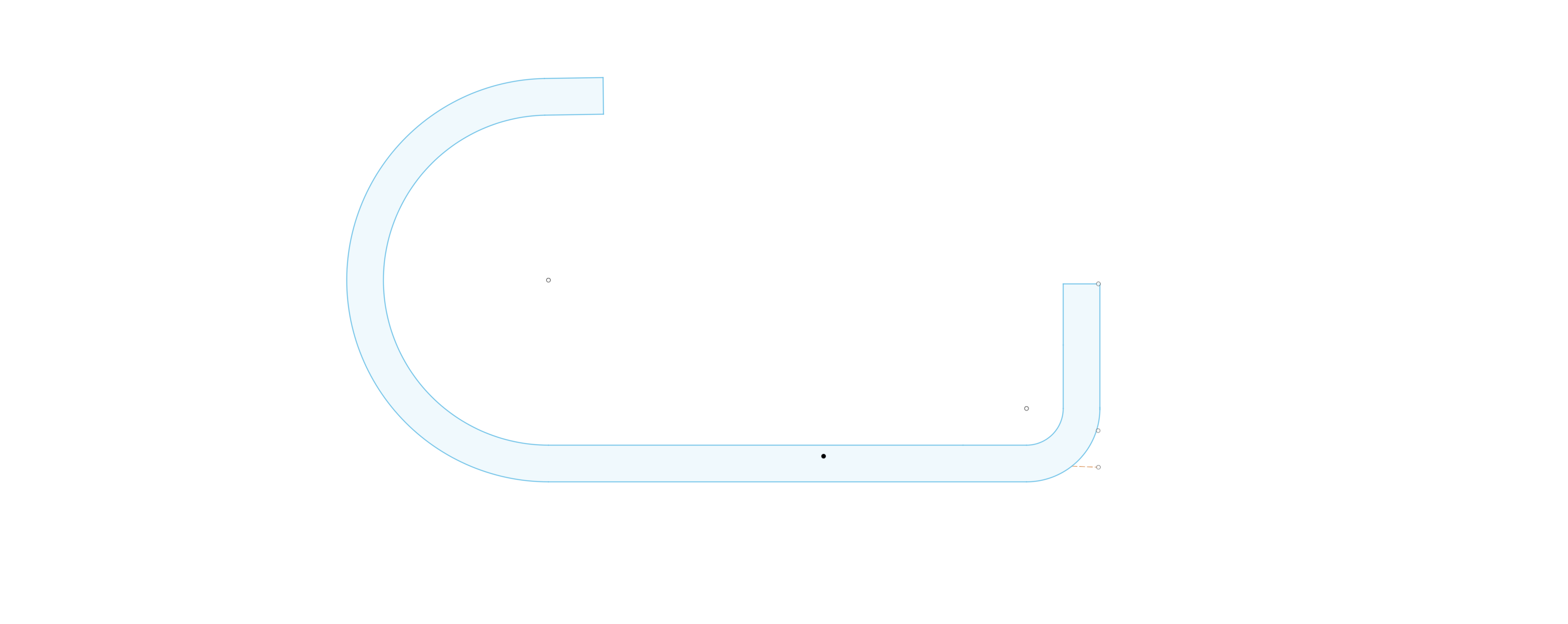

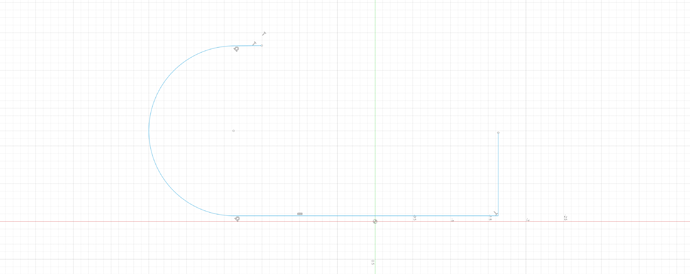

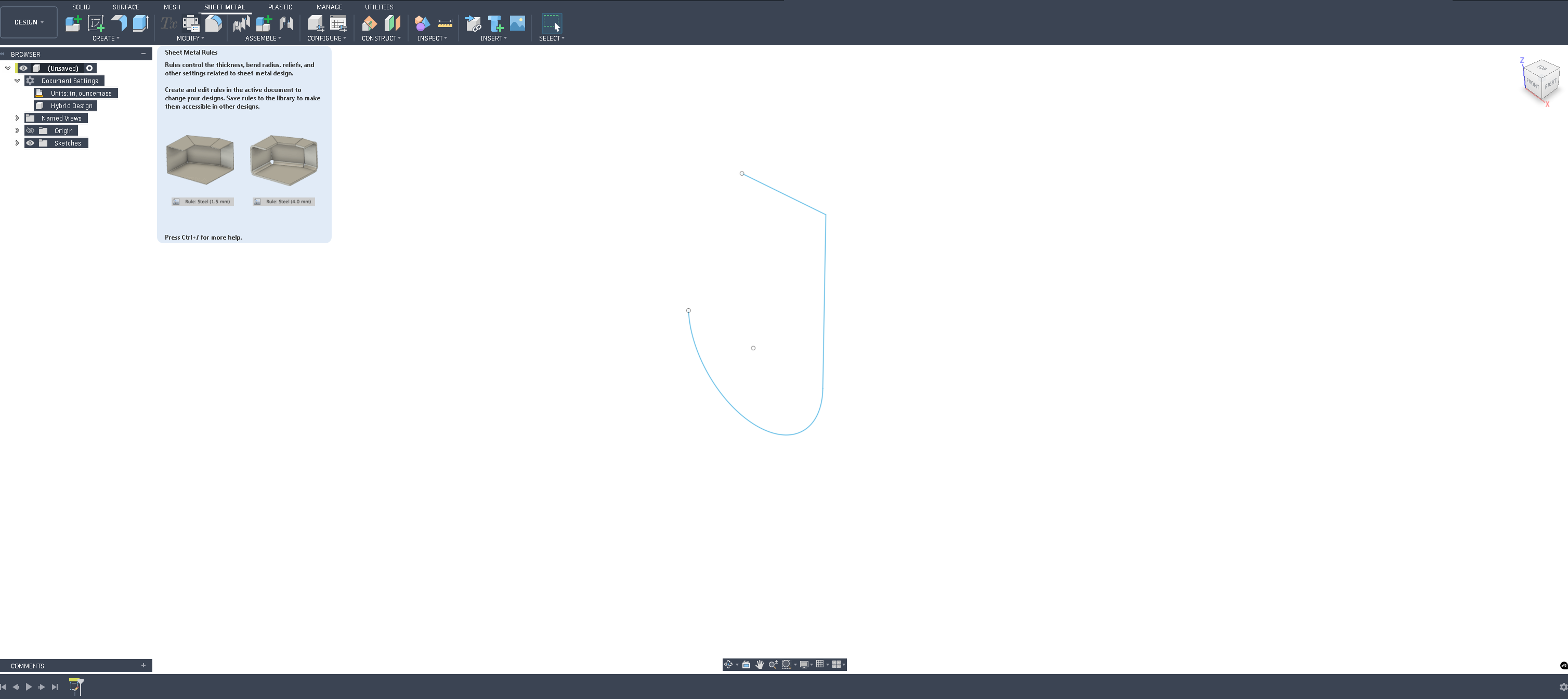

Fusion can be finicky about the profile used to construct a sheet metal part. If the thickness deviates at all or single lines are broken up into multiple lines it doesn’t like that. On your drawing I can see that you extruded a profile that you constructed.
If you use a profile and there’s any deviation from the overall quarter inch thickness along it and in the radii fusion will start having a fit.

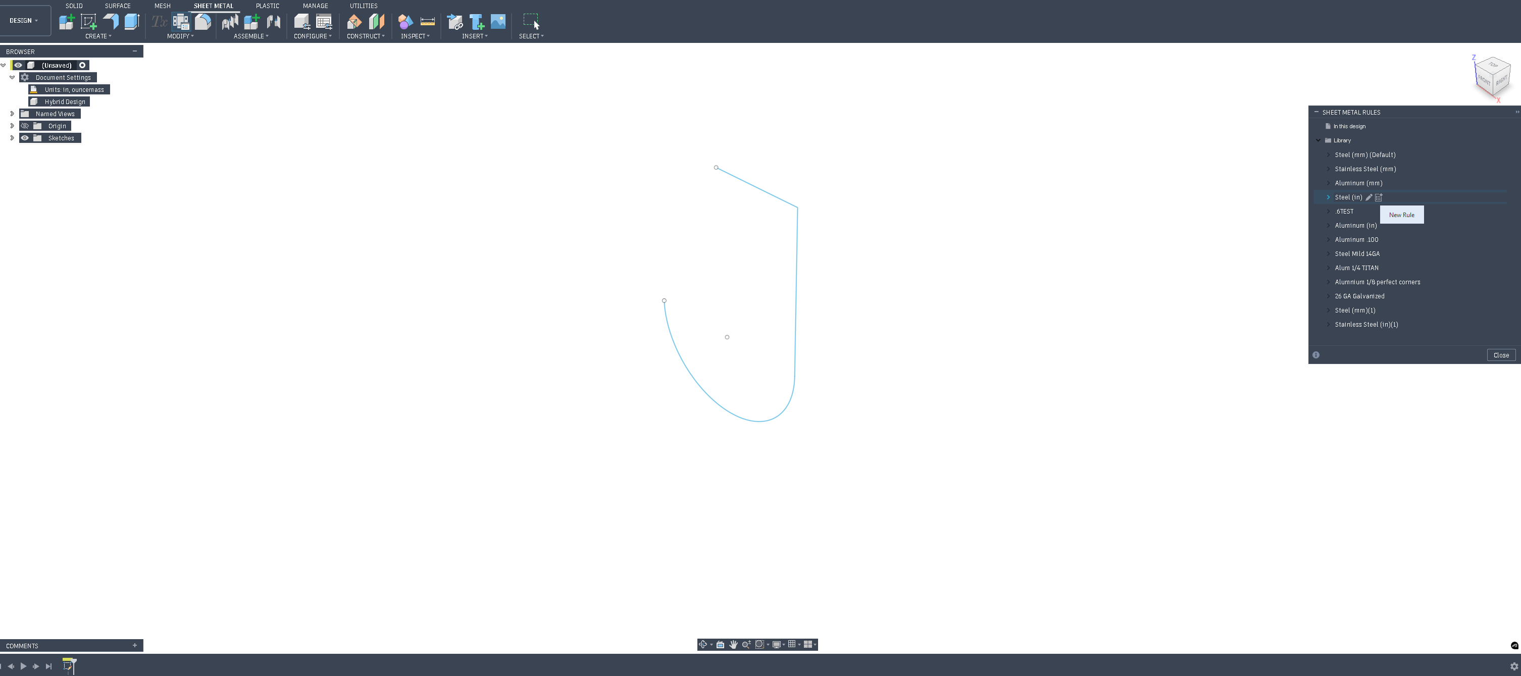

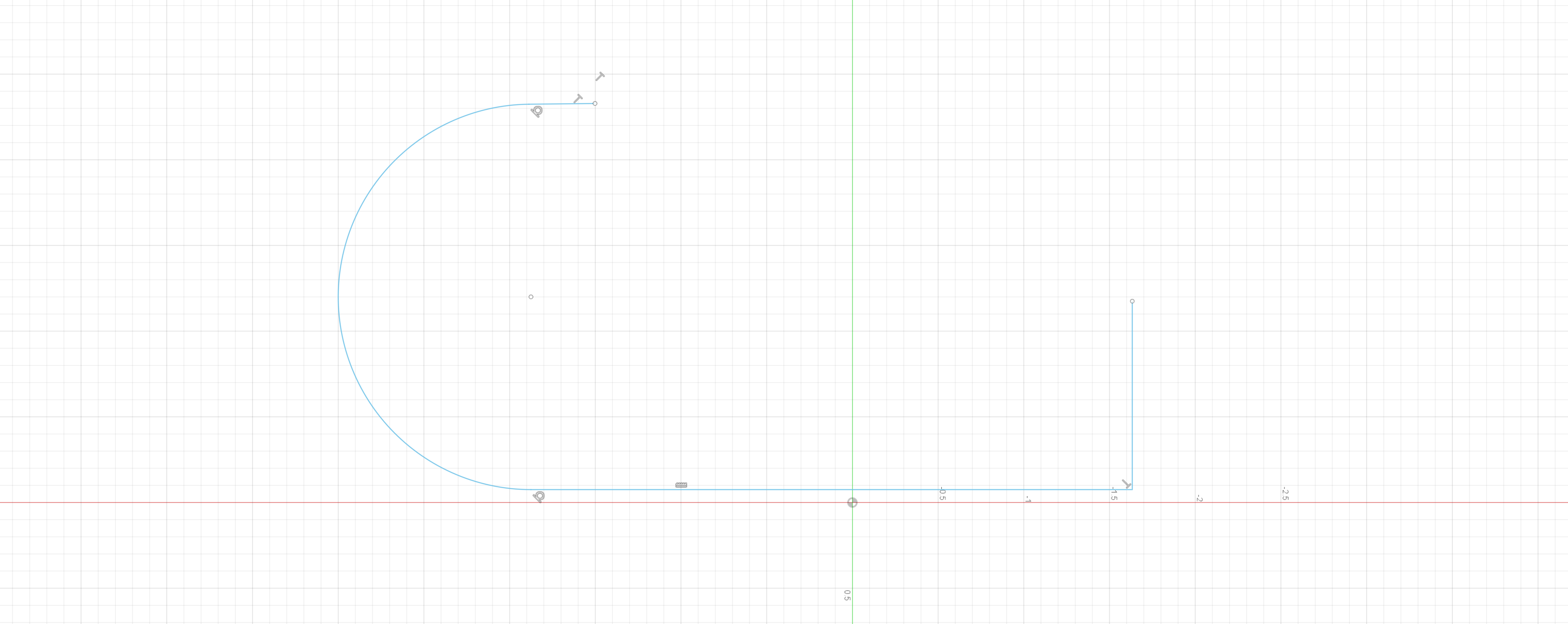

instead use the flange tool on just a line drawing of the profile you wanted.
Doing it in this order will allow you to create a proper flat pattern

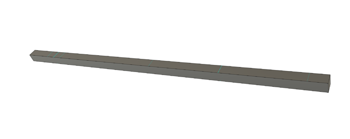

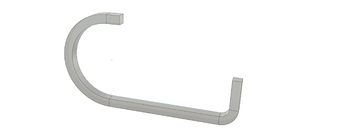

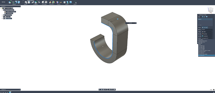

I modified your F3D it’s attached below
CMS banana tree tower hook tin mod.f3d (142.6 KB)

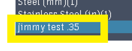

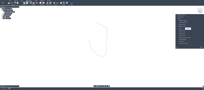

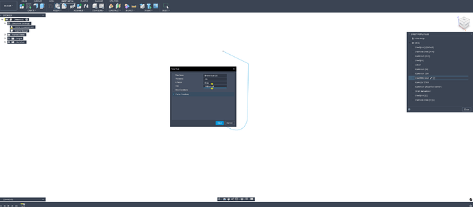

How do you change the thickness of the metal with the flange tool. It seems when I try it (inches) I get either a default of 0.08 inches or 3/16 of an inch with the drop down menu with the Sheet metal rule.
If I try to edit the sheet metal tool, it then makes me decide what the k-factor is. (I guess this is getting me too far into the weeds and over my head.:man_shrugging: )
create a sheet metal rule of your desired thickness before you “pull” the flange with the sheet metal tool. Then when you start your flange select that in the pop up box.
