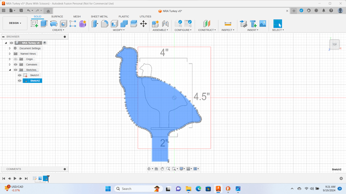

You can’s EXPORT in .dxf in the free version of Fusion. You have to “save as” .dxf in the free version of Fusion. Go to the left sidebar and right click on the sketch and choose “Save as DXF”.
I know this is kind of an old thread, but my luck has seemed to run out.
I can not figure out how to get the drop down menu to have the “Save as DXF” option.
In the above screen shot from @GPow , it shows “sketchs” twice and I know that is key, but I’ll be darned if I get it to have the “2nd Sketch”.

Expand the “Sketches” out in the menu tree on the left. The right click and select “edit sketch”. Once you’re in an active sketch, you can right click on the sketch in the menu tree on the left and select the “save as dxf” function.
What @GPow said is true but even with the tree expanded it may still not show that menu.
There seems to be a glitch with that menu. I just did multiple things but the menu returns when you “Finish the sketch”.
If if doesn’t bring it back, turn the sketch visibility off and then back on. That seems to work. But you need to Finish the sketch first.
Thank you gentlemen.
I “finished” the sketch first then expanded that “sketch” window, and was able to right click and get the “save as DXF” option to appear.

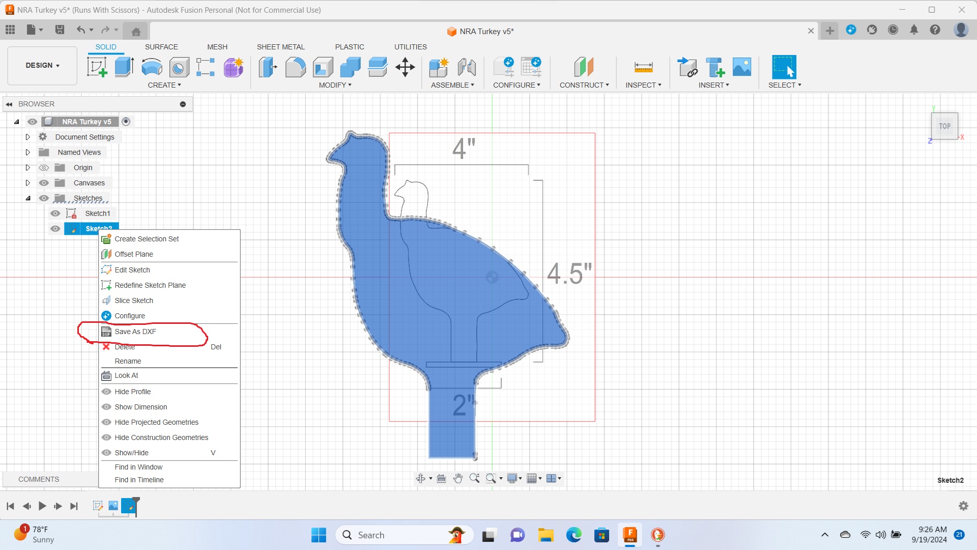

For those as dense as me, here is a visual of what I did.
After I hit “finish sketch” button in the upper RH corner it looked like this.
Then I click on this arrow button I have circled in the upper RH area.
Then it looks like this
Now you can “right click” the bottom “sketch” window to reveal the “save as DXF” option.
like this
But I just wanted to say, it was not you being dense.
I had my file tree expanded with my sketch visible and sometimes I could edit the sketch and not finish it and the menu would appear with a right click. Other times, it was just not there.
