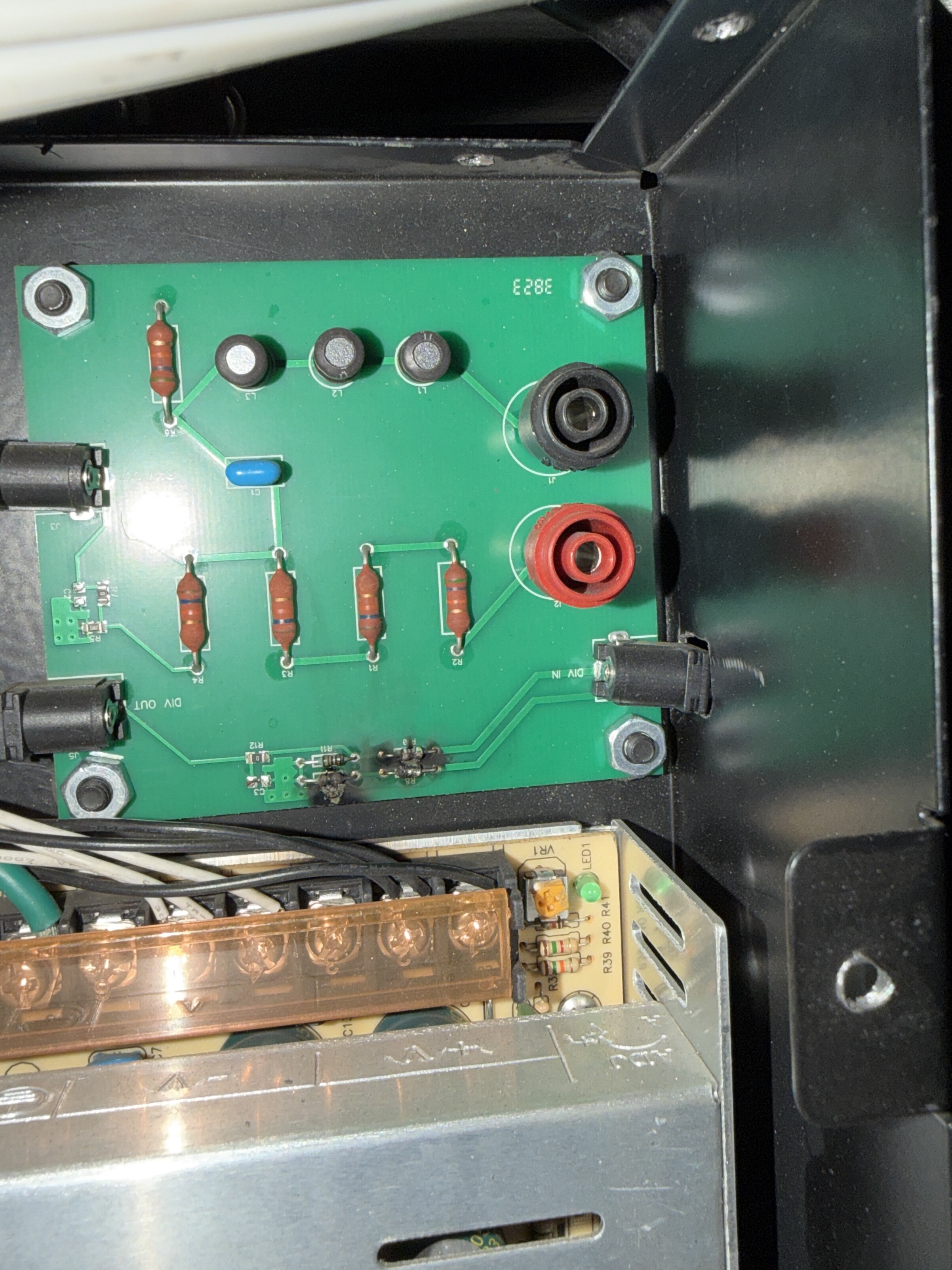

Just received the relay and board for a crossfire pro. I’ve been using this machine for about a year now with no problems, until recently. They sent a board and a relay.
At the bottom of the board the new board is missing a red pice about 2" long. Don’t know what it is. Do I remove the other piece from the old board and reuse it?
That is your THC board and it is a add-on/upgrade to the main. You will have to use the one from your old board
Ok Thanks for the quick response!
how much was the board and relay? I just had my thc fuses blow and seems like it took out the torch on/off relay aswell. hand torch fires manually and relay doesn’t click
