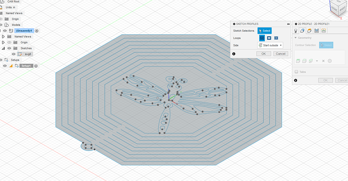

In your example here is what it looks like with the selection:
Once you click “Sketch Profiles” in the drop down menu, a new menu box opens. Don’t do anything with it but make sure the sketch is visible in the file tree on the left:
As soon as you click on the actual sketch, everything is selected:
Now you simply click [OK] in the SKETCH PROFILES menu box. Don’t change any of the other settings. Now continue with the other tabs such as setting center compensation and remove lead-ins and lead-outs.
