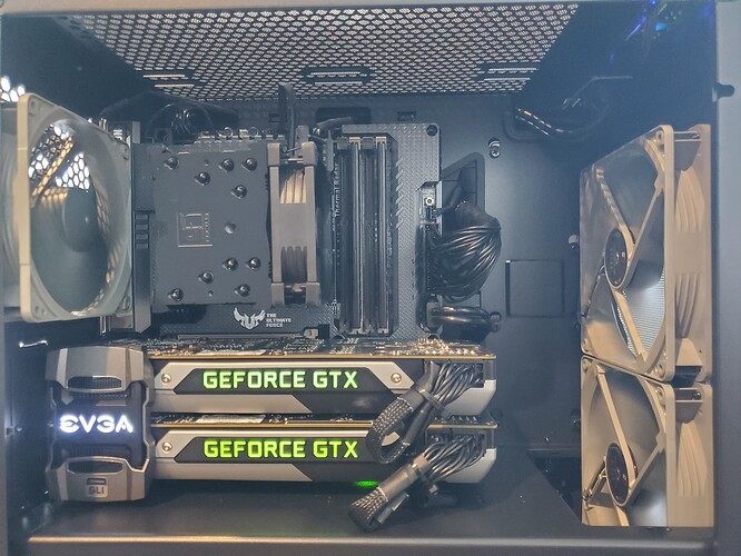

Being a PC gamer/nerd, I’ve got multiple computers I’ve built over the last 18+ years as well as multiple laptops.

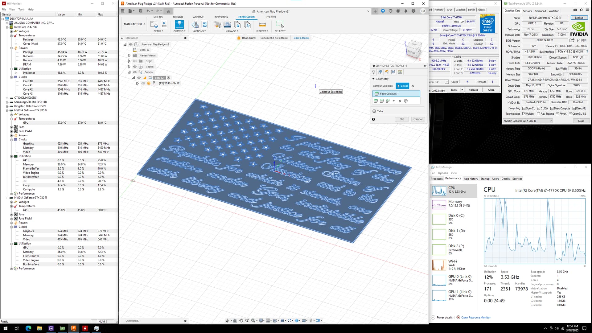

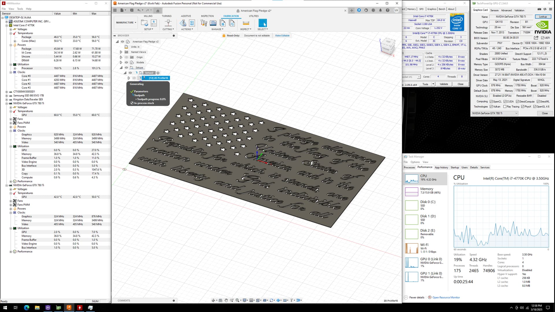

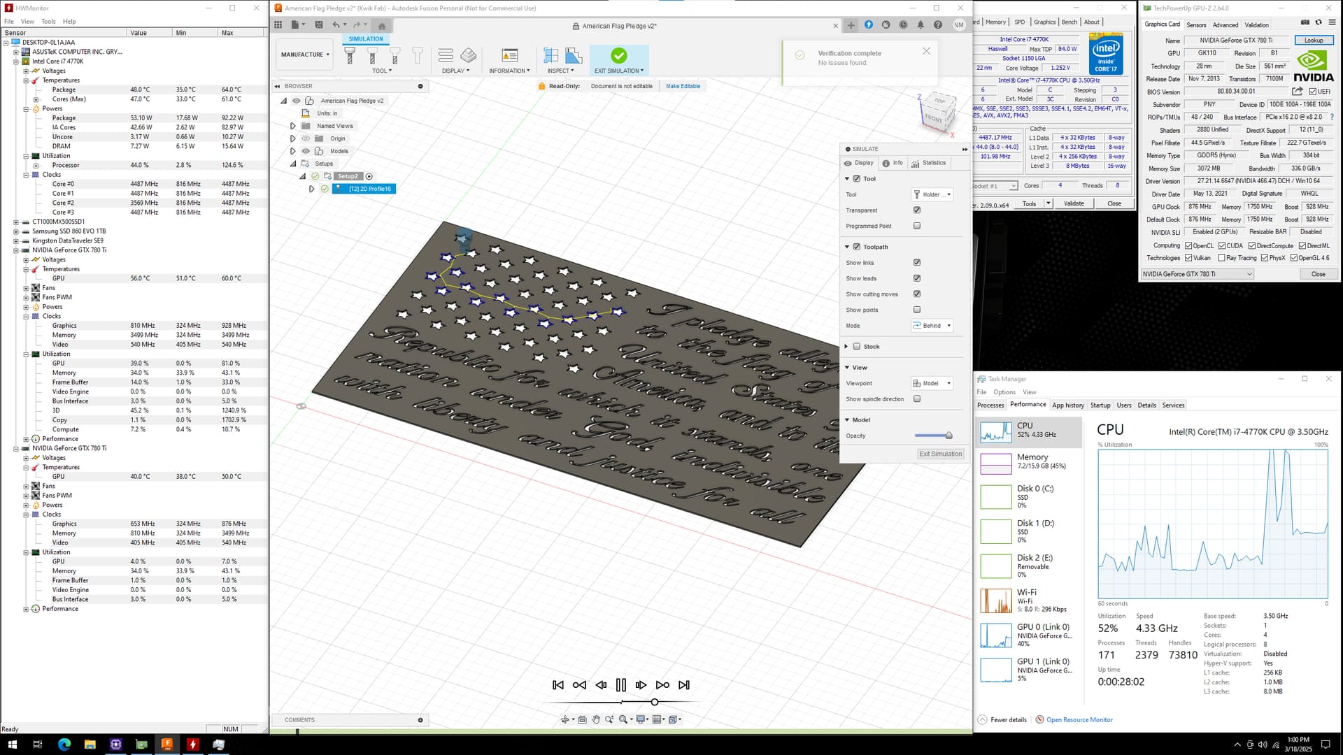

Was talking old computers for a bit with a friend when I decided to try out CAD, CAM, and some simulation of Fusion on my 2013 build.
Had to dust the sucker off since it sits in the closet in the playroom. Was a tad noisy at first too as the dust blew out :rofl:
I did the one thing I advise people not to do, and tried bogging it down by creating my cut paths on this thing using Face Contour.
And for being as old and slow as it is, it only took a mere 2 minutes to complete and open up simulation
All the other windows are simply to display the resources used, operating temps, etc.
The rig is an old 4th Gen Intel running on some old DDR3. Again, this is a build from 2013 but it easily handled the task and plenty more as I sat behind it for a bit doing random work for fun.
So your selling it? I am still looking :rofl:
Just build your own! :rofl:
This rig has no real monetary value! It’s so old.
But it definitely has sentimental value, same with some of my old goodies.
I even swapped out the two GPU’s to see how it ran with just a single Titan even.
That card I got in trade for a tube amp some 11-12 years ago, but in cash it would’ve set me back $1k back then.
The third 780TI used to be in a living room build I used as my “media” PC.

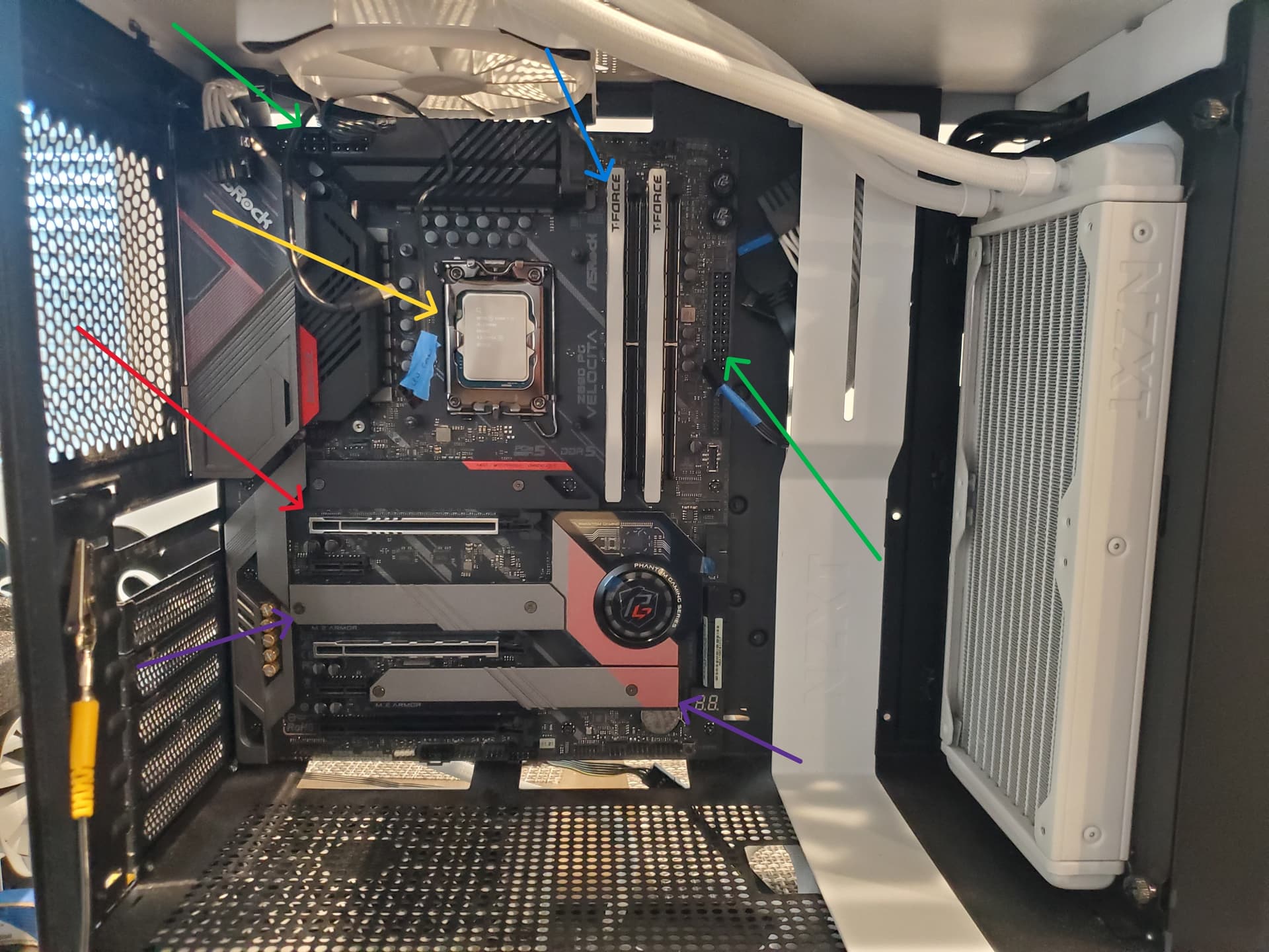

I’ll add a few visuals here using some old pics of my own systems.

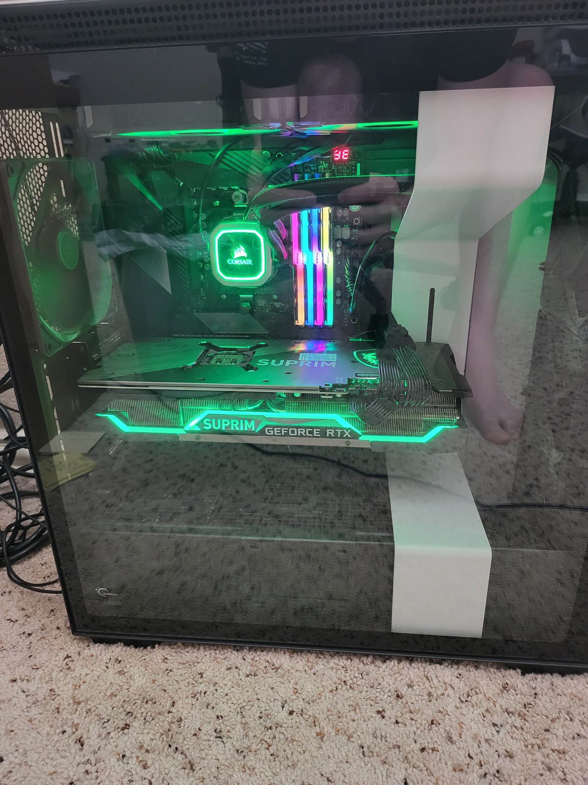

This is my current PC that’s already a good 3 years old.
I used arrows to point out some of the key things that are relevant to know, and that haven’t changed in a long time.
The yellow arrow points to the CPU slot.
The blue arrow to your RAM slots.
The red arrow to your PCI-E slots.
The green on the right is your main 24-pin for power, with the green on top being optional on some motherboards (and a requirement on others) for additional power.
And the purple, are m.2 slots hidden behind those removable heatsinks.

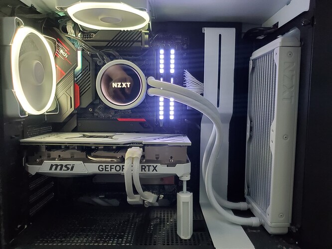

And here it is with all the components in place.

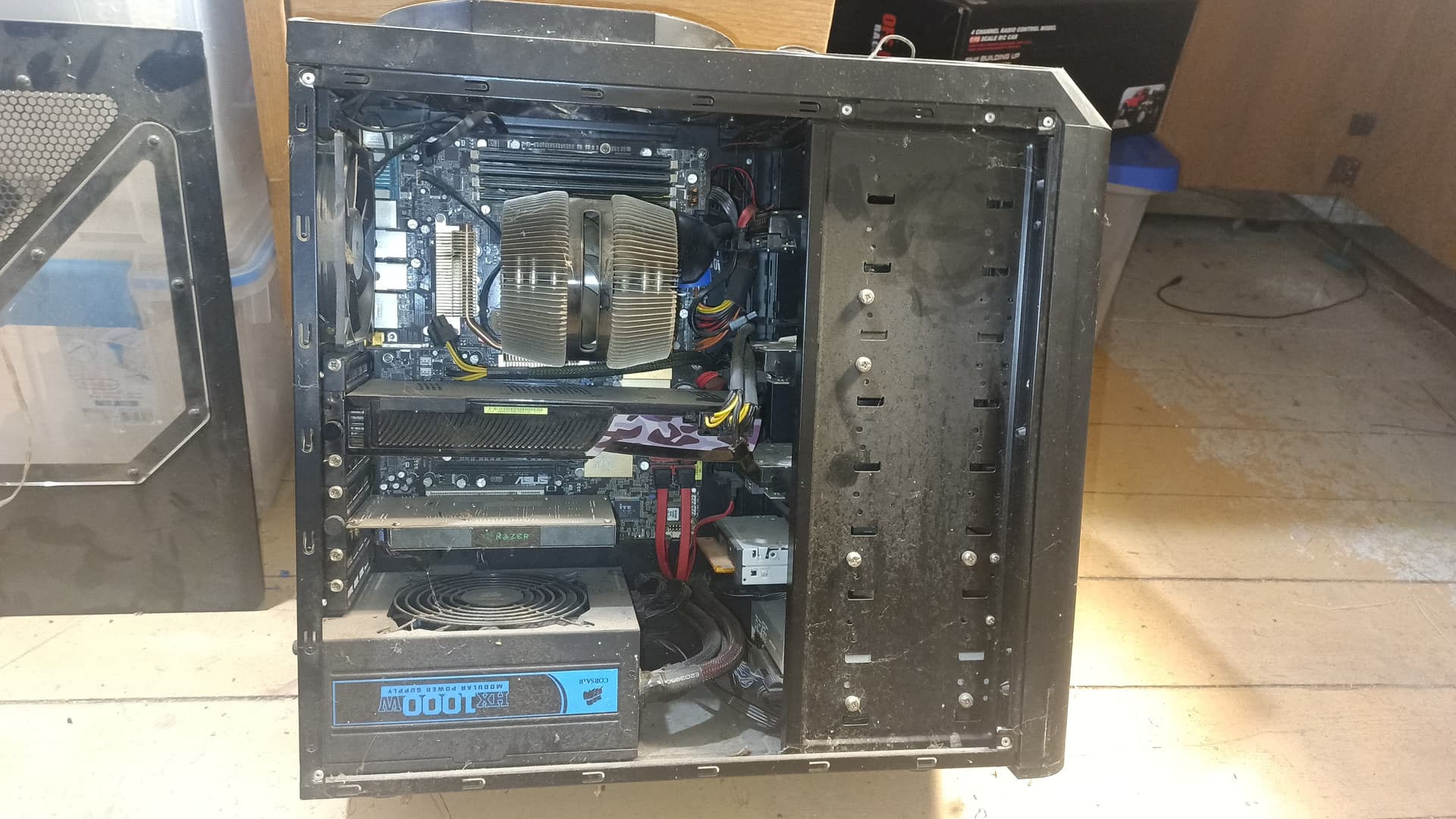

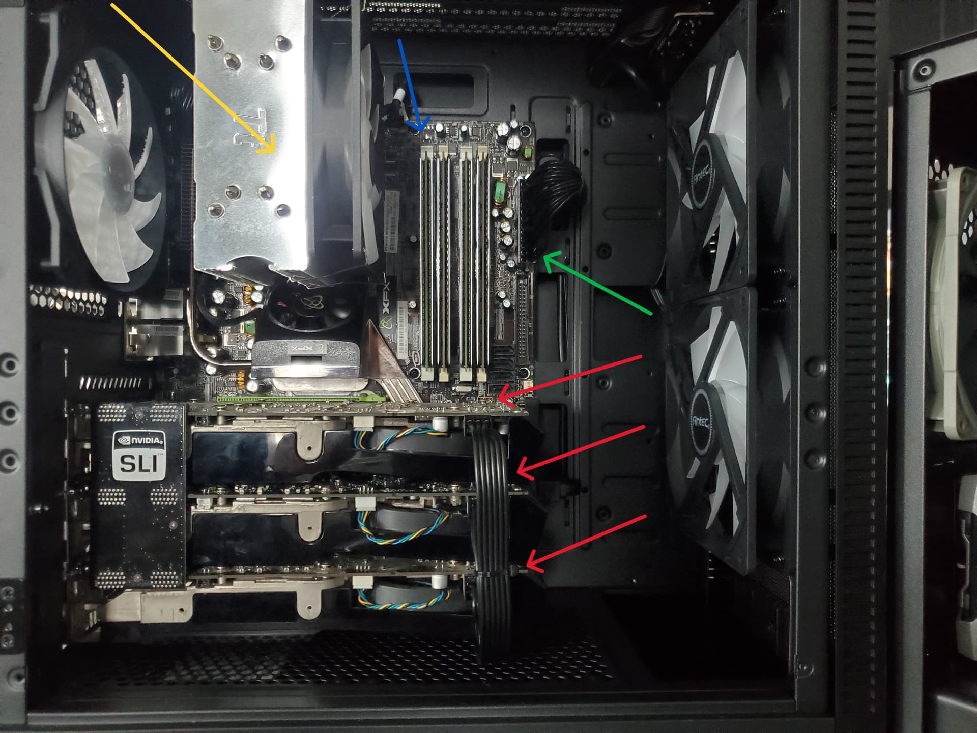

Now, I’m not going to remove the components for pictures but here’s my build from 2008 which you can see is damn near the same. I still own this system and it’s still fully functional.
I even made the necessary changes in the BIOS and cmd to run it off a solid state drive, something this PC was never made to do. Even then, they still used SATA ports for connecting components that are not connected via PCI-E just like modern computers.
The only difference is the architecture is a lot slower, and it’s lacking m.2.

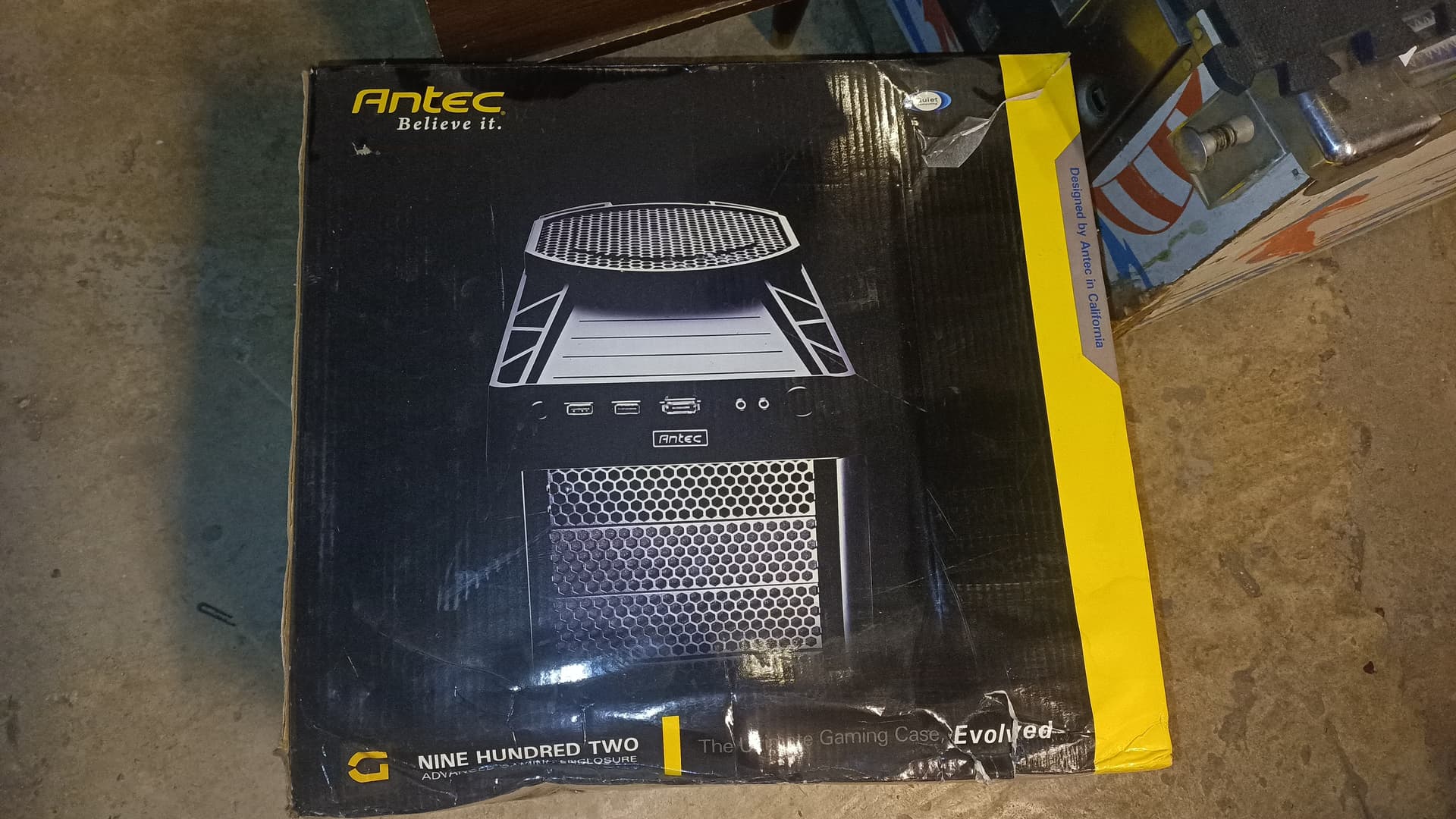

I also loved Antec very much. I still have a NIB extra 902 chassis from 20 years ago. I bought two for a gaming build I did back then.
