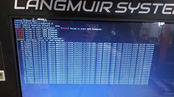

I ran into problem today. Failed to boot up and I got an error of the following:
Has anyone has this issue, and if so, what is the solution. Screen show below

Failed to start cups scheduler
Dependency failed for cups scheduler

To fix your boot up problems, you will need to re-install the latest update of bendcontrol onto your machine.
If it does not work, you can use your own SD card as long as it has 60GB memory and 100MB/s read speed. Alternatively, if you cannot complete the above process or it does not work for whatever reason, let me know at support@langmuirsystems.com and I can get a new SD card with the program pre-etched to your location so you can just plug it in to work.

Uploaded as per instructions…boots up, looks good so far. Will work with it tomorrow.
