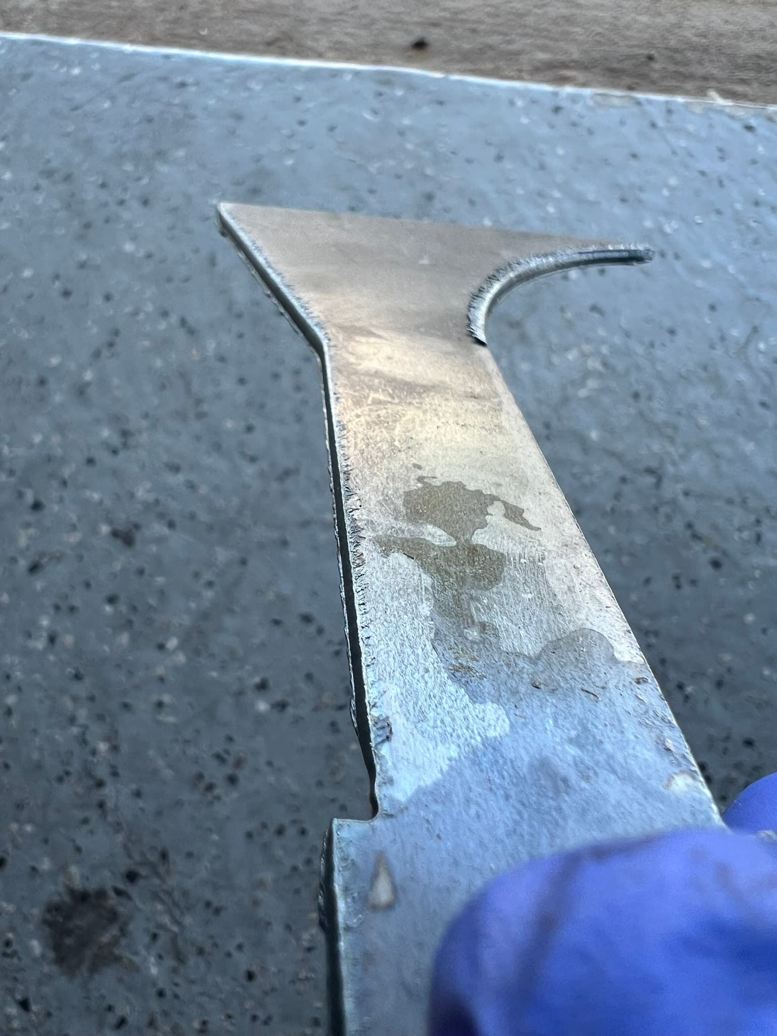

At my wit’s end trying to diagnose a host of issues with my Crossfire.
The main issues I’m having right now are tons of bevel, THC lifting until I lose the torch, and random software issues that give me intermittent issues. It’s quite possible all issues are related.
Using CrossFire with an XL kit, Hypertherm Powermax 45XP, machine torch, all settings are book settings from Hypertherm.
Bevel: When cutting any thickness of mild steel I get a ton of positive bevel (wider on bottom of cut) all the way around. The effect gets worse the thicker I go. This photo is 16ga mild steel. I’ve changed consumables with no effect. I’ve squared the machine three or four times. Settings are per the Hypertherm book (249"/min). THC Voltage is on Smart Voltage. Live voltage shows it desiring and achieving roughly 45V throughout the cut. If I attempt to enter the book settings of 128V, the Z axis will rise until the arc is lost. Which leads to…
THC: The THC seems to work as it should with the following exception: the voltages indicated by FireControl seem to be way too low compared to what the Hypertherm book says they should be. The “Live voltage” at the start of a cut are usually about 1/3-1/2 what the book says they should be, forcing me to use Smart voltage all the time. If I enter any of the recommended voltages the torch will rise until the arc is lost. I’ve troubleshot per the Langmuir flowchart and get roughly 2.8-3.0V out of the 50:1 divided output from the Hypertherm directly and about 70% of those values through the VIM box. I’ve attempted to run the THC health check but it will not function. When I get to the Live Voltage test, the arc will fire but the “Arc is On” button does not function. Eventually it will time out, turn off the torch, and tell me “You didn’t click the ‘Arc is On’ button.” I’ve re-tried 6-8 times with no success.
Software Issues: In addition to the THC health check issues, I will randomly get a “hanging” jog when moving the torch around the table. This is when the movement settings are on “continuous”. The torch will continue to move even after I let go of the direction arrow until it runs into a hard stop. This happens randomly and cannot be stopped when it starts going on its own. This only seems to happen when running a bluetooth controller to move the torch.

Your bevel all the way around the perimeter of your cut that is wider on the bottom that the top is going to be your cut height.
Quick and dirty way to do it is go through and have it start doing it cut, stop it mid cut, take some feeler gauges and measure the gap between your material and the torch tip. Should be .06”
Try turning THC off and doing a cut that way and see if it continues all the way around and then you can watch the grayed out voltage readings as it cuts.

And are you using smartvoltage or nominal? As another member mentioned, if that bevel is even all around that does indeed scream cut height. But it can also be attributed partially to cut speed as well. Knowing if you’re running smart or nominal is important in this statement as even Hypertherm engineers will state that if you use nominal, you should always perform a test cut on every new sheet of steel as it will not always be the same (even if both sheets are of the same thickness). Metal content can actually change that slightly.
