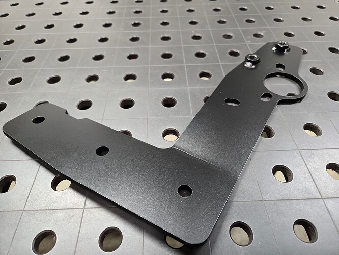

I just changed the picture from the original one as well as I realized my mistake on the first one.

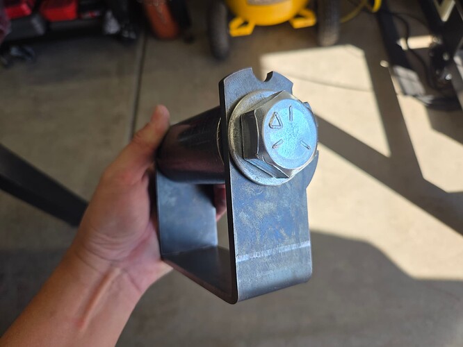

Thanks again gentlemen( if I am mistaken I apologize), I took your advice and went in to the holes settings and then when down a rabbit hole on searches about plasma holes. you all definitely got me going in the right direction and showed me where it was on the map, and I think I am getting some good clean holes now. this is off the table hit with a wire brush, the Motorgaurd filter helped as well.
Those look gorgeous, how accurate are they? This machine amazes me at its reproducible accuracy after dialing your settings in.
I needed 3/8 holes and I did a test set up with three different sizes .375, .38, and I can’t recall the last one. the one set at .38 slips right in snuggly. the one cut at .375 could fit if I filed it a little bit but .005 extra seems perfect. For 14 gauge the 60% slow down seems just right, for 1/4" I am going to slow it down to 40 or 50 as recommended by some folks. Sheetcam is totally worth the $150 just for the tweaks, I have no idea if this can be done in Fusion 360 as I abandoned it for post as I found Sheetcam a much more intuitive solution. And I have just started to understand what I can do. The is a reason it has been around forever I am guessing.
