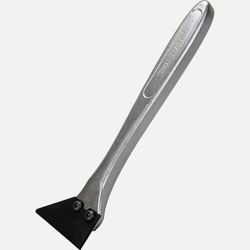

This is expensive @ $87. This thing is terrific. It is made of heavy stainless steel and tool steel. I have had mine for a year or so and am still on the original blade.
Fireball tool website under hand tools.Specialty Tools
