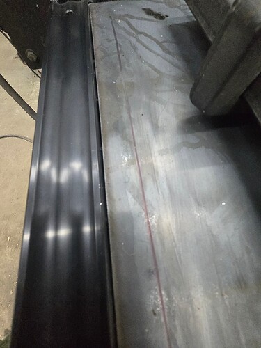

Think I’ve finally started to wear out my table. Been fighting a curve on my x axis for a bit. This is an OG crossfire Xl with the updated box and thc. Been running a 4’ y axis for a couple years with no issues on that. But the X has been getting a curve about 1/3 of the way in. Ive played with bearings, drag chain, etc with no luck.

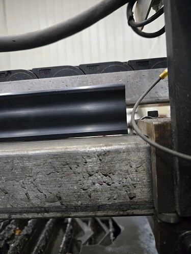

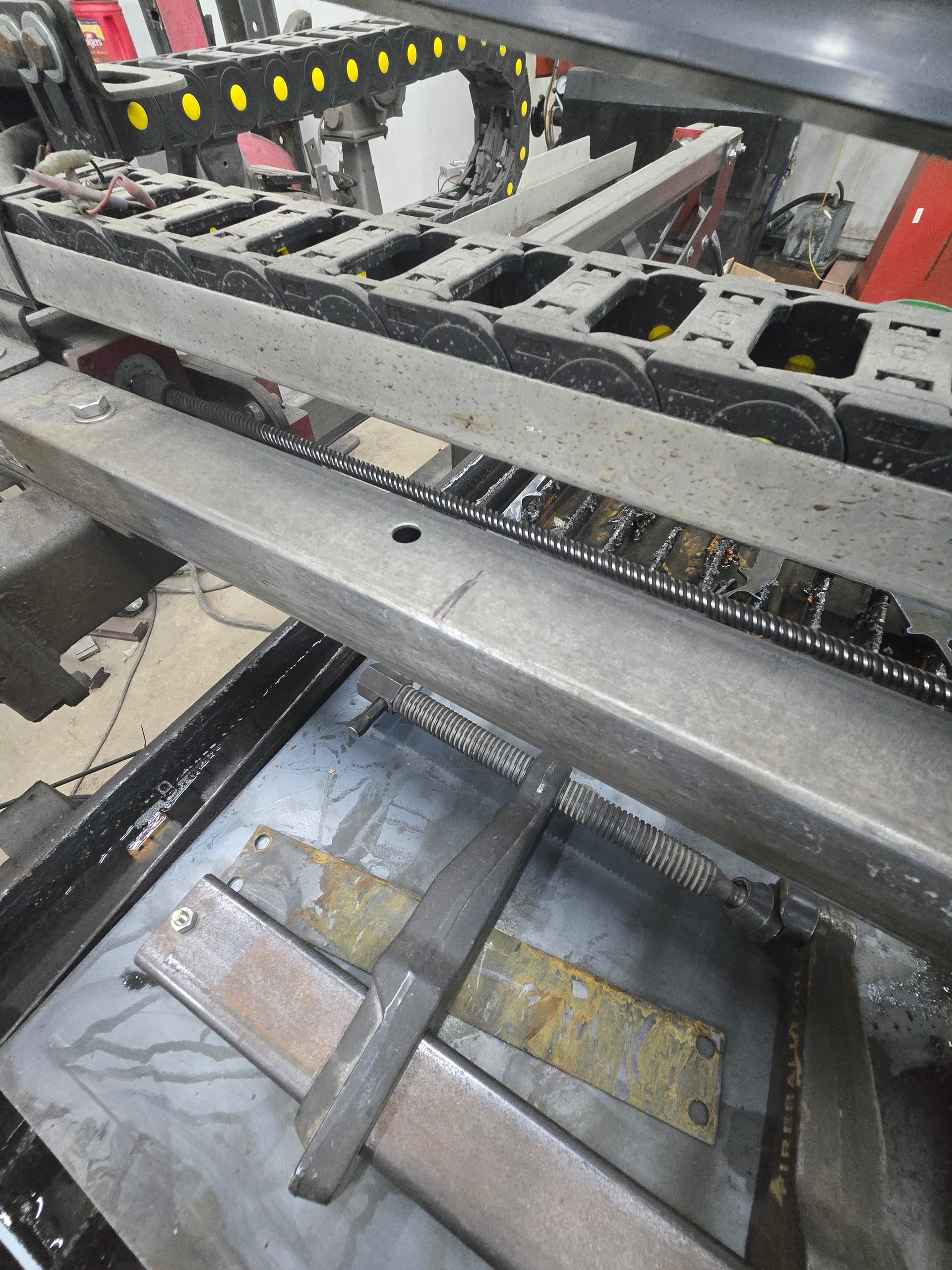

Think I finally figured it out. My x tube is bending down shortly after the gusset. A straight edge on the top shows a high spot and a gap on the bottom. I think this lifts the roller bearings when they go over it. This pushes the bottom of the torch Y+. It’s the only thing I can find out of spec. Anyone else run into this? This thing has run every couple days for the last 6 years. I guess I either need to replace the tube or just pull the trigger on a bigger table :rofl:
The high spot is the sharpie mark
