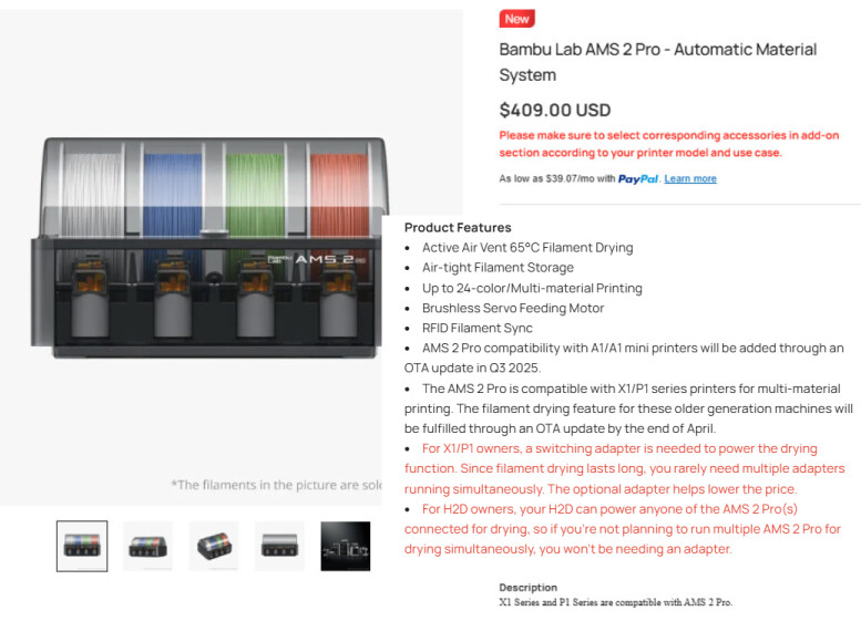

The AMS2 is brand new and actually has additional power going to it with some sort of heating/drying element in the unit to actively dry and keep the filament dry. With the new R2D printer, there exist one plug receptacle (120 v) for one AMS2. For any other printer or for additional AMS2 units added to the R2D they include a 110 plug/adapter for this added power consumption.

Just a thought: If you are considering the AMS2 unit, something to consider. Yes it does have a much better design overall than the original AMS (easier to work on and trouble shoot and dries filament) but the drying feature only works when you are not printing. So for hours, the AMS is not available.

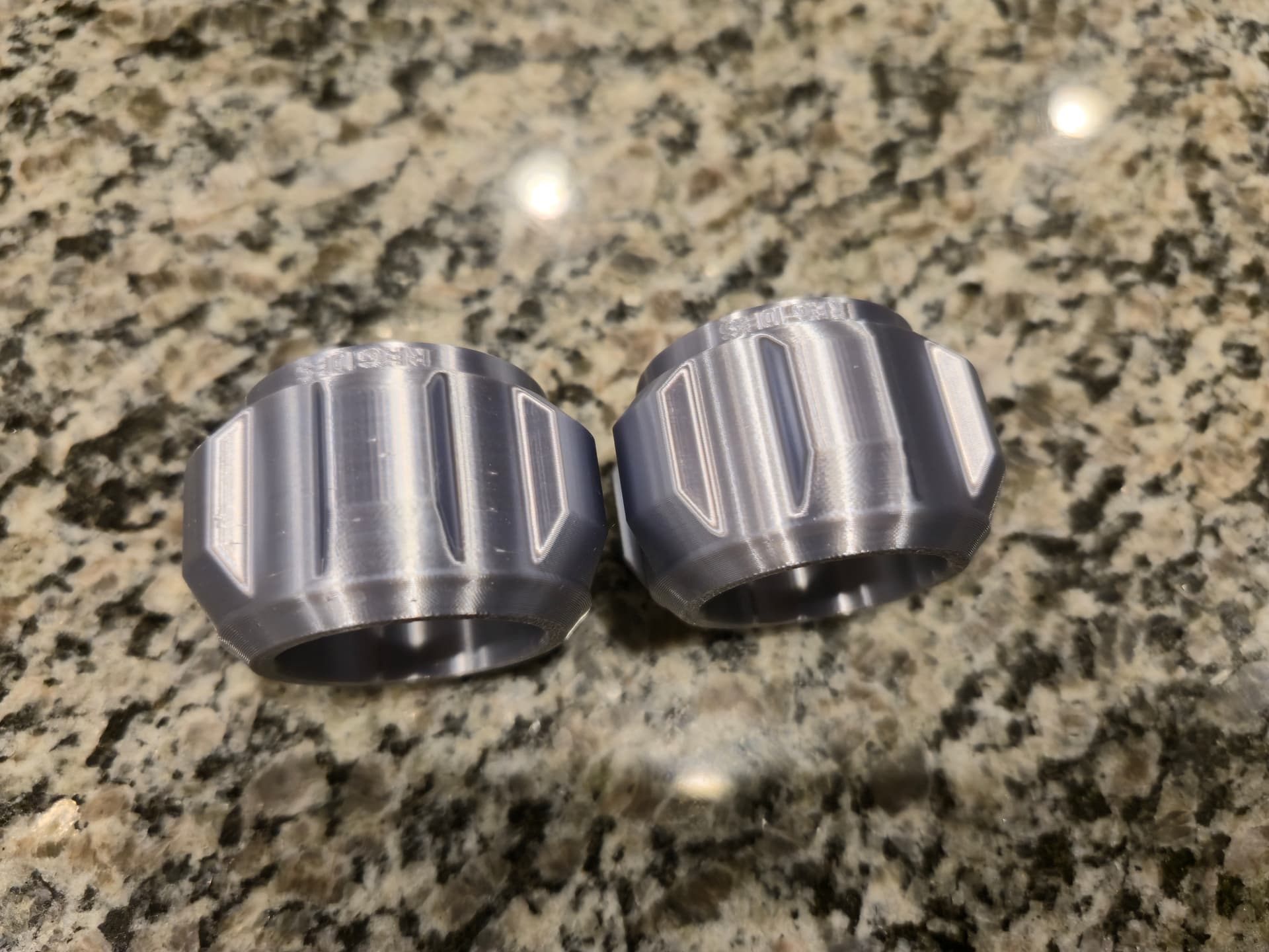

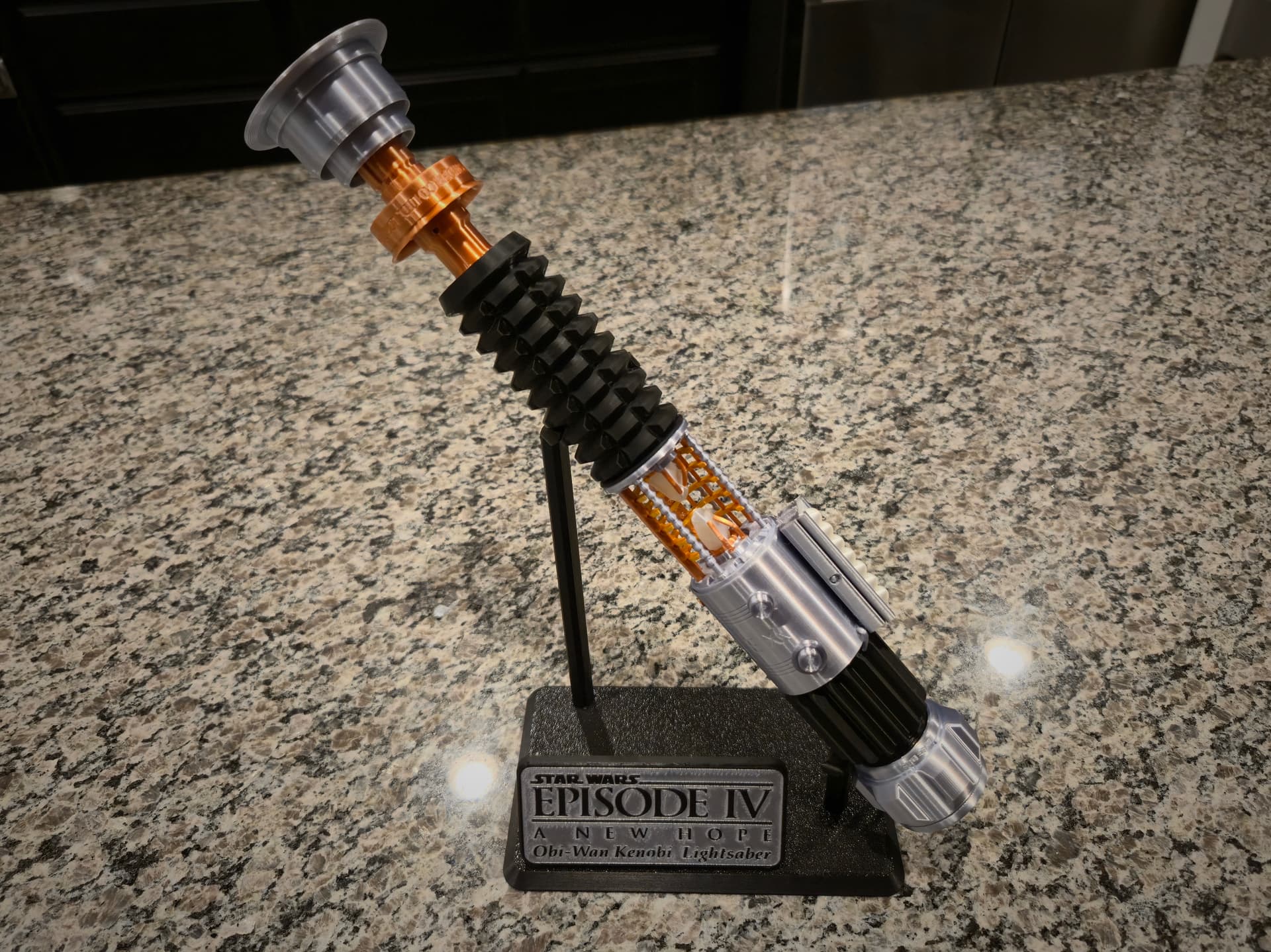

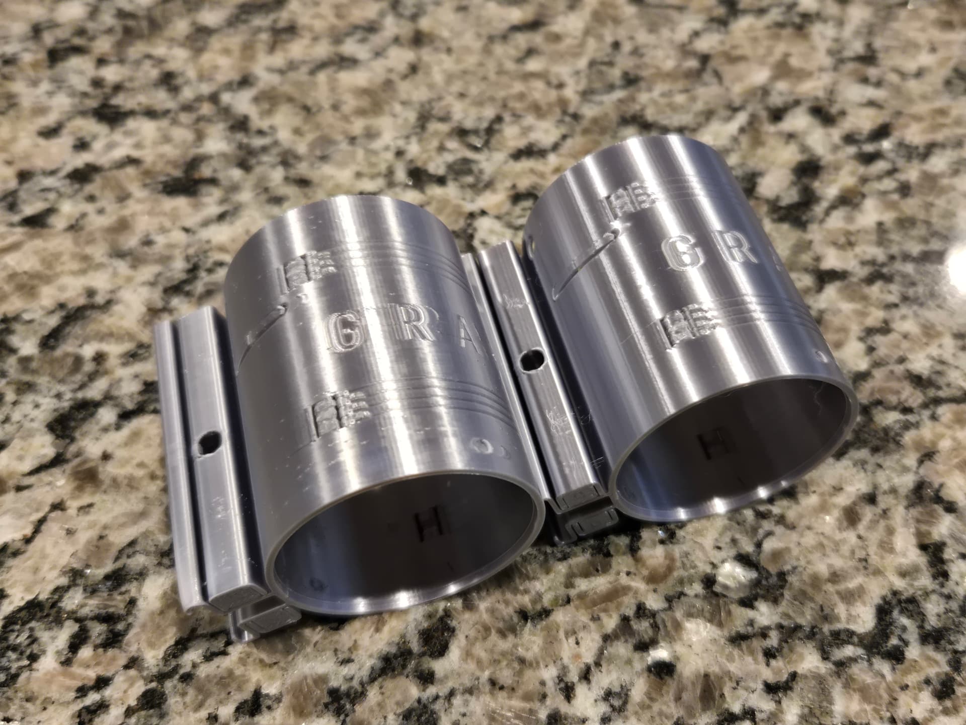

When I printed my lightsaber recently using silk PLA, I noticed a few defects in my newly acquired filaments. I just assumed right off the bat that it was moisture causing for the ugly defects and only after 2 hours of drying at 50c, the prints looked significantly better.
The end result
