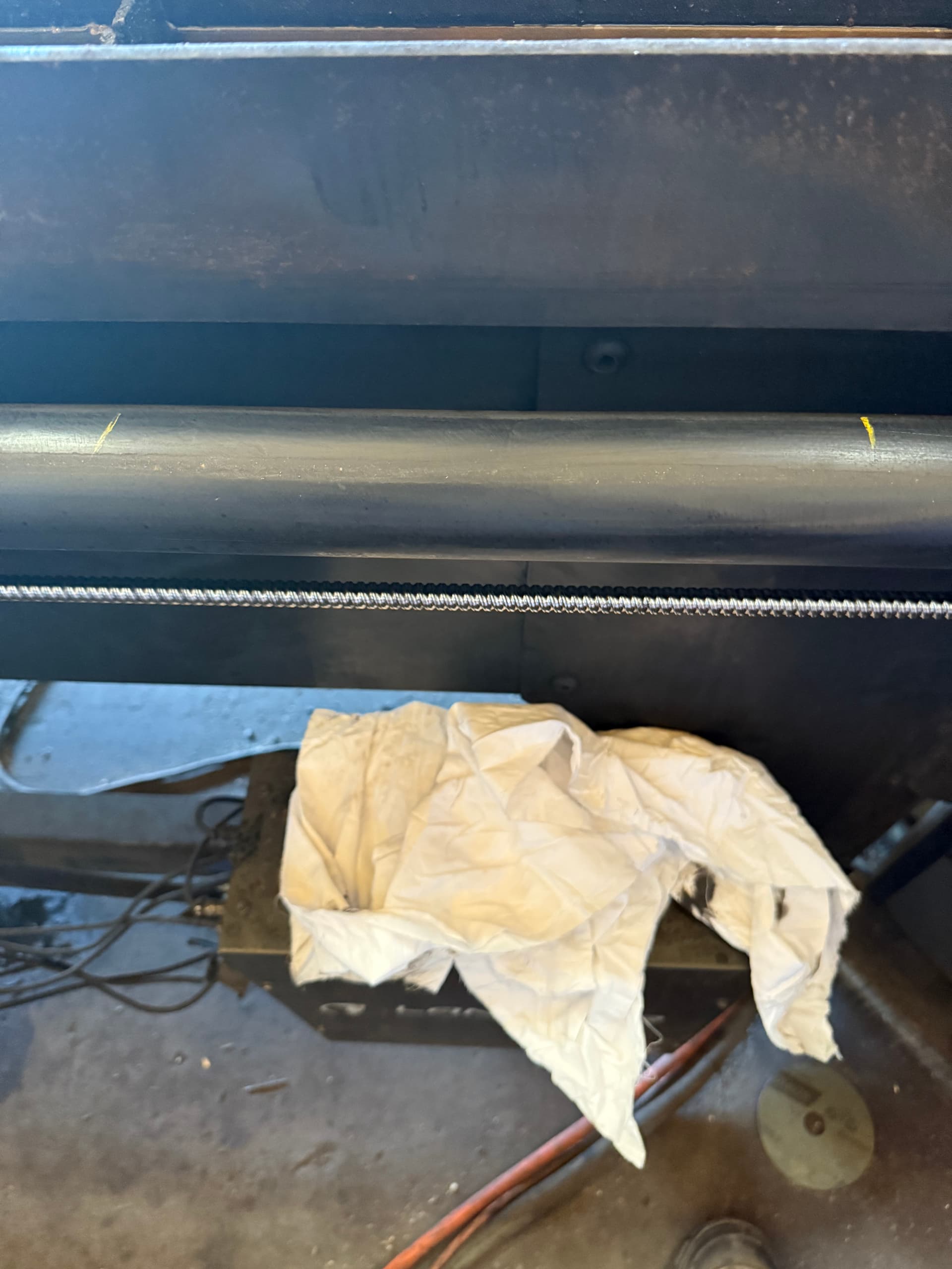

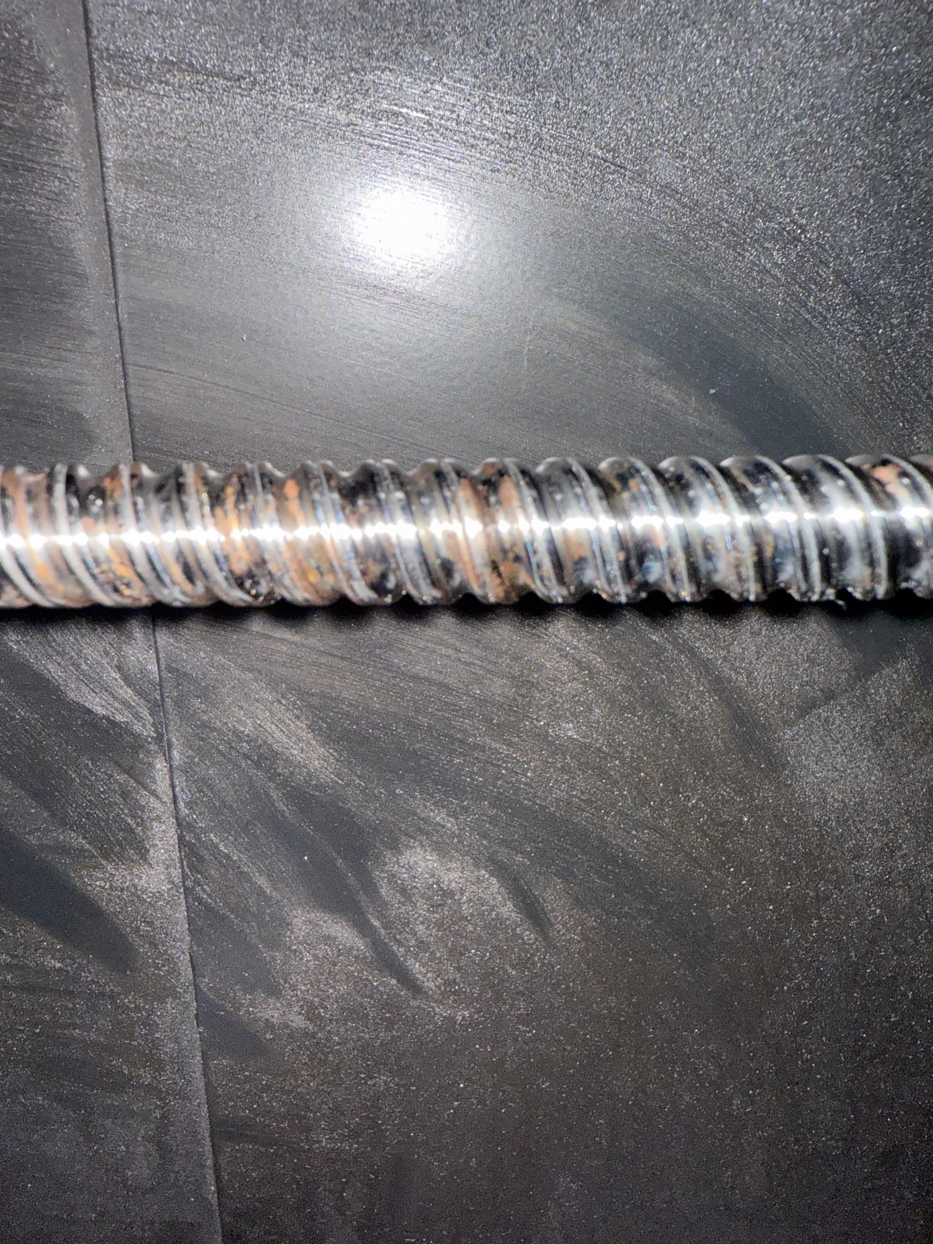

So, i had recent binding in the lower part of Y1 Ball Screw Rail area, Im trying to figure out what’s happening and why the machine is binding up in just that one spot. I recently had the ball screw assembly replaced due to the tiny screws holding the plastic cap rusting out on itself. I also noticed a lot of gunk slug stuff inside the ball screw area. That had caused the tiny little balls to spill out. Once we replaced the Ball screw part I noticed only 5~6 balls were in the housing. Any recommend idea on how to resolve this issue.
Looks like rust to me? Is there any lube on the ball screw?
You need to protect the screw / add lubricant. CRC makes a nice spray on graphite dry lube (good for keeping “weld spatter” at bay), but it doesn’t do much to help “fill the gaps” that can cause backlash. Super Lube Silicone is what I add to the linear bearings of my 3d printer, been meaning to but haven’t gotten around to trying it yet.

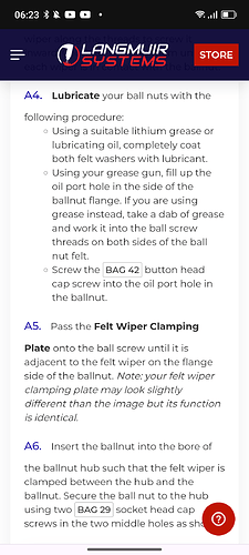

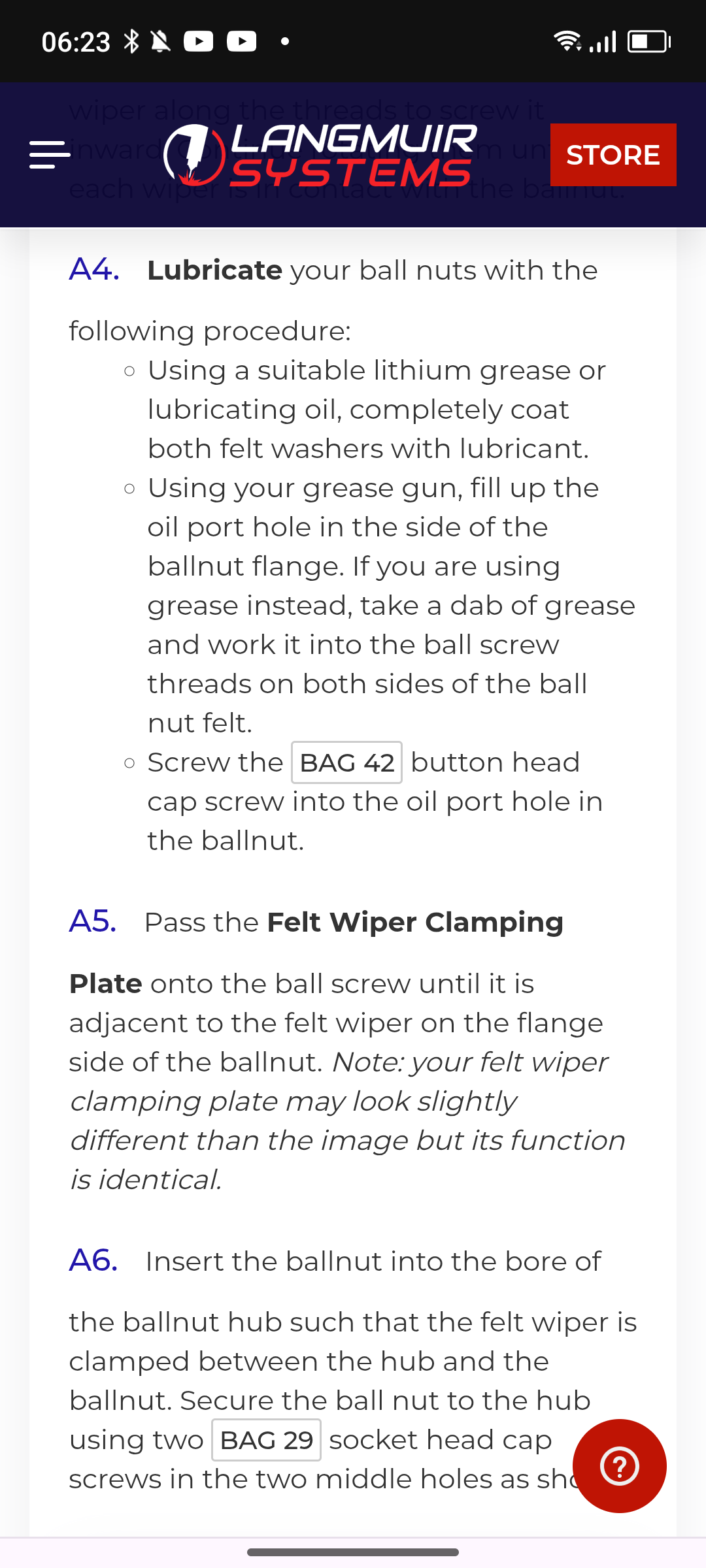

Are the felt wipers and lube cap installed on your machine?
In the instructions it discuss the port being filled, capped and felt wipers been fully saturated . Was this done?

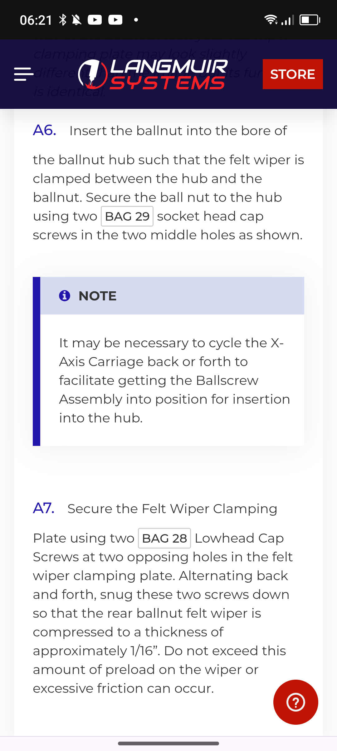

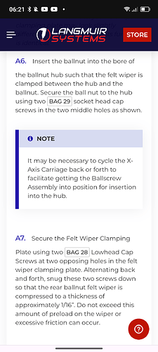

The Felt Wipes are saturated, and the fill spot is also lubricated with WD-40 Lithium Grease Spray. As I check the inside felt wiper the front (Outside) Felt wipe completely ripped in half with the small tug pressure. I can only assume that the screws were too tight on the assembly forcing the wiper to get caught up into the ball screw spot.
