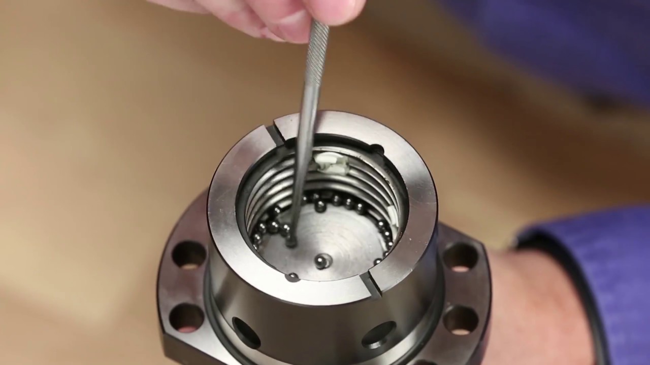

Question: I ran my ball nuts past the end of the screw. Is it possible to put the balls back in the nuts?

Now if I had removed the end screws in the ball screws at the front of the machine, I could have avoided what happened next. I pulled the gantry to the absolute end of the travel, exposing the end stops… and running the ball nuts off the screws. I immediately ran the screws back in to the nuts, but this pushed out a bunch of balls. I saved the balls separately for each motor as grease kept them clumped together. Is it possible to put them back?

Here’s a YouTube video putting balls in an assembly like that.
It isn’t a langmuir specific video but it is a ball screw specific video.
Perfect that looks pretty doable. Not the disaster I was worried it will be. (Would have been worse if I hadn’t already greased them, as balls could have fallen on the floor). Thank you!

Okay I had complete success! I replaced all balls and everything moves smoothly and tight like it should. I got the machine fully assembled and have done the full motion break in and some test cuts and everything looks great.
All you have to do is strip down this end of the ball nut, including removing the recirculator, insert all the balls in to the groove, reinsert the recirculator, secure everything back on the nut and you are good to go! Note that the recirculator has a tab that fits in to the screw so you have to have the screw down in the nut just below the recirculator to get it in or out. By the way you must remove the recirculator because it blocks the balls going in to the screw path. That was one difference from the above YouTube video.
