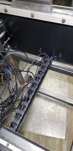

Finally getting around to finishing the wire routing, and I just can’t understand why the cable track extends out the back on the machine 8 inches? The igus cable track is attached half way in the trough instead in the end of the trough where is should be. This makes no sense to me, so I fixed it by drilling new holes in the end of the igus trough, and removing 4 links of the igus cable track - now it’s flush with the end of the machine and works perfectly. Was my cable track an anomaly or has anyone else had this issue?
flush and finished
I did the same thing as i wanted it closer to the wall, i couldnt see any neg effects of doing it.
