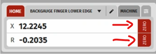

Calibration
Once you have your backgauge squared up, you will want to calibrate a centerline.
  1. Home the machine.
  2. Jog the backgauge to a reference line using one of two methods:
    a. Eyeball the centerline of the die you are using, and bring the fingers just above
    the die and on the centerline. Then hit Zero on the coordinate positions to mark
    that point as the origin point for your reference frame.
    b. Touch off the finger tips on the die, then type into the X axis coordinate half the
    value of the die’s width. (ex, 1.181” for the 4-way die), and then jog the machine
    upwards to your desired basline vertical position and hit Zero on the coordinate
    position.
