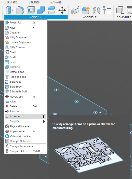

In the paid version there is ā€œArrangeā€; otherwise you are looking at manually moving parts around.

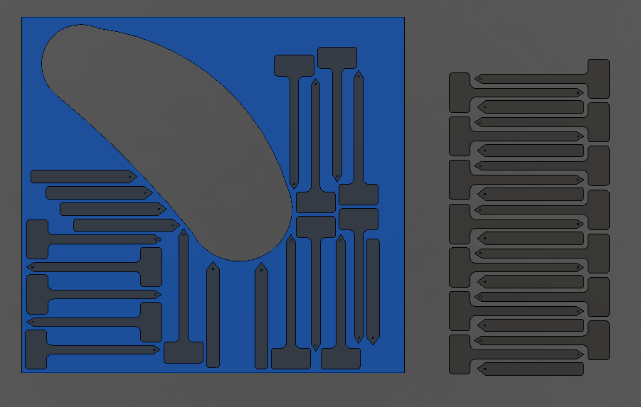

I used deepnest.io just to see how it would do with this. These were label garden stakes that I have cut out hundreds of them with this exact layout:

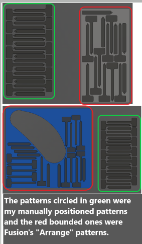

I was not impressed with how deepnest arranged them. But right now I just did it with Fusion 360 arrange feature and it did not seem to like how close my components were so it spread them out. I am not too impressed with this specific demonstration as it used the same amount of metal and dropped off about 6 of the the stakes. I have seen other demonstrations that made it seem worth the effort.
I am on a paid version of F360. Perfict. Had no idea that feature was there.

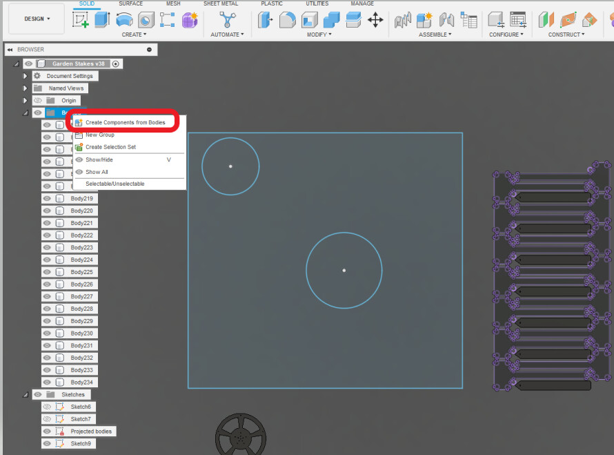

Two things: You will easily figure out both but…
  1. Every body needs to be a component to use arrange (right click on the browser at the top of the bodies and select ā€œCreate Components from bodiesā€ if need be),
  2. You will want to create a body that represents the ā€œenvelopeā€ that you will select to show Fusion 360 the space you have to work with. The ā€˜envelope’ body does not need to be a component.

Looks like you could squeeze more into that space. I’d move the group on the right over closer to the edge. Probably can tighten up the space between the items. On the bottom, move the first plain stake to the right and then shift the ā€œheadedā€ stakes where the head is in the right over. That will let you drop the right facing ones down to where their stalks are tighter with the left pointing ones. Then move the plain stakes down and to the right and you can add more if them in a vertical orientation on the side.
That would take just a minute or so. The plain stakes (no ā€œheadsā€) make great filler pieces.

Agreed. Just to be clear:
Just goes to show that humans still have a better spatial sense than AI or programming. Both Arrange and deep est are sub-optimal. I haven’t used Arrange but deepnest always takes longer to turn out a lesser option than I can do manually. I think it’s because it has to try options I don’t even consciously consider because I know they’re not the best.
It’s possible that with enough time the automated processes could provide a better result than I could, but I’m not willing to waste the time waiting. I can usually have my solution and be cutting before deepnest provides a solution.
The other thing I can do is add things (like more plain stakes) because there’s room where the automated processes are constrained to only manipulating the objects they start with.

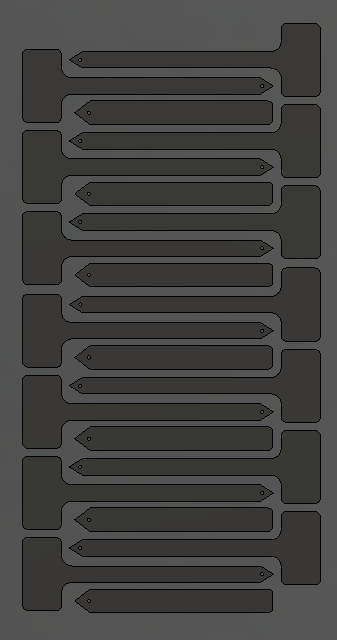

That is exactly what happened with those stakes. My first cutting was without the simple tongue depressor shaped stakes and had all this wasted space. I thought, I could make use of that space. It might cost a bit more metal but lots more useable stakes.
