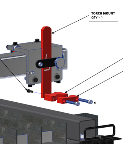

Maybe I’m just not looking in the right place, but are there any instruction form Langmuir on the correct way to install the plasma torch to the Crossfire table?
The system I purchased has the Z-Axis , IHS and THC. I’ll be using a Razorweld Cut 45 with a standard manual torch.
The table comes with this bracket for mounting the hand torch. It clamps on to the retaining cap:
Remember not to use any drag shield with the hand torch:
Dragshield
If you have a machine torch, you need to purchase or make a different holder such as this:
Here is the one sold by Langmuir:
When mounting the machine torch, you want to avoid clamping on the head of the torch:
Picture edited as there is some question about the Duramax mounting.
Thank you, but what I’m looking for is some direction on the set up.
I.e., Should the Z-axis be pre-positioned at the top or bottom or middle of the movement range?
Is there a recommended distance from the underside of the Z-axis trolley to the contact point on the torch?
How do I set up the Crossfire Z-axis control to know where the torch contact tip is positioned?
This strap affords lots of flexibility once the torch is mounted:
Once mounted, you want the tip of the torch for the lowest point, to be able to touch the slat of the water bed but not necessarily lower.
You might be over thinking it. Run the z-axis carriage to lowest point, then mount the torch mount and eyeball the torch in the torch mount.
You want the Z axis to have about 1/2" to 3/4" of travel left when the torch contacts the metal.
This is essential for the initial height sensing to work properly. If the Z axis bottoms out before the torch touches the metal, the initial height sensing switch will open too early and cause torch height issues.
