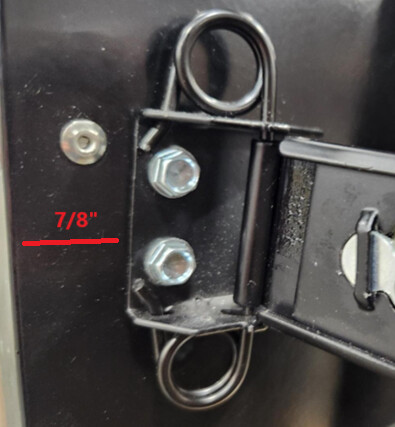

Then we went to mount the locks on the right hand frame. Instructions say “Secure the latch on the sidewall using the provided pilot holes with the fasteners shown.” Problem. No holes. Has anyone else experienced the missing holds for the locks?
Make sure the gasket is mounted to the door first. No, mine did not have holes in the door. After the gasket is installed, you can lay them out.
The latches don’t have much release travel, so make sure before you drill. If you do it before the gasket it will be hard to open the door.
PM me if you have any others.
Hi ssquared14. Thanks for the feedback. I am working with the lead engineer to get some updates to the guide. We already have some of the changes in a draft form - we just need to get them pushed to the website. Keep the feedback coming. Either here or on our other email chain.
We are aware the holes are not on the side of the walls and are updating the guide to reflect that.
The latch should be located approximately 7/8” from the edge of the side wall.

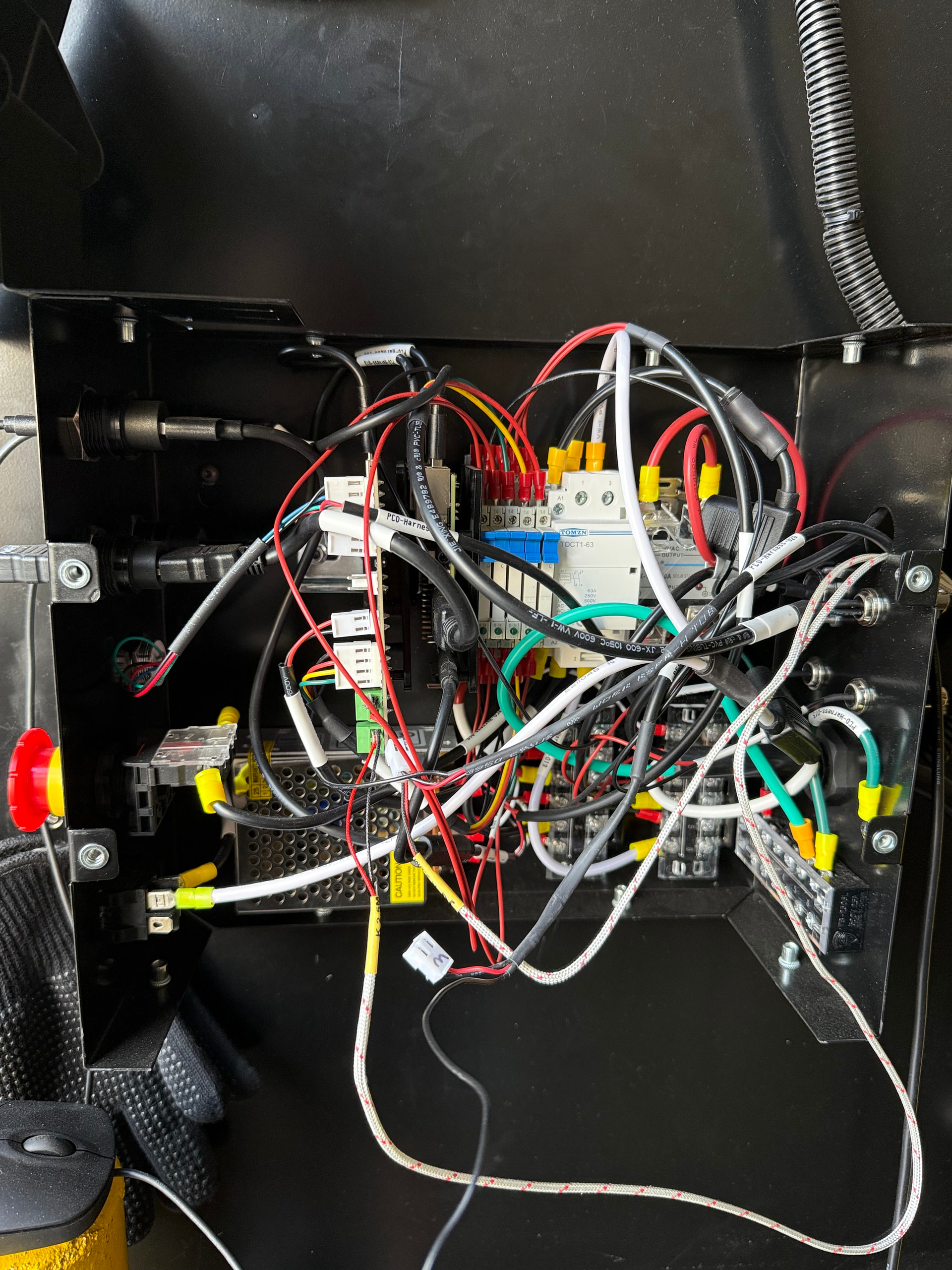

Can anyone send me pictures of the internal
wiring of the pro electronics kit. these instructions on assy
just don’t help me Thanks
Here is in inside of the pre-assembled replacement they sent me. It’s a mess (i know) my first one I had it all nice and organized. Also note my door switch is unplugged on purpose.
