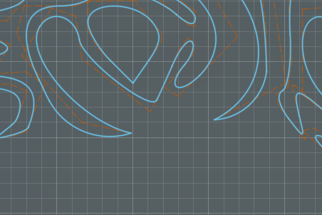

Here is what I did on the “S”
Original:
Added arcs:
Deleted what I didn’t want:

That image is far from being ready because there are other elements that require some support/bridging. Just looking at that “S” that I bridged, this highlighted piece is just going to fall out or likely not be cut at all:
This would be one way to deal with that spot. Arcs added:
Line segments trimmed:
Done:
By adding another detail you could de-emphasize the blob I created:
