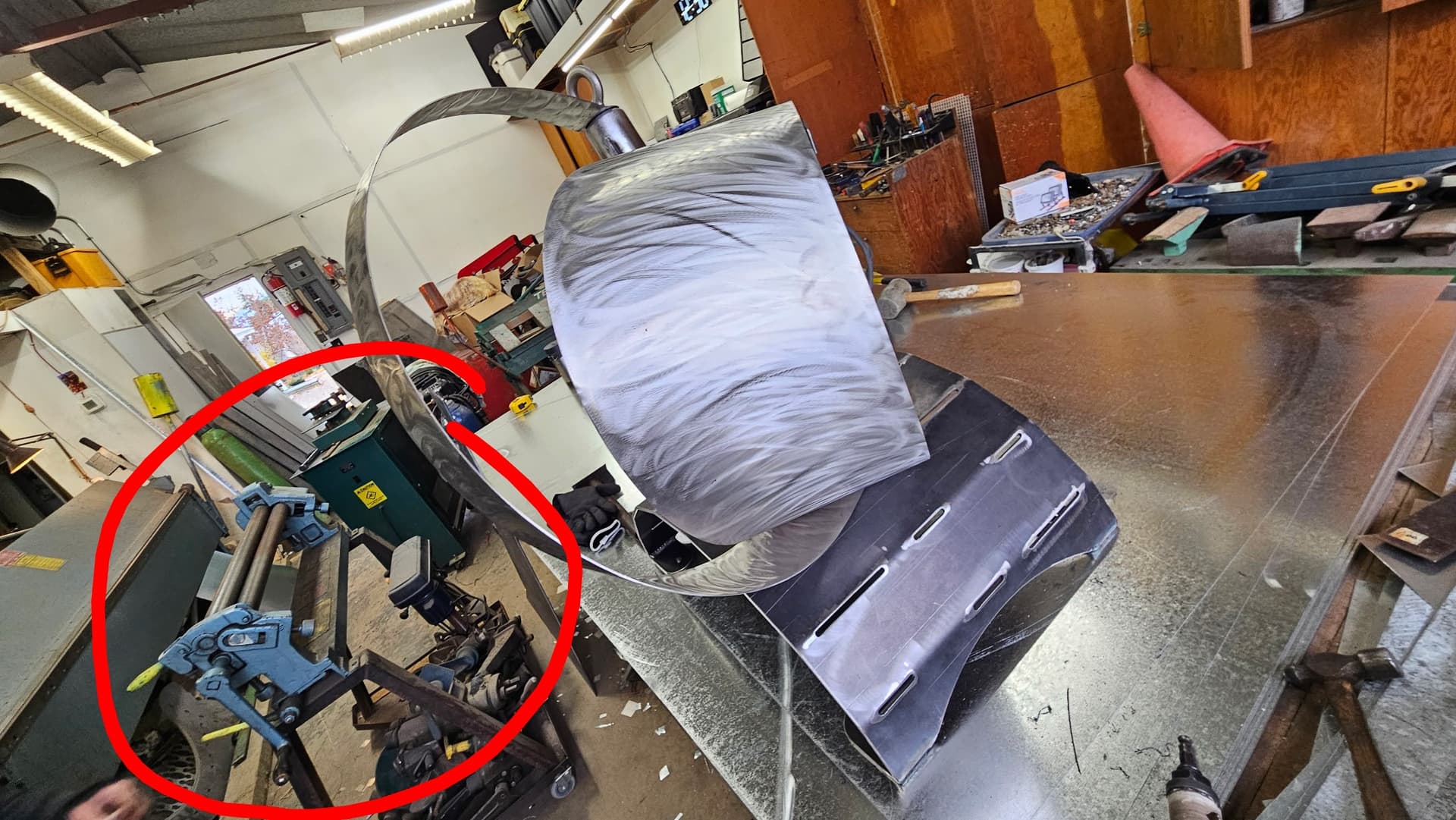

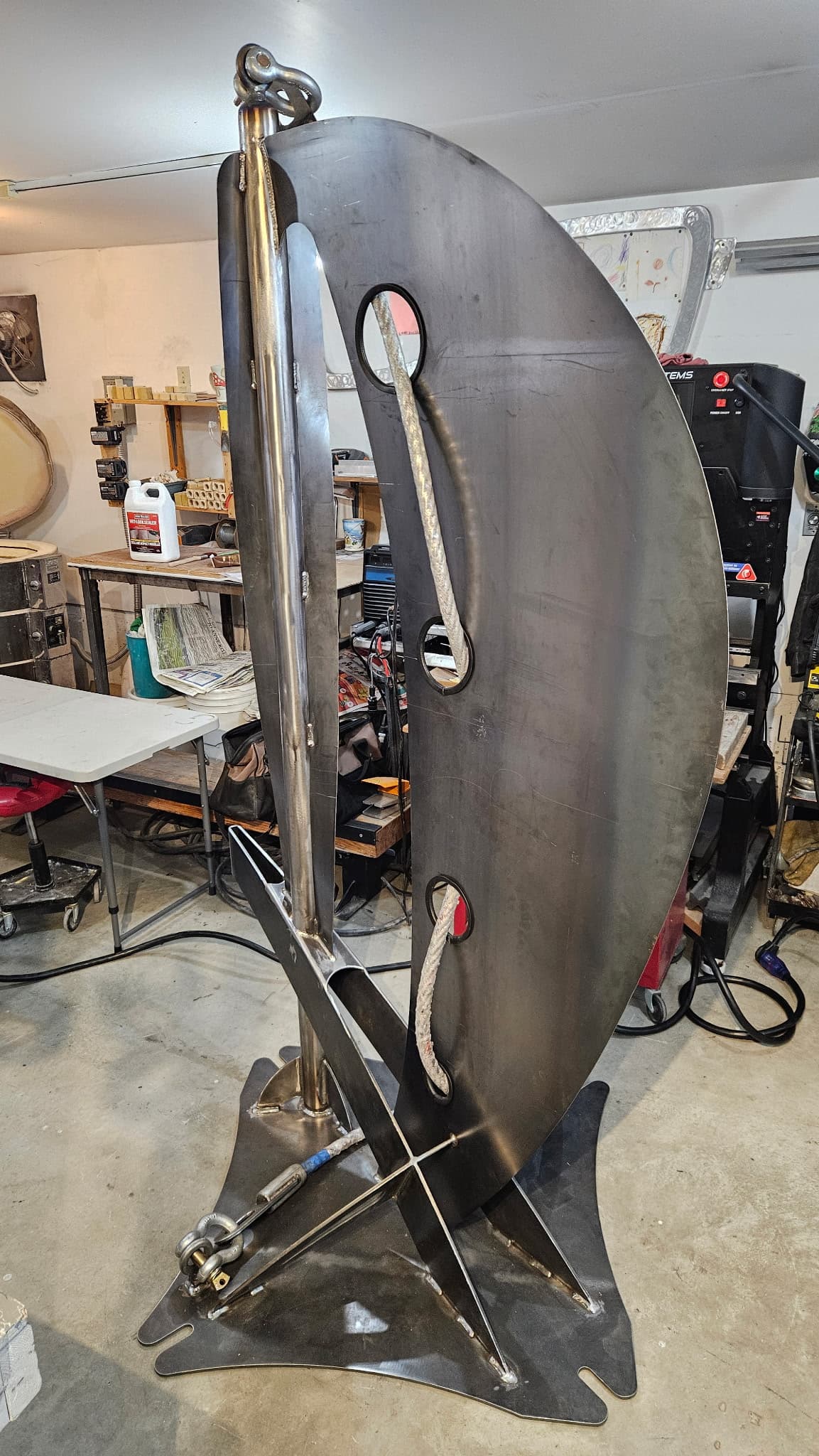

Sorry, I haven’t been following along day by day. How did you form these? Rolling mill, sheet roller, mallet/pillow? Stainless?
You ever watch Karl at Make It Custom -
https://youtu.be/n5GcwMgYmQY
The stainless that we ran through it was way over capacity for this machine but you got to do what you got to do.
Don’t be. I’m happy you have interest in the project. This topic will be here when you get the time.

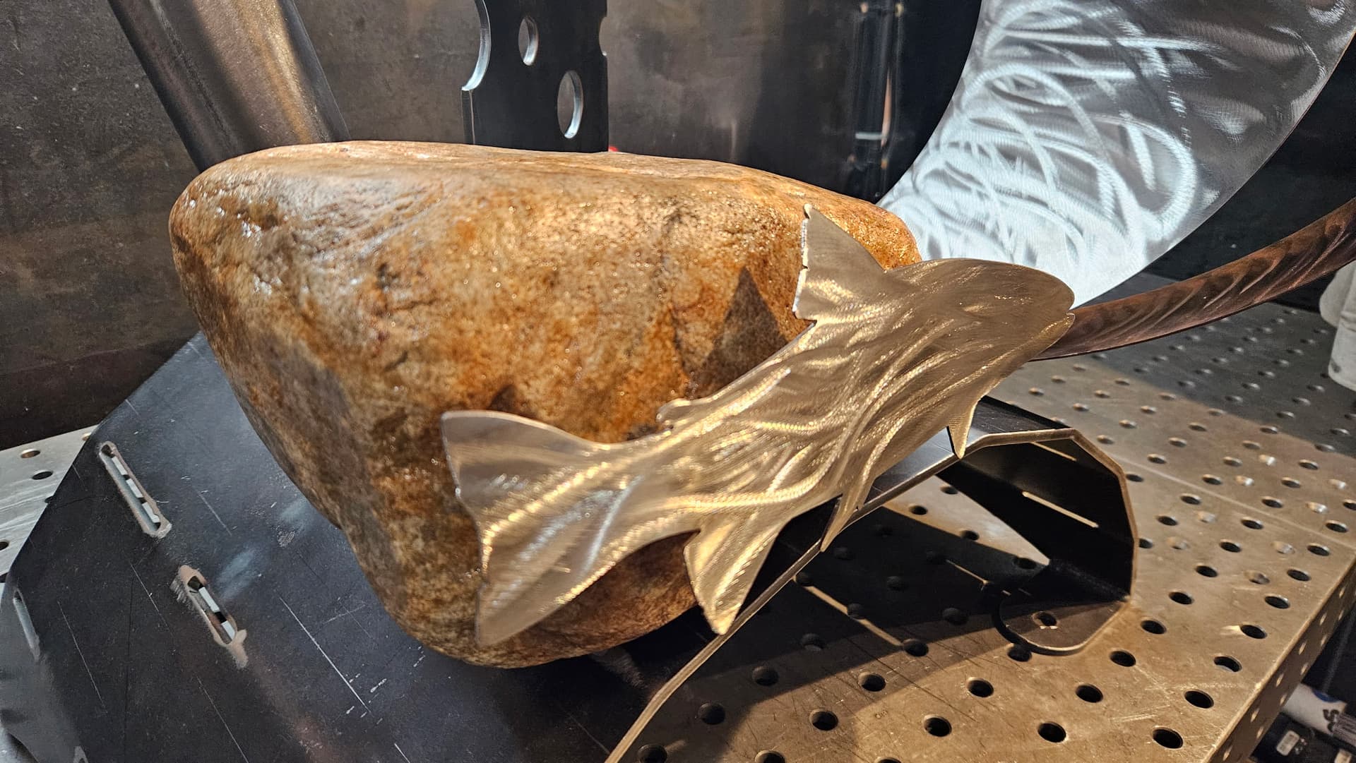

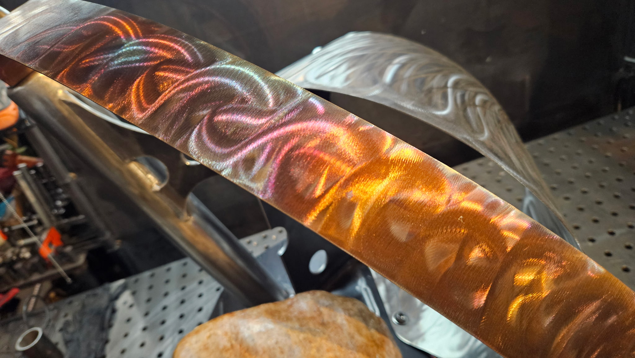

Yes. The two truncated cone sections and the fish are stainless steel. We plan on heat treating the thinner cone to turn it blue. This will be a public art piece so we made those truncated conical sections replaceable if they get damaged.
I haven’t, but from the few minutes I’ve watched of that link I better start.

I love this project, your creativity and carefully looking at every little detail. You can’t send enough photos for me. :grinning_face:

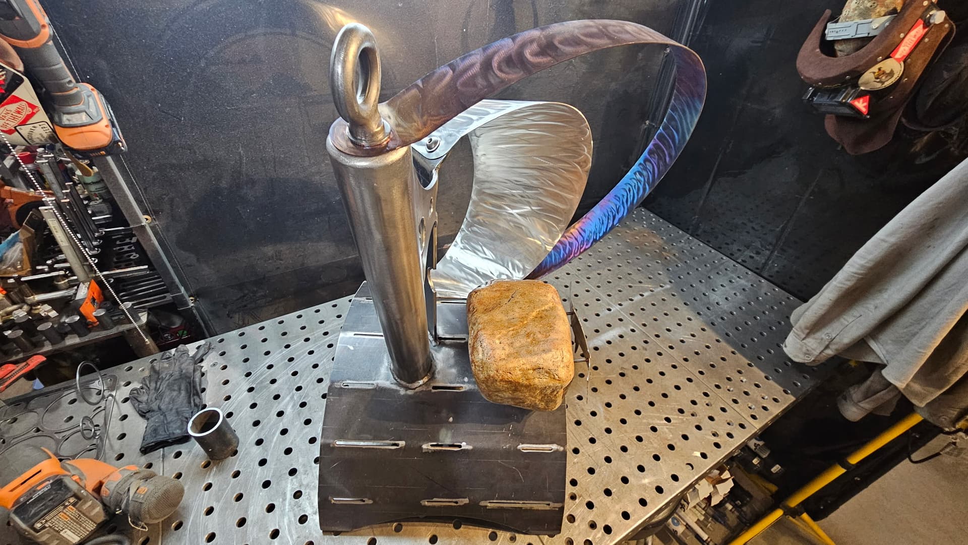

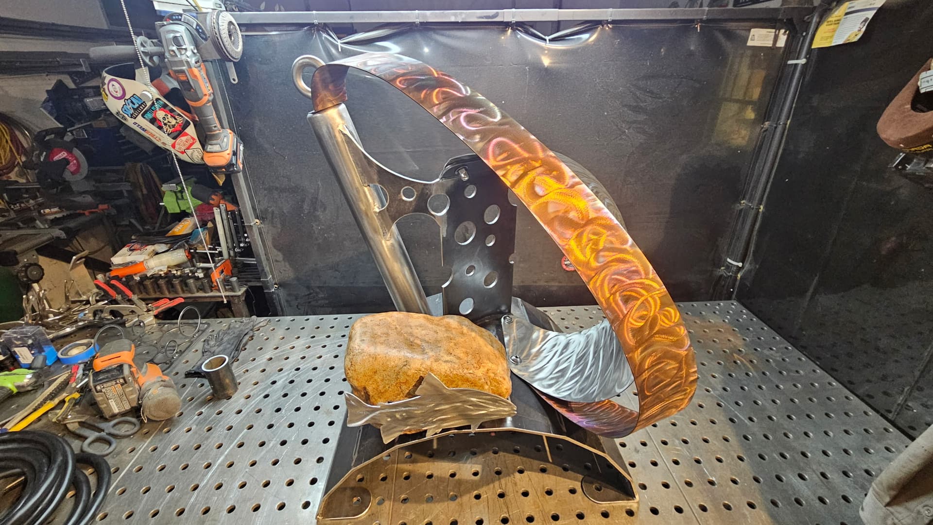

“Fortitude” and “Shapeshifter” just about ready for the texture black powder coat.
My business partner has been doing a hell of a nice job of assembly and post processing.
And you’re going to pop with that powder on it

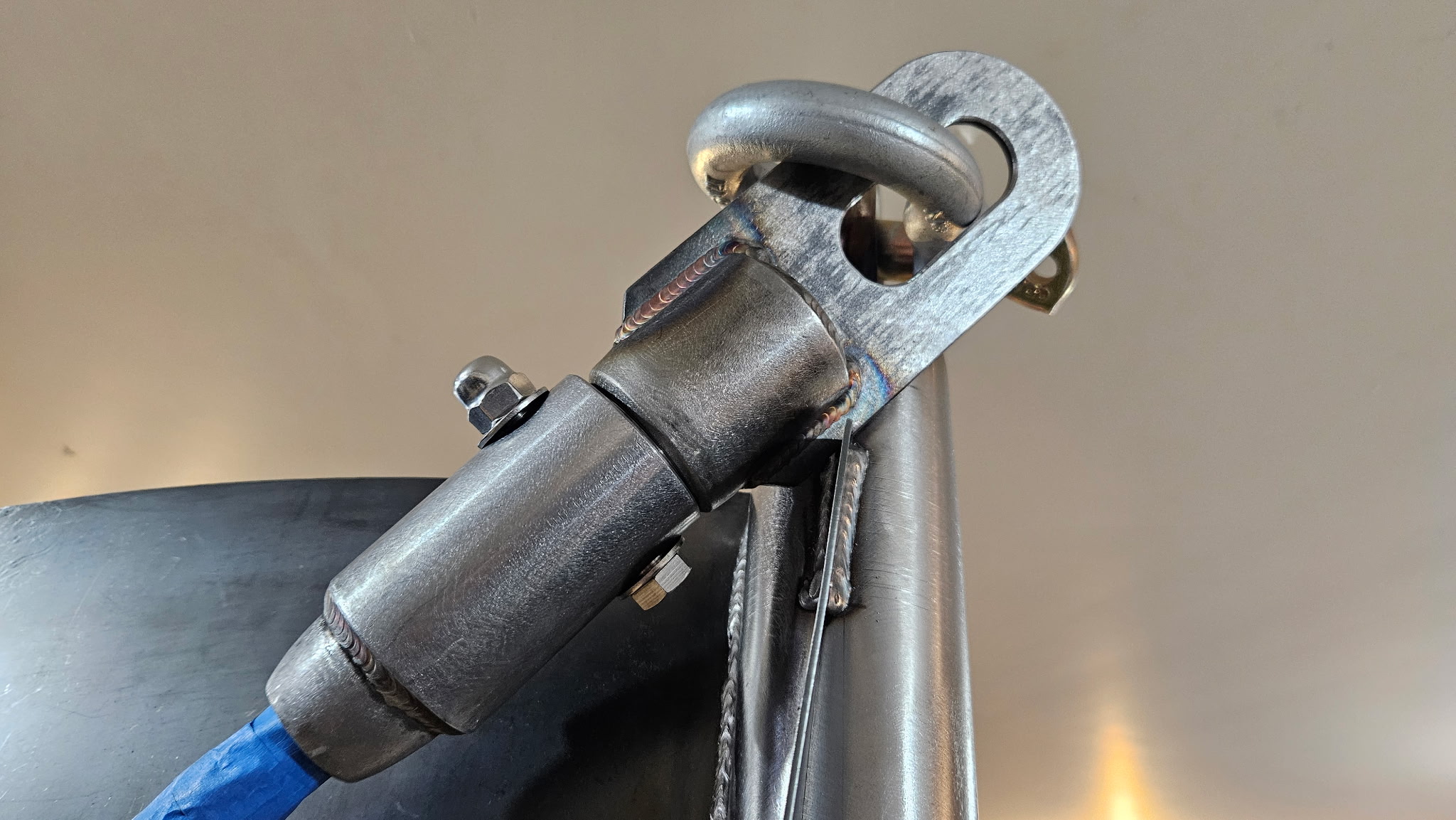

First I have to say thanks to all on this forum. Tin you have inspired me to try and do more than dinosaurs as yard art. This is great stuff. I do question weather you really have a business partner you never mention them by name, do they really exist are are they in your head :stuck_out_tongue_winking_eye: The details are top notch from the art itself to the lifting lugs.
