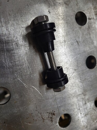

I 3-D printed these out of abs and they work really well. I’m gonna do one more revision, and then maybe see about a group buy for getting them machined out of aluminum or steel. I have only been able to get a few uses out of the printed ones before they are too worn out, which is fine but i want something stouter. My floor in my shop is really uneven, it was a granite shop before me so there are cuts and all sorts of stuff in the floor. I also don’t understand having modular tables, then epoxying them together where you can’t just quickly change them if you want.
I plan on getting rid of the o-rings, and adding a taper to the end, and adding a little space on the two alignment tapers so the outter tapers can pull together to really fine tune the alignment.
hell, it looks like primeweld already makes them.
Primeweld connectors
PrimeWeld has offered their bolt kit for as long as they’ve offered their tables.
A lot of us use them without issue.
