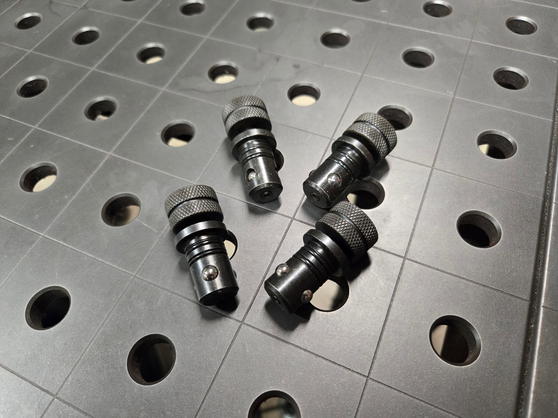

We’ll see if the ball lock pins work as they arrive tomorrow - the other vendor being Texas Metal Works. I bought 4 of them for some table extensions I made myself.

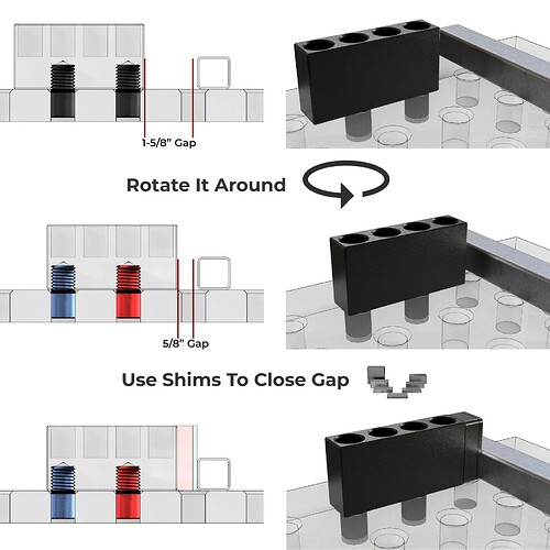

You’re probably referring to these sort of details, which I can agree with that Langmuir should have for sure.

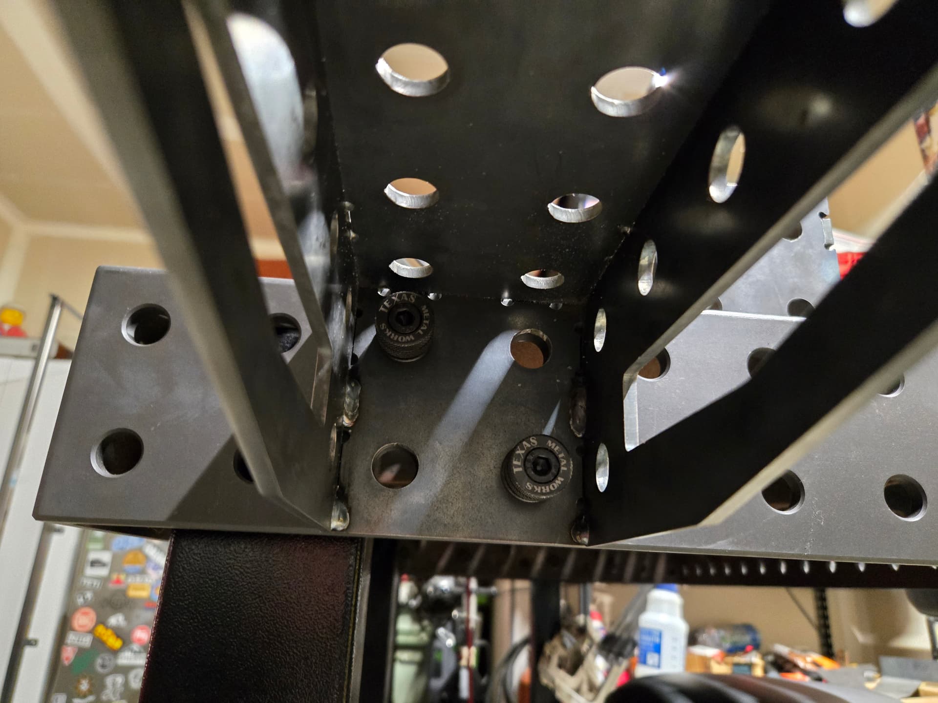

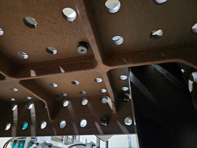

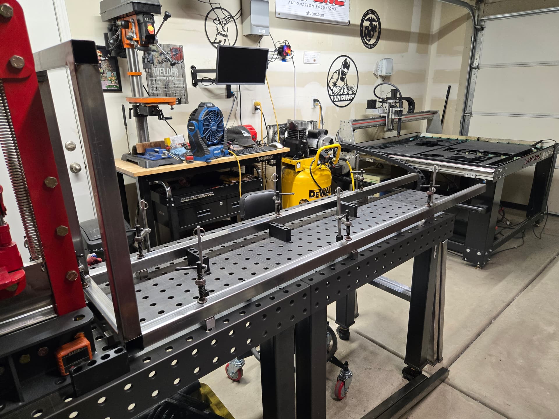

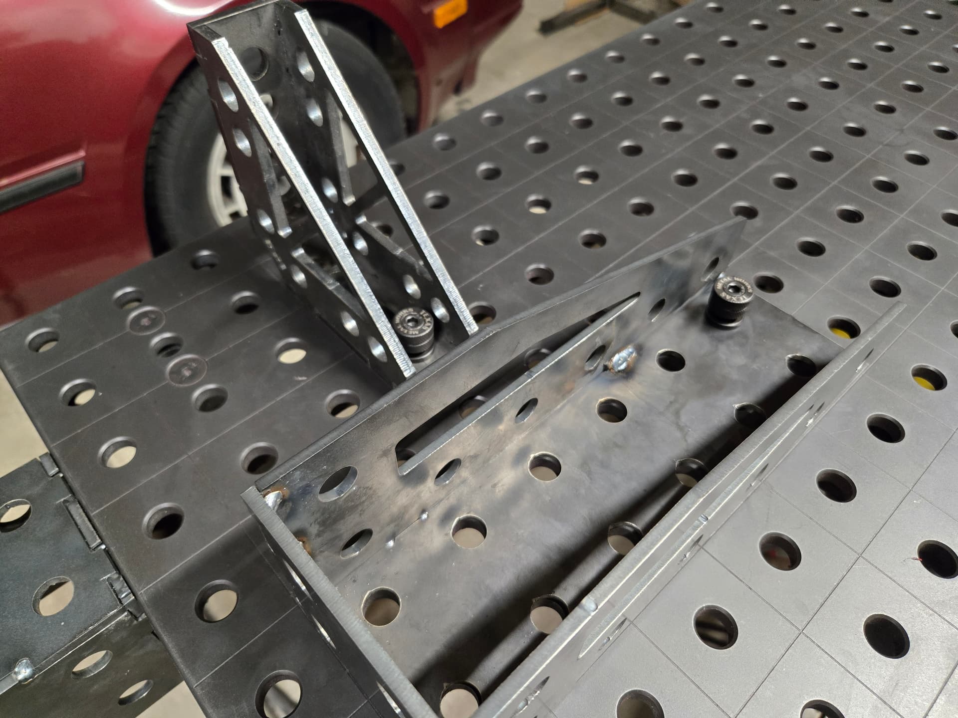

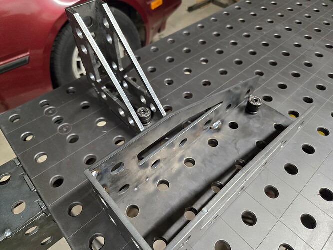

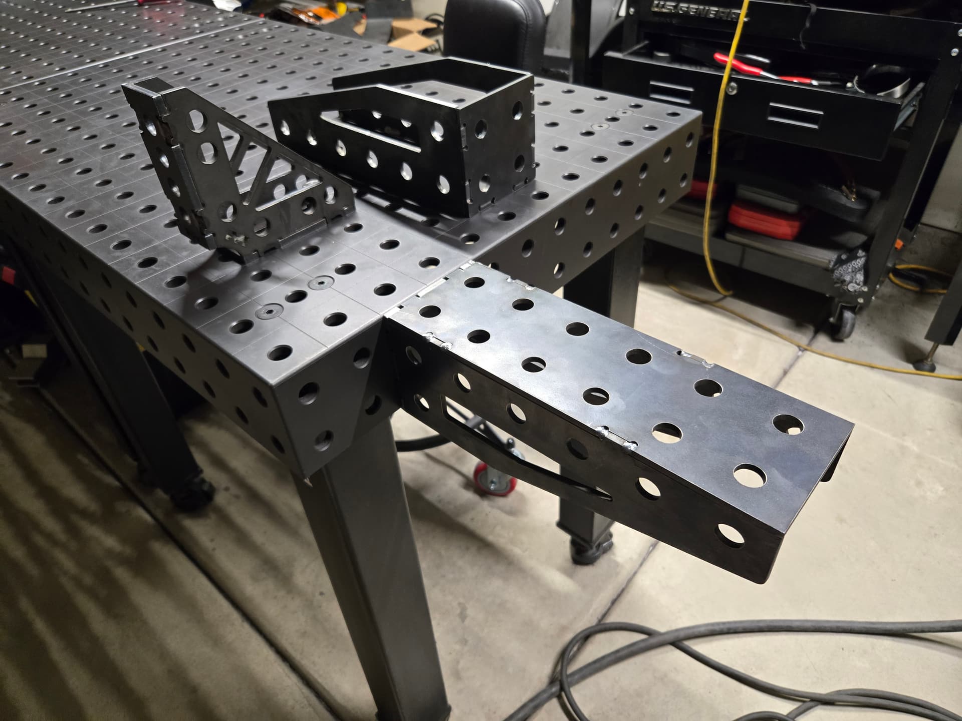

Small fixture is 1/4” thick while the table extensions are 3/16” thick.
I’ve got PrimeWeld fixture tables but they’re identical to Langmuir fixtures; both the 3/16” and 1/4” thick parts can be securely fastened by the TMW ball lock pins on both the top as well as the sides.

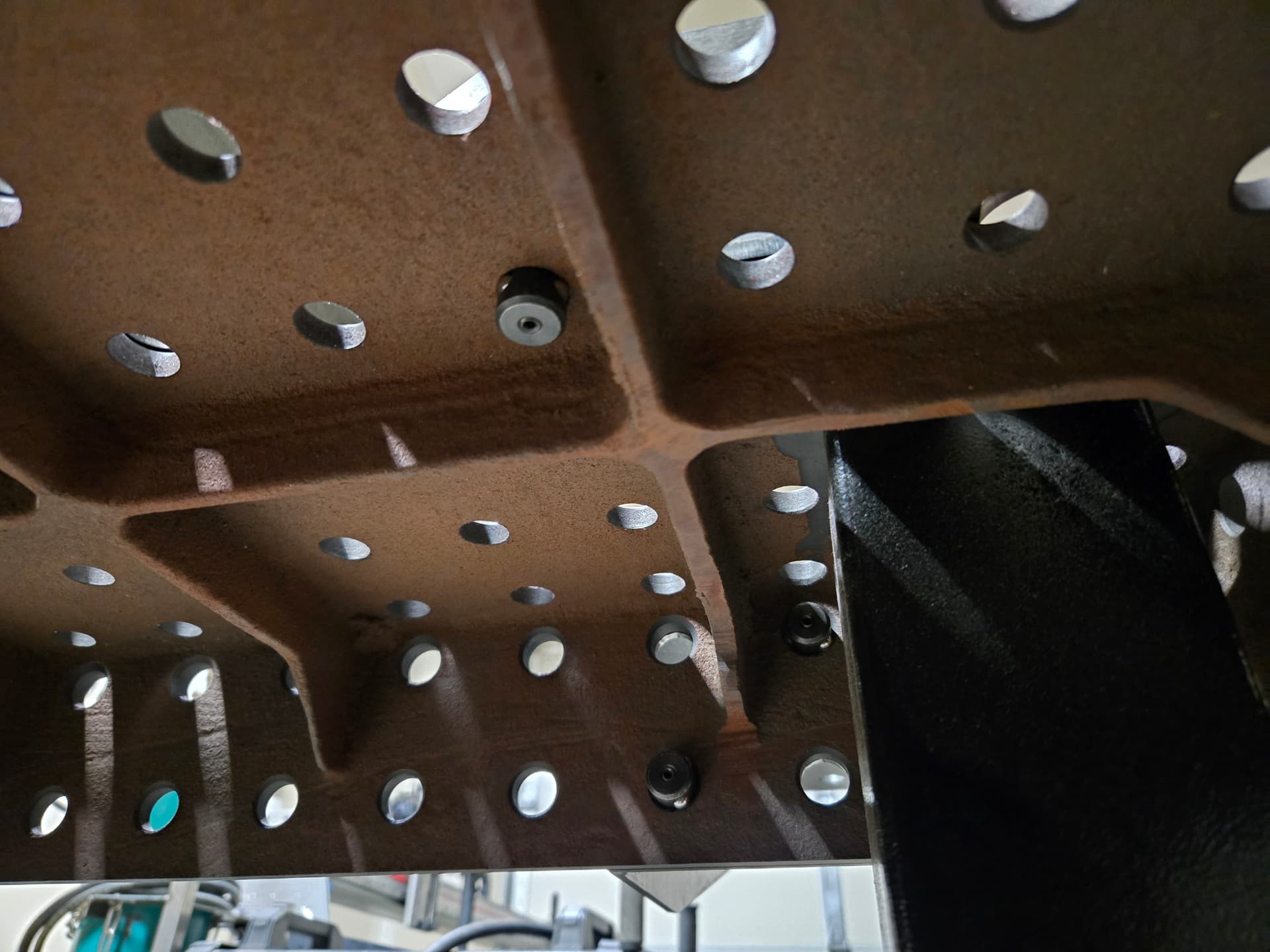

Although you can see how tight it gets with the 1/4” part being up on top.
Nice thing is, ball bearings are cheap and easy to replace in these ball lock pins as I assume they’ll get pretty messed up with constant use due to the rough cast iron finish underneath.
